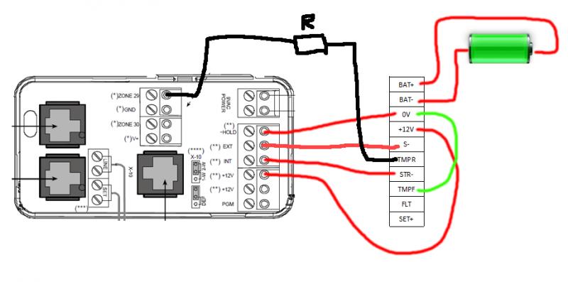

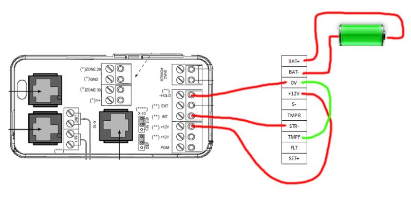

Hey ‘Alarm’,
Thanks so much for your help so far. Turns out the cat5 cable I was using for testing had a break in it, which didn’t help matters.
Anyway, so far it seems to work pretty well, I’ve got it wired as follows:
The NovaGard manual states that (TMPF – In standard mode [non NovActive] this terminal must always be linked to 0V), so that’s the green wire, I’m not really sure why this is the case, but I guess I should do this too?
I’ve also changed the PM+ settings so that INT is used for the strobe.
I see now how zone 29 will be used as the tamper on the box. As it seems to work right now, if you open the box, the tamper sounds the alarm, but now I need to tell the pm+ that the tamper has been activated and so set off the alarm there too. I’m assuming I run something from the TMPR out to the pm+ somewhere, but I’m not exactly sure what needs to go to what, and where the resistor needs to sit.
Also, what type should zone 29 be set to, interior? And I’ve got it down as CUSTOM1 for the name, can I edit that to read EXTERNAL SOUNDER, or is there a better way to do it?
PS, I don’t think I particularly want the strobe going off each time its armed either, save it for emergency’s, else people will likely ignore it I guess.
Ext needs to be connected to S-
That will then activate the sounder.
Use zone 29 or 30 programmed as custom as you say wire into TMPF and TMPR return programmed as 24hr audible.

Good afternoon.
Sorry for the delayed reply but ive been snowed under lately.
I finally had a chance to test it all out and its almost there.
I have the tamper on zone 29 and that seems to work perfectly
The only problem i have now, is that when i disarm the system, the external sounder goes off for one second. With the S- -> EXT not connected this doesnt happen, but then when the alarm is activated from the control panel the external sound does not sound, so thats no good.
Any ideas why this might happen and how i can stop it please?
This is the current, almost working setup:

Your not using a return leg to the zone. So it sees a tamper!
Follow the diagram on page 6 top right. Zone without tamper.
I know the terminology is strange but you must see from your latest diagram you have not completed the circuit.
Its very odd, if i arm/disarm via the keypad, everything if fine, how ever if i disarm using the remote, thats when the external sounder sounds for 1 second. when i arm and when i disarm, which leads me to think its a pm+ config issue, although i have no idea what exactly?
I have tried your suggestion, although the same happens. also if i replace the resistor between z29 and GND (effectively disabling tamper) the exact same thing happens?
Turn off, siren when set.
Sorry if this sounds silly, but where is that option please? Im assuming its in the pm+ somewhere, but i cant for the life of me find it? as its only happening with the remotes, ive also looked in the keyfob section, but cant seem to find anything?
Thanks ever so much for your help btw. Hopefully i wont have to annoy my neighbours much longer with the sound of the alarm going off. :)
Got it, its called the SQUAWK option on the PM+, disabling this stopped the annoying noise!
Thanks for your help with this.
