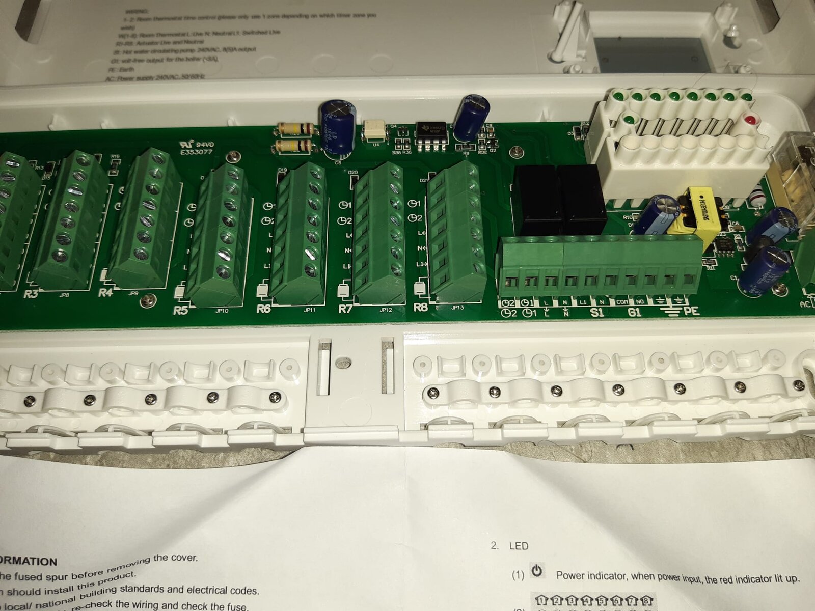

I bought this wiring center on line for my 8 port under floor heating system. I had hope to see a designated wiring block for the boiler, pump and the zone valve. but this one do not and i am rather confused. based on the wiring sheet that came with it, see pic
can someone help please
1- where the boiler wires go?
2- where the pump wires go?
3- where the 5 wires of the zone valve go?
4- do I need to link timer 1&2 everywhere in the Wiring center, i.e the main board and the individual zones?

It tells you G1 is the volt free contacts for the boiler, and likely one pump is switched on with the boiler.

The first thing is floors take a long time to heat and cool, so great for an old peoples home where it wants heating 24/7, but for anyone who either wants it cooler at night, or goes out to work, the slow reaction time is a problem, I fitted an electric version in a wet room, and heat up time of floor was two hours, and to get room warm with a maximum floor temperature of 27°C your looking at setting the floor as back ground heating, radiators do main heating if your not running it 24/7.
But it is reasonably easy to work out, how any heating works, the thermostat opens a valve, and the valve opening turns on boiler, but you need some one way valve so when boiler turns on with one valve opening it does not back feed and cause all the areas to heat together, so a standard two port valve has a micro switch built in to do this.
So thermostat feeds brown and blue on the motorised valve, and the white and orange runs the boiler and main pump.
However you also with most systems need a pump for each UFH set of pipe work, and there is only one micro switch in the two port valve, so we have a relay box which turns one set of micro switch contacts into two sets. One set runs local pump, other set runs main pump and boiler.
So this
bit runs boiler and main pump. And this
bit runs the second pump and connects to thermostats and valves.
So this
goes to the thermostat, line out to thermostat, neutral to thermostat and line in from thermostat. I would guess
has a link in it, as in the main today we use programmable thermostats rather than independent thermostat and timer.
This
and this
