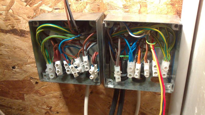

what wiring center for UFH and Hive?
7 Feb 2017
24
still struggling to get my head round this and buy the right thing before the electrician and plumber arrive next week .
I'm supposed to be supplying everything except wire .
Ive got wet UFH with 3 zones in 1 large room (radiators and hw cylinder upstairs)
S-plan
3 actuators
3 zone valves
2 pumps
Hive active kit and hive multi zone
at the moment i have no wiring center . Do I need one with what i already have ?
If so what one ? does it need to be wireless also ?
Probably a dumb question but if anyone can help would be appreciated .

Yes, except it doesn't have to include the fancy bit -
For wet underfloor applications I prefer to use something like the Heatmiser UH jobbies.
It has all the terminals you need for zone thermostats, external pump(s), options for hot water timers etc.

I had a look at
Heatmiser UH4 seems like it would do the job as i have only 3 zones (3 actuators in one zone rads and hw)
but it does not support wireless thermostats .

so what your saying is it doesn't have to be wireless for what i need ?
because the hive kit and multizone will support the hive wireless thermostats? and uh4 can just serve as some expensive chocolate blocks .

Wireless is useful as it saves having to run a cable to the thermostat position spoiling the decorating.
If you already have a wired thermostat and you are happy with its location then there is no point having a wireless one.
we don't have any thermostats . we used to have radiators and thermostatic valves downstairs until i removed the wall they were on for open plan and fitted ufh .
So as it is with the hive kit if i got a uh4 , all i would need is a wire from uh4 by the manifold, to the boiler controls next to the boiler which would be replaced with the hive hub?
then just put the 2 wireless thermostats up .

that's what i was looking at and the reason for asking .
works with heatmiser wireless thermostats etc...
Hive don't have a similar one so i thought i needed a wireless one like that ,I didn't know what one would be suitable.
Ill just get the UH4 and try that .
but thanks for clearing that up about the wires in a junction box .
you can find out about a wireless junction box at the above link :)

The wiring centre does have a bit more going on than just a bunch of junction blocks, in that different zones can activate the manifold pump without causing cross activation of other zone valve/actuators.. But it's not exactly rocket surgery inside the box
