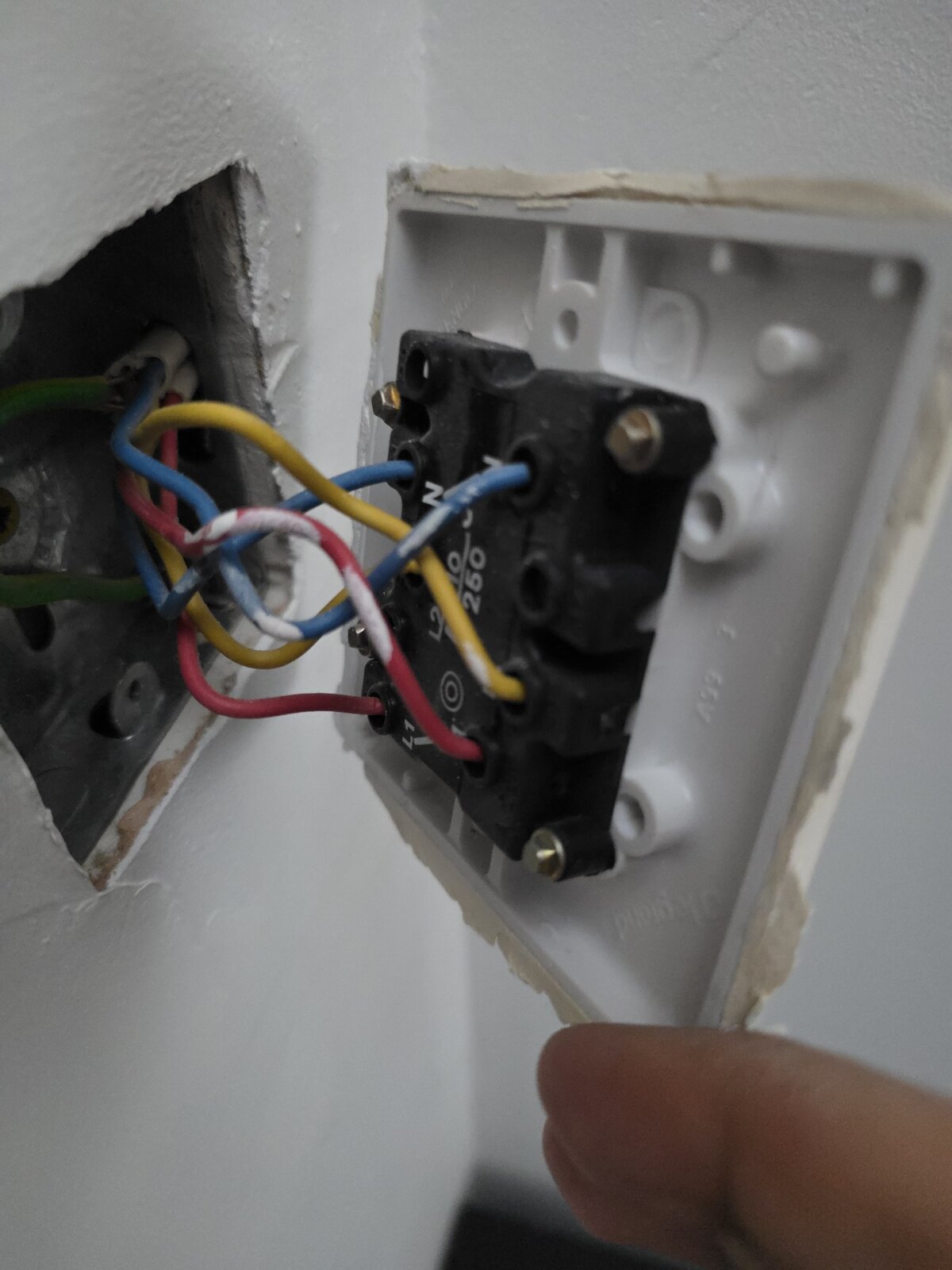

Morning all,
The light switch was standard 3 core, with neutral being switched live. When I opened up the fan Isolator I saw the attached, so I'm assuming the 4 core cable comes from here. I will also open the fan as I didn't have time this morning.
Thank you again for your help.

The light switch was standard 3 core, with [the black wire] being switched live.
So where is the other end of that cable now?
I think I can identify it in the very first photo. Is it one of the cables in your new junction box, or not?
Note there is no guarantee that the wires in the fan isolator actually have the roles marked on the switch.

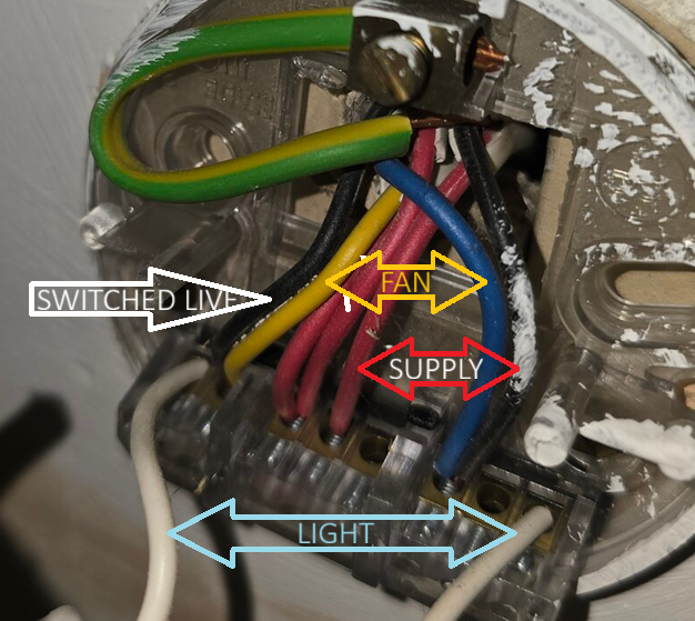

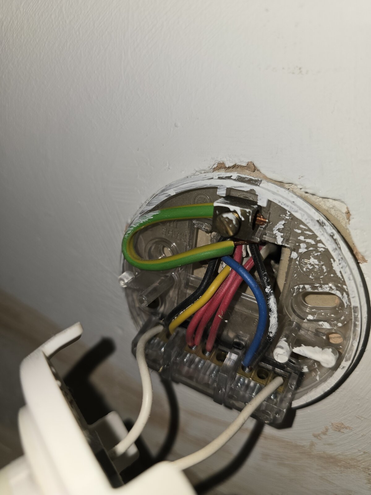

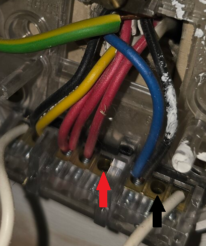

Hi,
I'm looking to replace the ceiling rose below with a new light and a little confused by the wiring.
So going right back to your original post, is this picture just as you found it before you did any work?
I have worked out conductors belong to the ring main and disconnected those from the ceiling rose and reconnected them and the other lights on this circuit all work fine.

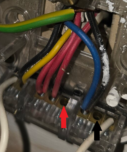

More information please, may we assume there were 2 red wires and 2 black wires in the empty terminals arrowed which are now in a junction box?
The 4 colours on this other cable are Red, Yellow, Blue and unsleeved Earth. My new light fitting has L, N, E terminals. This circuit also has an extractor fan that comes on with the wall switch. I have bought a J804 Hager 4 way Junction Box to make this a bit easier, so I can run a conductor from the junction box to the new light, once I have the 4 cable figured out.
Thanks in advance!

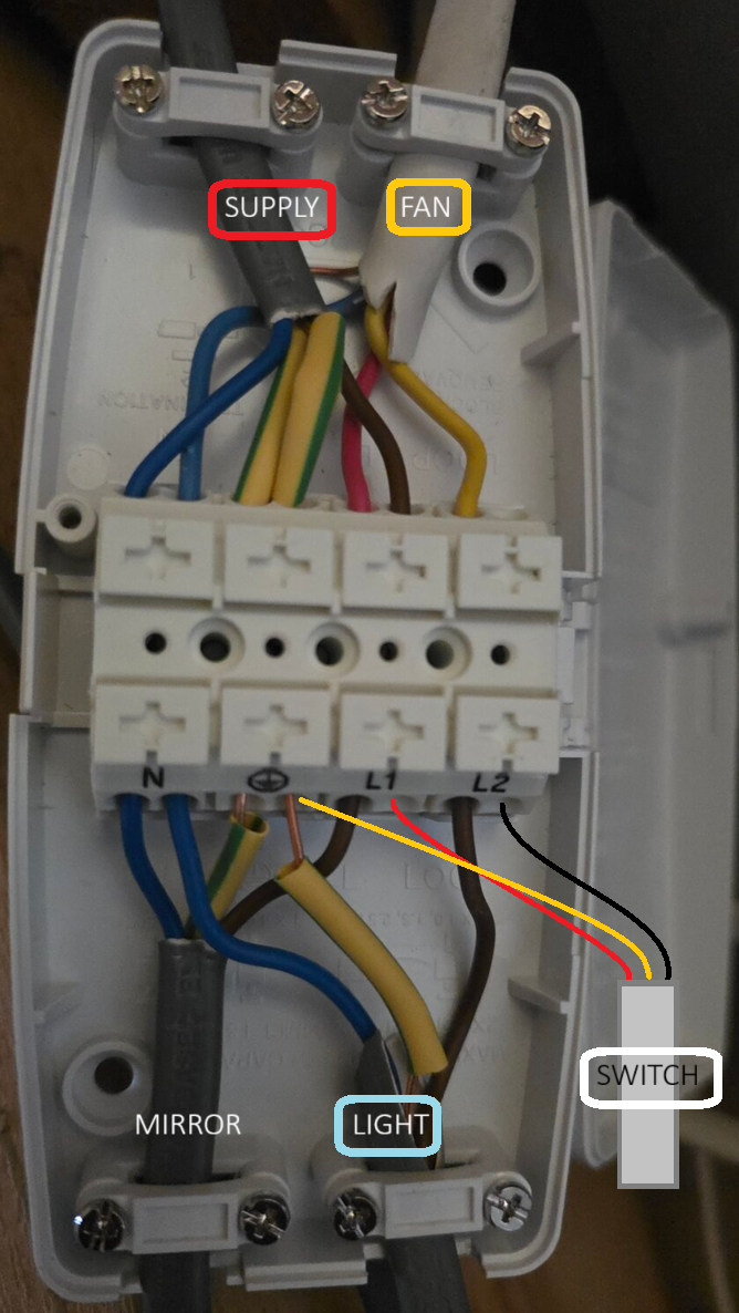

In you new junction box you quote
Going clockwise
Top left Grey - spur from lighting ring main acting as supply
Top right white - Assumed to be switched cable, neutral, live and earth connected to corresponding blocks. Yellow assumed to be switched live, connected to loop terminal on JB
Which you now know is the fan cable
Bottom right grey - load going to new ceiling rose, with live wired into switched live terminal above
Bottom left grey - load going to illuminated mirror. Not switched.
More information please, may we assume there were 2 red wires and 2 black wires in the empty terminals arrowed which are now in a junction box?View attachment 400062

The ceiling rose was completely untouched, those terminal blocks were completely vacant when I exposed it to take the photo.
I will put it all back together tomorrow morning as it was, so we can start again. No wires have changed colours, but I have added new cables as the new light fitting doesn't have a ceiling rose and I also want to fit an illuminated mirror, fed from the ring main. But I appreciate this isn't helping, so let's go back to the very beginning and build up slowly.
(This post assumes the pic is how you found things before making any changes)
If the new light's central rose would fit over the old clear plastic thing you have there the simplest thing to do is leave all the connections alone, undo the two white wires, put the new light in where they were and fit the new light rose over the old clear plastic junction holder
If it won't fit, the simplest thing to do is buy a box of 4 way wago/ideal connectors, take all the wires out of only one brass block at a time (do not take all wires out of all brass blocks; do one block at a time) and connect them into a wago/ideal, one wire per hole. Tuck the connectors inside the new light rose. I mention 4 way because you say you want to add something else, and so far you have 3 wires in each block. To add something else go one more way of connector than you have wires when buying a pack. eBay sellers sell eg a pack of 10 four way ideal connectors for less than a fiver
You mention adding a mirror; if you want the mirror to be powered all the time regardless if the bathroom light is on or off, connect it to the wago holding the red/brown wires and the black/blue wires
If you want the mirror to follow the light switching and the bathroom light switch turns the mirror off too, wire it into the same wagos as the light uses (black/blue and black/yellow)
The presence of the paint splotches on the black wire on the right of the picture will help identify what to put back where if you've already ripped this all apart. Thankfully it's only the two black wires that can potentially be the wrong way round so if you've wiped the paint off and can no longer tell, connect it all up and it has a 50/50 chance of working If it doesn't work correctly, swap the two black wires over
Ok, so I put it all back together as it was originally using wago connectors and whilst there isn't a light attached, I flicked the switch and the fan came on as expected.
Now my next question is, how do I add 2 extra cables to power my new ceiling light (switched) and illuminated mirror (unswitched). If you can advise me against my original photo, that would be perfect because I can then replicate that in my junction boxes.
