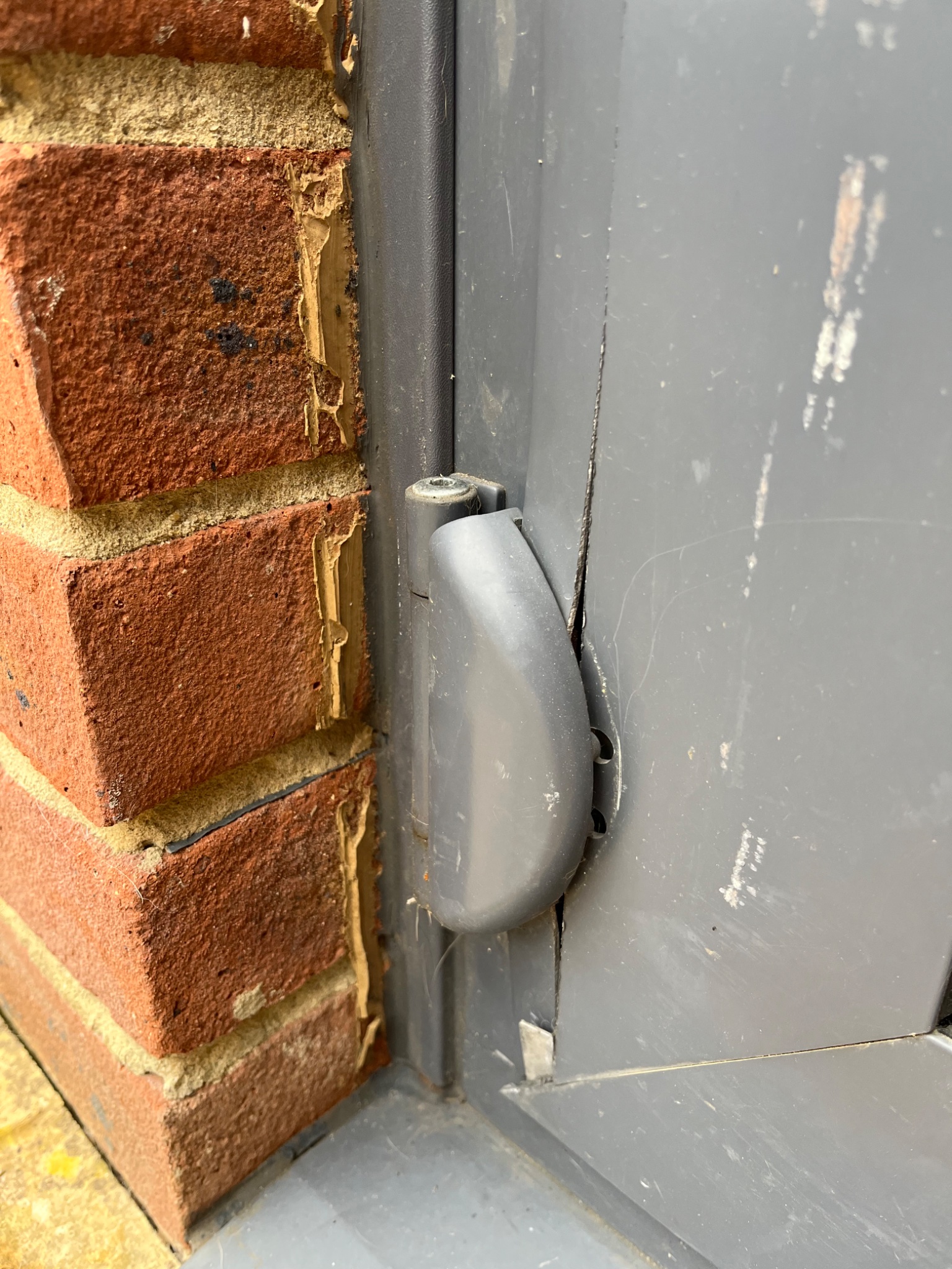

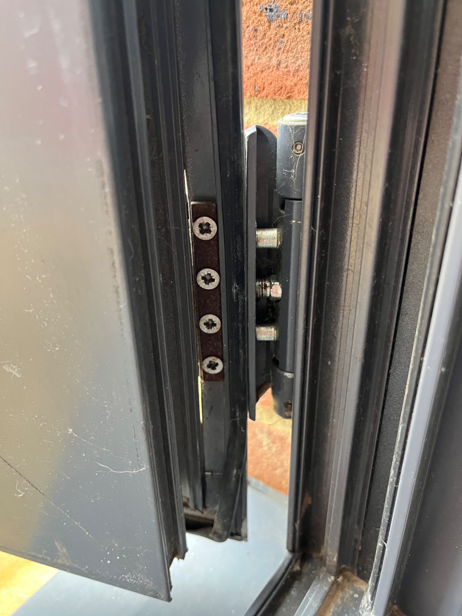

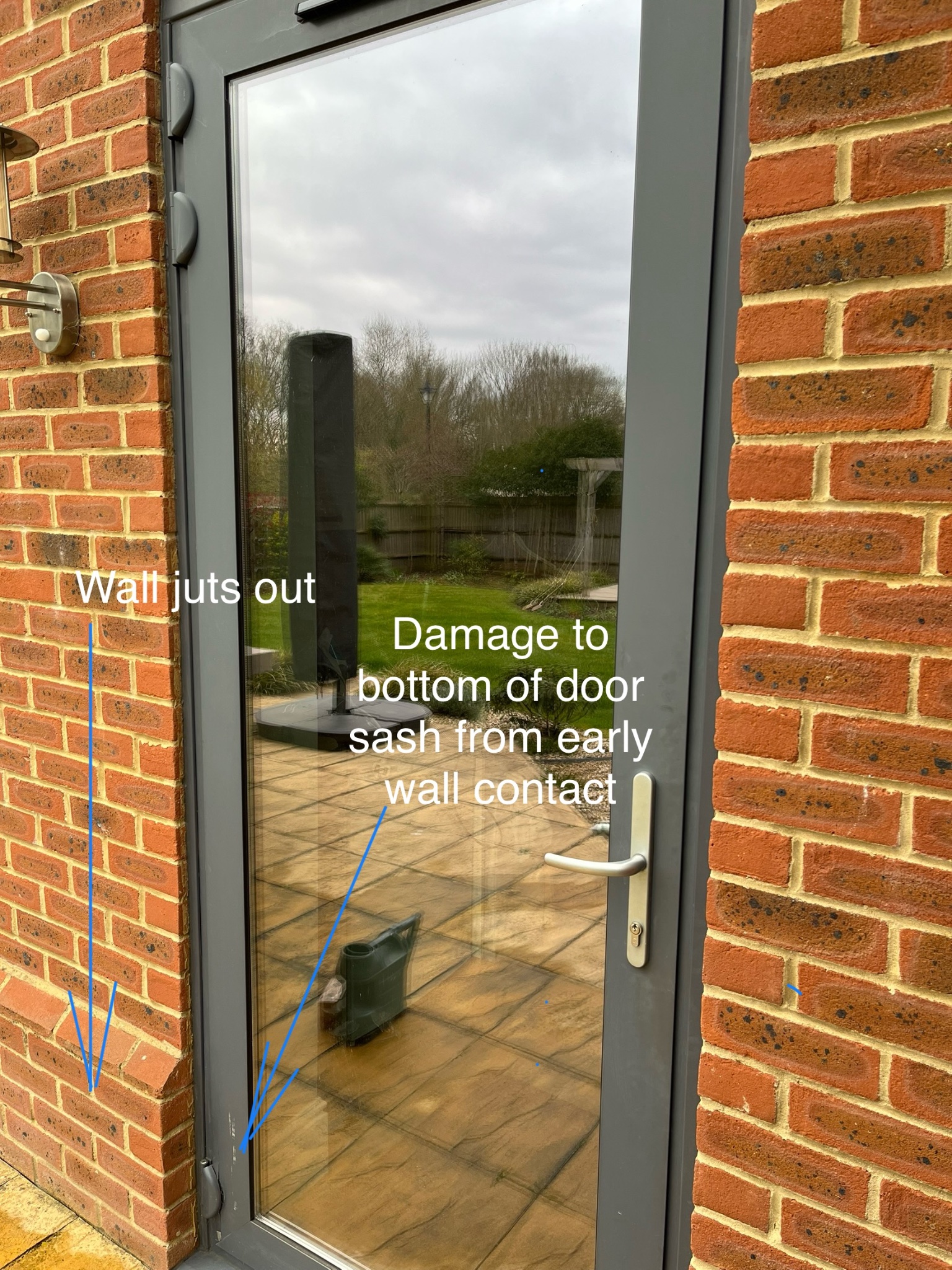

Hi, as can be seen from first pic, the jutting portion of the wall has damaged the bottom of this door when opened too far repeatedly (previous owners!). Any idea of how to fix? I was thinking of removing the door, trying to super glue the sash to as close to original as possible, and installing an additional hinge above the lowest one, where the sash is undamaged. I can’t find a hinge exactly like these and also can’t locate any indication of the door manufacturer on it (or on the frame).
I’ve already bolted a homemade door stop into a paving slab so that the door cannot be damaged further or again once fixed.
Cheers.
Hinge is the easy part...
SFS Dynamic 2D-A Aluminium Residential Door Hinge https://share.google/BZnNMC4j6qZzf0wPw
The repair to the aluminium is a bit trickier, I would remove the hinge, bash the crack so it's below flush and do a car body type repair, filler and spray, I perhaps wouldn't trust the area not to crack again IF you mounted the hinge back on so moving it upwards is a decent shout, cosmetically it'll look fine
Ideally outward opening doors should always have restrictors on for this exact reason
VERSA Slimline Concealed Door and Window Restrictor 460mm -Lockstation https://share.google/vjXW0jHgEY9qpFJE9

Thank so much. I’ve ordered a hinge. Although I’m a reasonably competent DIYer, given that the sash will probably weigh 80+ kg, I’ll have to hire a tradesman to do this. Cheers.
