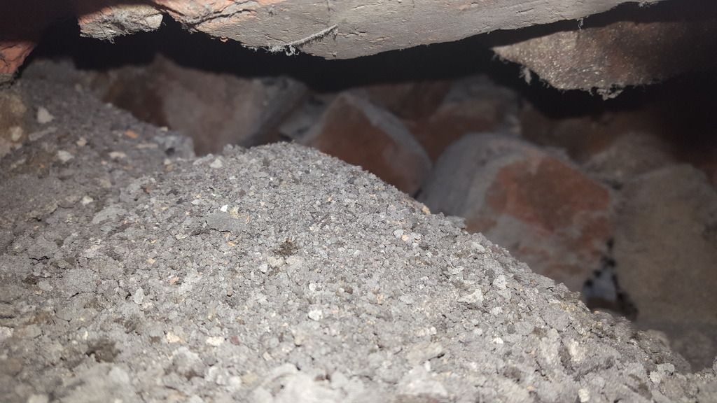

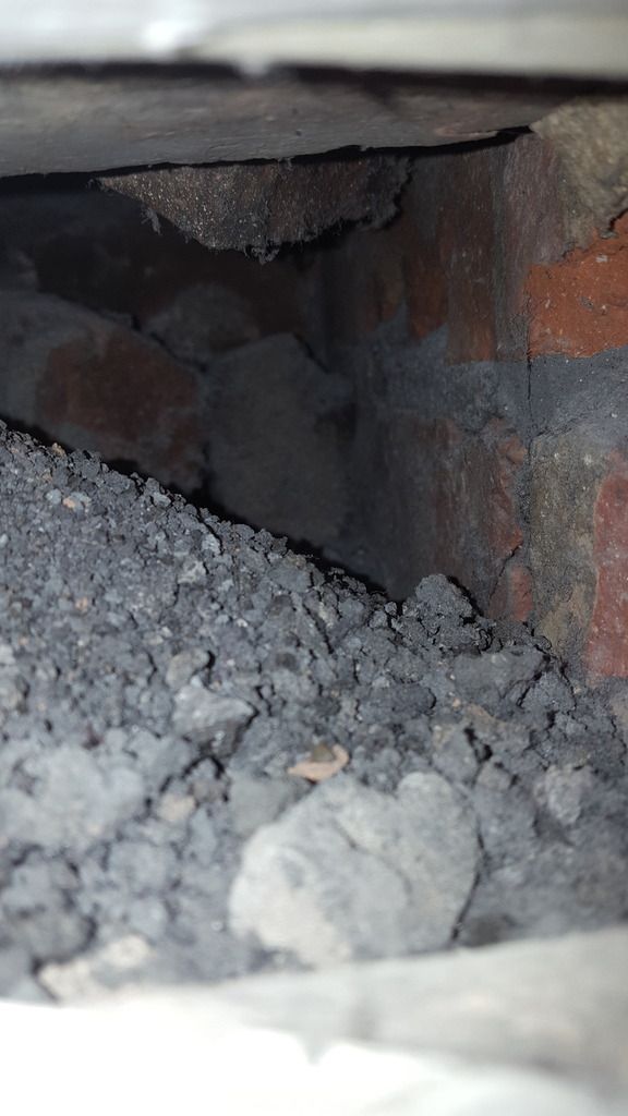

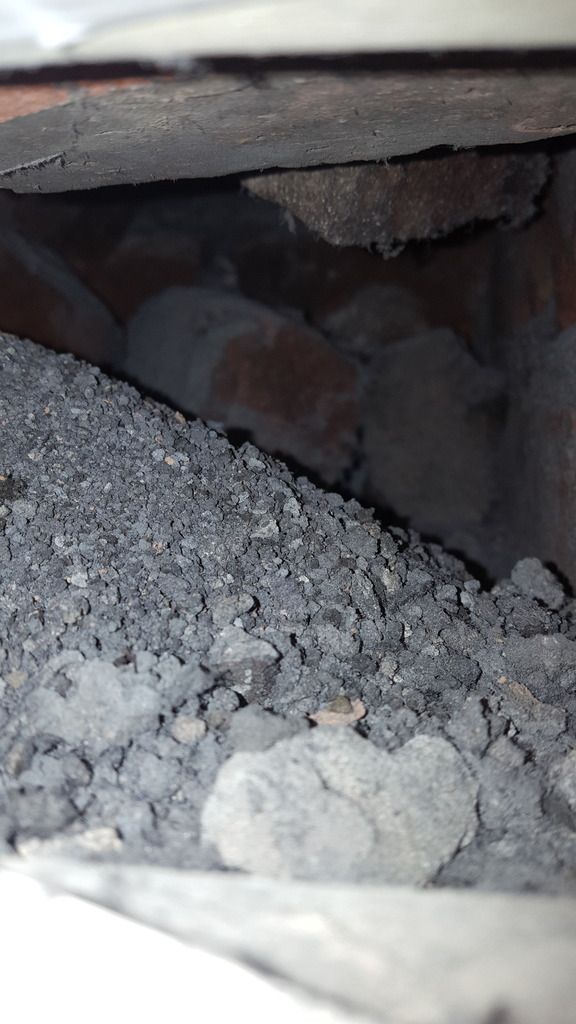

they are at either side of my chimney breast, I have a vent in the chimney in my bedroom which has a vent cover on. I have taken this off and looked through it and there seems to be lots of loose bricks inside piled up would this cause the problem?

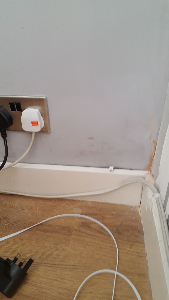

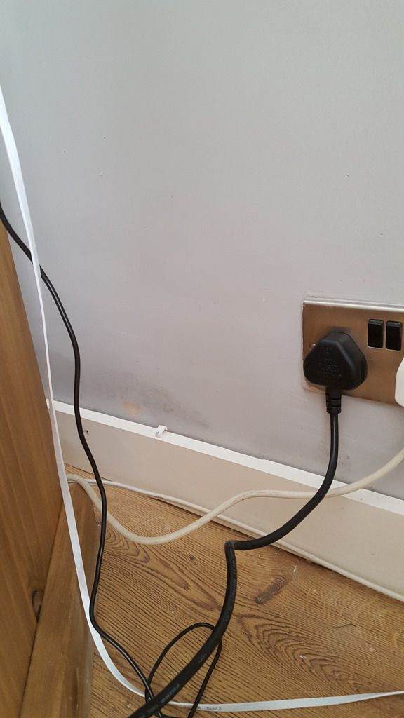

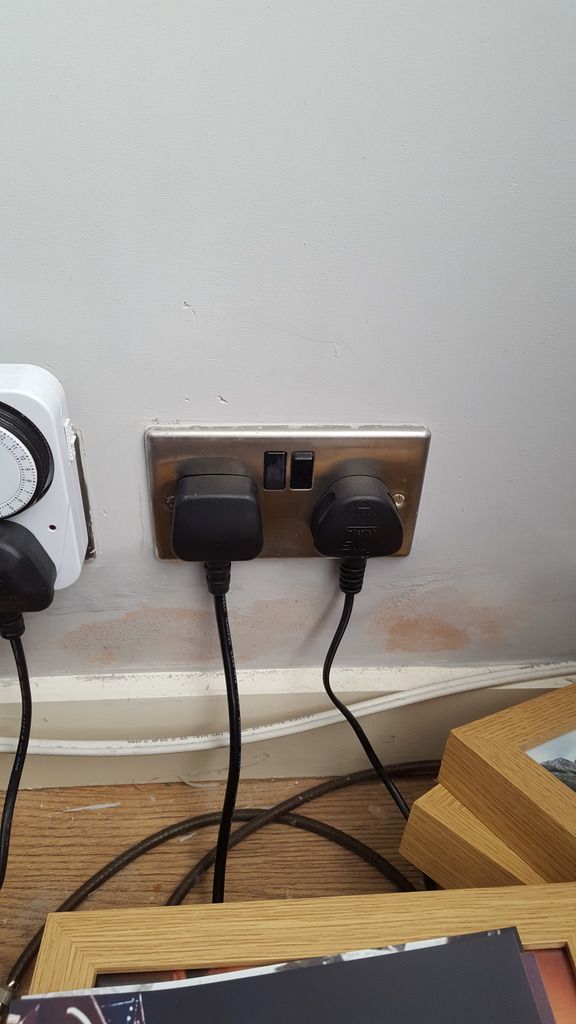

the patches wont go higher than 5 inches high.

Is this on the ground floor. Chimneys don't tend to have a dpc, but with all that rubble there, it could be pulling moisture up from the ground, but do the marks appear after it's been raining, as the soot in the chimney can leach moisture across the brickwork to the plaster.

As you can see the marks don't come up very far would I have to remove the laminate floor to see what's underneath?
You'll need to hack the plaster off, Inject a chemical dpc (for good measure) apply a cement render (using washed sand) with a waterproof render in it, and then replaster. Or you could look on the safeguard website for a quicker, albeit more expensive, solution.
