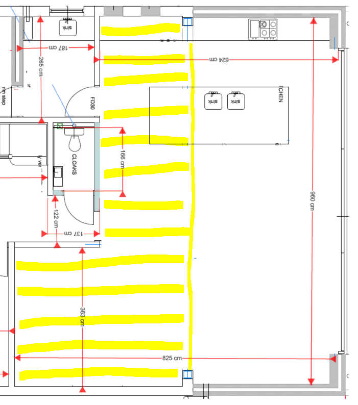

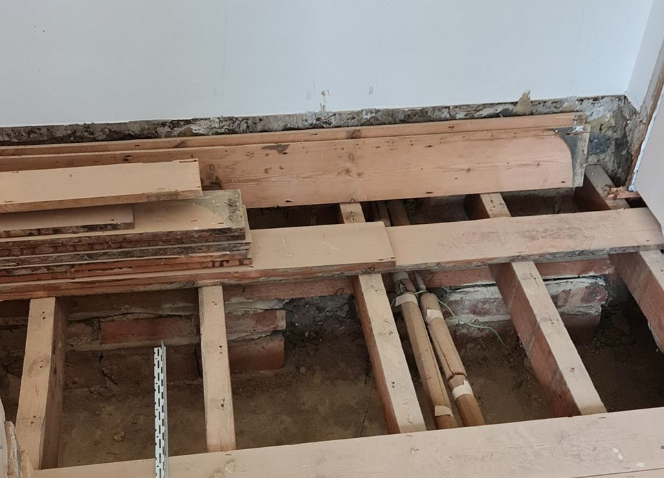

Hi i have an existing suspended timber floor to 2 rooms that are being opened up into a new extension (as below). The existing timbers are 4x2 sat on sleeper walls at each end and are decent but slightly twisted after 100 years. They have a 300mm ventilation void between the ground and the underside of the joist.
The extension is being constructed with a suspended timber floor which the SE has spec'd in 8x2's @ 400c. At the same levels this gives a 200mm ventilation void which I understand is in line with BC requirements.
I need to remove 40% of the joists to install a pad foundation for teh steel columns so is it best to bite the bullet and just remove the existing joists and sleeper walls and rebuild it all in 8x2's breaking the spans into 2 4m areas as below? If so are sleeper walls the best method or wall plates and hangers with a sleeper in the middle?
Thanks in advance for the help.
I honestly think that if your original joists are twisted you'd be better off lifting them out and replacing the lot with new joists onto a properly constructed central sleeper wall.

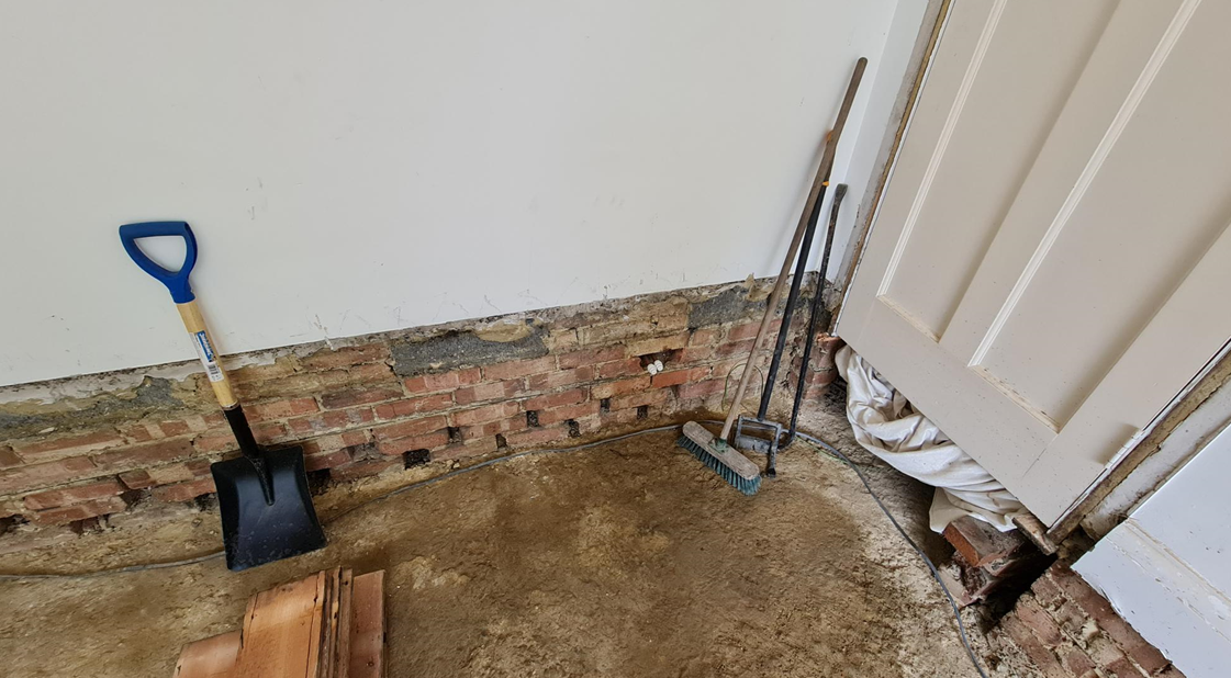

If your walls are good enough and you have no dry rot I think the easiest approach might be a ledger (wall plate) bolted or resin anchored onto the masonry at each side with standard twist nailed joist hangers. These can be set out and nailed in place on the bench before passing them down into position. They need to be treated timber as they are in contact with walls near to ground level and/or external walls. You might also consider inserting a layer of DPM between the back of the ledger and the wall and you will need a layer of DPM between the top of the sleeperveall and the timbers. Where the joists meet in the middle you should nail the joist ends together (side to side) as well as blocking (solid strutting) between the joists. This will stiffen the floor.
Attempting to install zip hangers (i.e. the sort that fix directly into the mortar joints) into an existing old wall can be an exercise in frustration and futility as they will rarely line up.

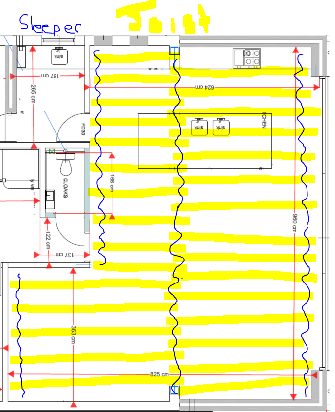

Thanks. So if i am reading your response correctly you are suggesting what i was thinking of doing;
# Remove all existing
# Build sleeper wall along the existing rear external wall of the house
# Install a wall plate to the inner wall of the house
# Install a wall plate to the new rear wall of the extension
# Install joists between wall plate in hangers and sleeper wall nailed to sleeper wall head plate
# DPM to all areas joining ground via masonry
# Brace between joists
The max span if constructed this way will be just over 4m so it should give a solid bounce free floor structure?
The rear wall of the extension will be constructed out of 7n concrete blocks so that will be fine to fix a wall plate to. How do i establish if the existing brickwork is sufficiently sound to fix the internal wall plate to?
This is the wall where the ledger board would be attached to carry the joists. From teh looks of it is there anything that would suggest it is not suitable to bolt the board to?
When fixing a ledger board do you dry pack between the board and the brickwork to take out any minor bumps etc?

Yes, they are suitable. Resin anchors are ideal if the walls are of variable quality masonry. If the masonry is good you could use Rawlbolts (shield anchors) instead, which are cheaper. Centres should be 600 to 800mm. I normally wouldn't use screws (even 6.0mm) other than as a temp fix whilst you get the resin in and it goes off
