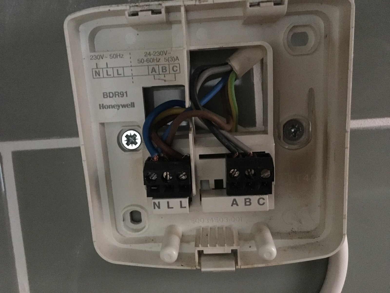

Hiya.
New to the forum and I need I bit of help. I’ve bought a hive heating kit to install on an ideal logic combi boiler. There is a Honeywell wireless receiver next to the boiler that will be replaced by the hive. When I looked at the wiring the boiler is supplied from a wall socket via the receiver. The reviver has a terminal for power in and a terminal for power out but the hive only has one terminal for the live from the boiler. Any idead how I’d wire this up? Pic below.
Thank you

It is the single channel Hive that you have got? If it is then:-
Both blues to N
Both Browns to L
Both earths to earth
Grey to 1
Black to 3
