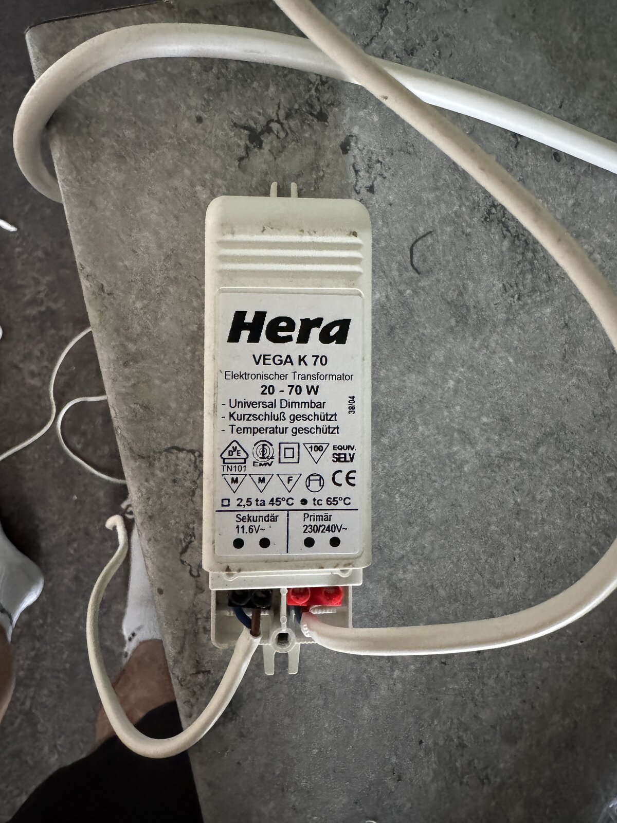

Good afternoon eveeyone,
I’m trying to install some under counter LED strip lights in the kitchen.
I currently have a transformer which used to host a spot light. Picture of the transformer added.
When I try to add my 12v strip lights to the other side of the transformer and turn the strip lights on, it flashes for half a second and then turns off again.

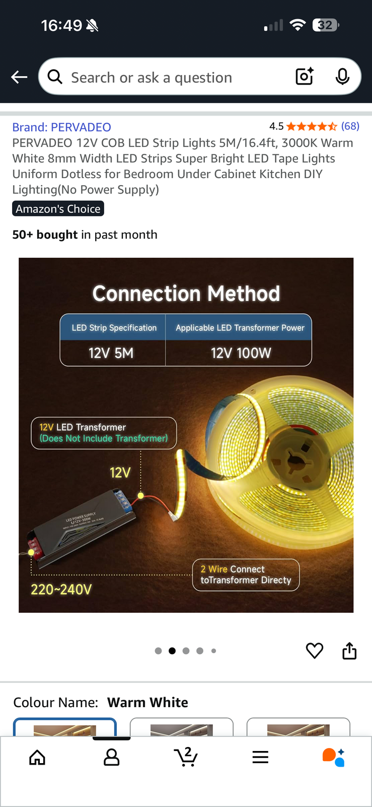

I have attached a photo of the strip lights I have.
I have also tested the transformer, plugging in the old light and it works fine.
Can anyone assist please?

Agree with above, what looks to be a tranny, supplies AC. You need a DC power supply for your LEDs.
Also
shows needs at least a 20 watt load, I suppose it does transform 230 volts to 12 volts, but it is not what we would see as a transformer.
An extra low voltage power supply can be 50 Hz AC, kHz AC, rough DC, or smooth DC. And it can be current or voltage regulated. The lighting industry has been rather naughty by swapping words around all the time, so what we would call a switched mode power supply, they call a transformer, and what we would call a driver (current regulated) they give the same name to any DC power supply be it voltage or current regulated.
I would not be surprised if they called a spade a shovel?

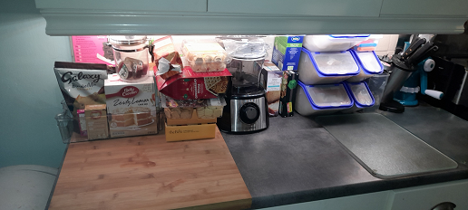

that seems unlikely, my cabinet lights are very bright if not dimmed, good enough to read with, and they are 22 watts. Also, 12 volts for domestic often means 12 volts, but with vehicles 12 volts means up to 14.8 volts. So one has to be very careful what one uses.

I don't think they will be 100 watts, but we have no way to know that for sure.
Always source the appropriate driver / transformer from the vendor of the LED strip is my advice
