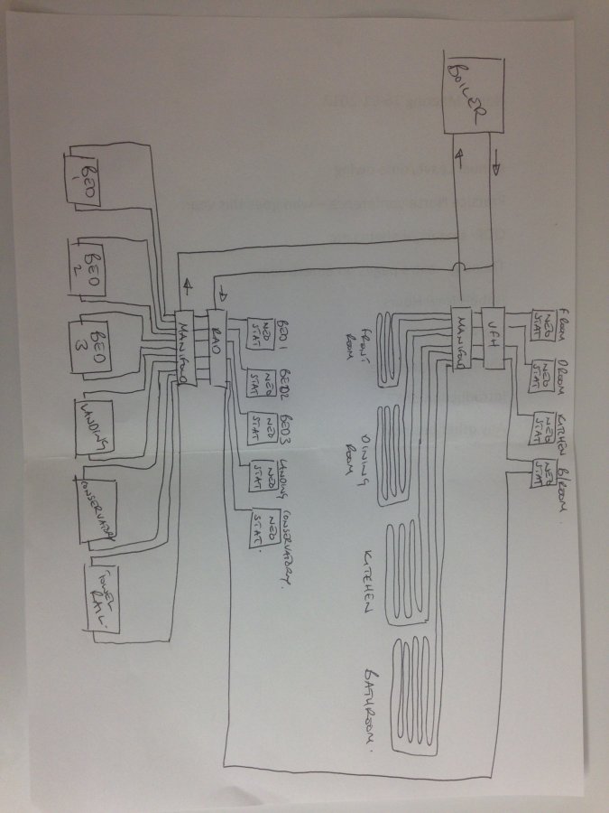

With regard to the plumbing, is this the best way to plumb two manifolds in? (I realise this shows two sets of rads, but the theory is the same)
No.
Your diagram shows the use of twin-entry rad valves (not recommended even if available)and wrongly labels an automatic bypass (probably unnecessary here anyway) here as a "pressure relief valve"
Ah, I didn't notice the twin entry...and I did wonder about the auto bypass as it's coming off a combi.
All rads will be manual valves, and not twin entry. No need for TRVs as they'll be controlled by the thermostats/manifold.
It was more the way the manifolds were plumbed back to the combi I was concerned about. Are they ok for one manifold to just go straight back to the boiler and the other teed off from there?
I think what you're proposing is fine, but a sketch of your own would make it clearer.
OK, here goes...its not the best diagram in the world, but this is what I'm proposing. (Sorry, don't seem to be able to rotate it!)
All rooms controlled by neostats, with the bathroom stat turning on both the UFH and towel rail at the same time. The bathroom is downstairs BTW.
Any suggestions for improvements are more than welcome!

So you are proposing to run the UFH and rads/towel rails at the same, direct from the combi, flow temperature?
Tony
Tony
No, the UFH will run on a mixer manifold with pump - sorry, it's not marked on that diagram
