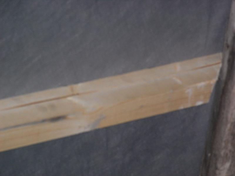

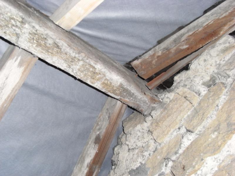

Could someone please advise on whether or not this work is to an acceptable standard, the roof on the house we have just purchased had sagging and obvious problems. The contractor said to remove slates, replace spars as required and re felt, baton, slate.
The work has now been completed but I have some concerns: on looking into the roof I have seen that the angle some of the spars are cut to meet the ridge beam are not right, they are not flush to the ridge beam and so only in contact near the top or the spars, I feel the strength is compromised and there is a risk that they may slip off the ridge. In one picture a visible split in the spar can be seen where you would expect as the point of the spar is compressed on contact with the ridge beam.
my concern is that as spars had slipped off the ridge causing us to have this re roof, we are going to be paying someone to do a poor job resulting in the same problem in the future.
I am hoping any professionals can offer opinions on the work, is it done to a satisfactory standard, if not what is the likelihood of failure/collapse and what are the options to fix the problem?

The new rafters looks the wrong size to the old rafters?
Not very professional, what type of roof tiles have you got?
However, the roof can be strengthen inside

the tiles are slate, very big, some almost 2 ft by 3ft and yes the new timber is not the same width although similar depth.
Contractor has not been paid yet so i am trying to get some knowledge/opinions of what needs doing to correct (if anything).

on second thoughts masona i dont think the depth is as great as te originals,
the photo you copied is one of a spar which wasnt replaced even though it is in no contact with the ridge beam but for the nail running through it!
should this not have been replaced?

hi
have looked at the pics of your roof, the cuts are poor but so long as they are nailed they shuold be ok, any movement would be downwards which would force the rafters tigter to the ridge board, unlikly to fall below it.
If your realy concerned you could nail a batton to the ridge board just below the rafters.
spent 30 years just roofing.

Also, considering its new work the rafters should be cut to fit flush against the ridge board, quite shocking what they've done really. I await the following pics of the other work :(
Are you sure the ply hasn't been used to replace sarking boards under the bottom courses of slates. But the rest of the work looks at best shoddy and maybe even inadequate.

I had my surveyor out as i needed to be sure what i was looking at and what needed sorting out, he raised several issues which have been spotted by many of you.
So it was strip and start again or attempt repairs and adjust price of job.
we have had the spas sistered up, the broken tiles replaced, the wood under the tiles at the gutter has now gone under the the felt instead of ontop of it!!! an area at te back has been adjusted to close some of the slate gaps and a bit of general jiggery pokery here and their.
we got a £600 reduction, which should be enough to pay a "proffesional" slater in the future to relay any sections properly should we need.
