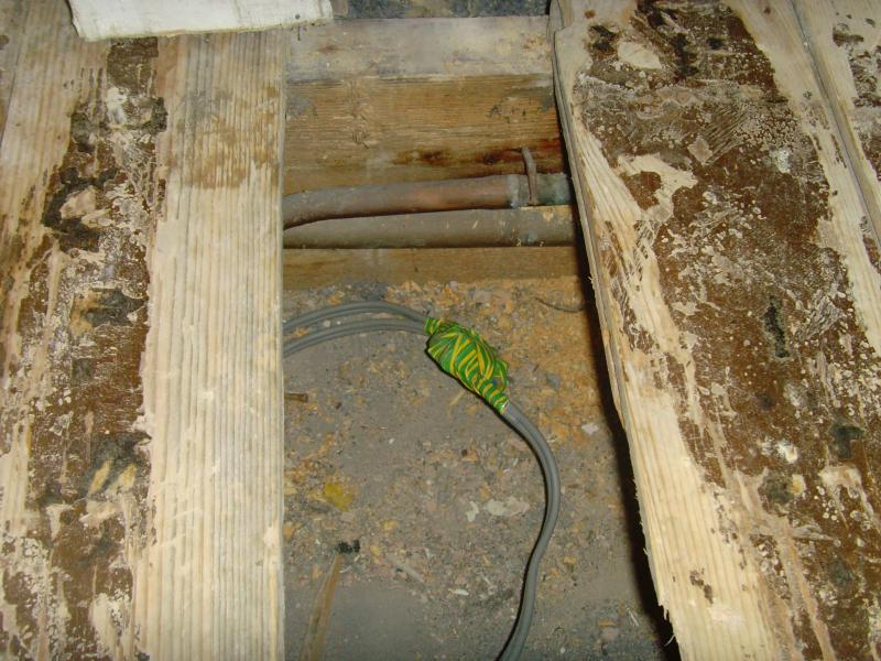

Bathroom: theres ele cables running alongside the feeds to the WHB, that seems to have some sort of junction box connecting 2 cables which has then been taped over with yellow and green striped tape. is this safe given the connection is below the WHB?

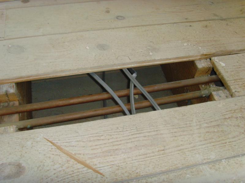

Bed 2: Ive lifted the floorboards and theres new cables been run over and on top of the heating pipework? surely this cant be safe? :eek: the pipework it copper and not insulated in anyway?

Not good, and if his testing is as good as his installation work then the certificate is probably in-accurate at best and may be so in-accurate as to be not worth the paper it is written on.
The junction box taped up with tape is a total bodge. If he feels he can leave that bodgery on view then one can only guess what bodgery he has concealed from view.
If he claims to be a member of any trade organisation then send his details with photos of his work to the registered office of that organisation and copy it to the building control office as well. ( for their information, not as a request for them to act. Let them make that decision ).
If rented then inform the landlord or letting agent as well.

Anyway -the quality of the work is crap, and if not actually unsafe, not safe enough.
It does not comply with the Wiring Regulations, so the EIC is fraudulent, and IMO it does not comply with the Building Regulations, so a declaration that is does is also bogus.

That looks like a very rough job with no pride taken in the work bet it was done on the cheap. The connector blocks wrapped in tape under floor says it all about the standard off work.

an electrician mate of mine popped round last night and checked sockets and switches and said they were fine. he said that the 'taped' cables in the bathroom are where theyve cut in to link the outside light which is on that external wall. he said it should meet at a junction box.
he also said that 'NO ELECTRICAL CABLES' should rest on heating copper pipework.

A junction box under the floor would be a vast improvement, though as it has screw terminals and is unacessible it's not acceptable. However, for years and years electricians would often fit junction boxes under floors.
The block wrapped in tape shows no effort at all though.
The cables over the pipe could perhaps be the result of drawing cables through the floor void, without that floorboard being lifted up. That said, by drawing the cables through the electrician should have 'felt' the pipework.
The outside lamp should be fed from a double pole fused switch outlet. That enables you to fully isolate it should it become damaged and dangerous. It also allows the rest of the electrics to operate without the damaged outside lamp tripping an RCD or MCB
It may be that the cable that was cut into already served another outside light, which may have a switch somewhere.
