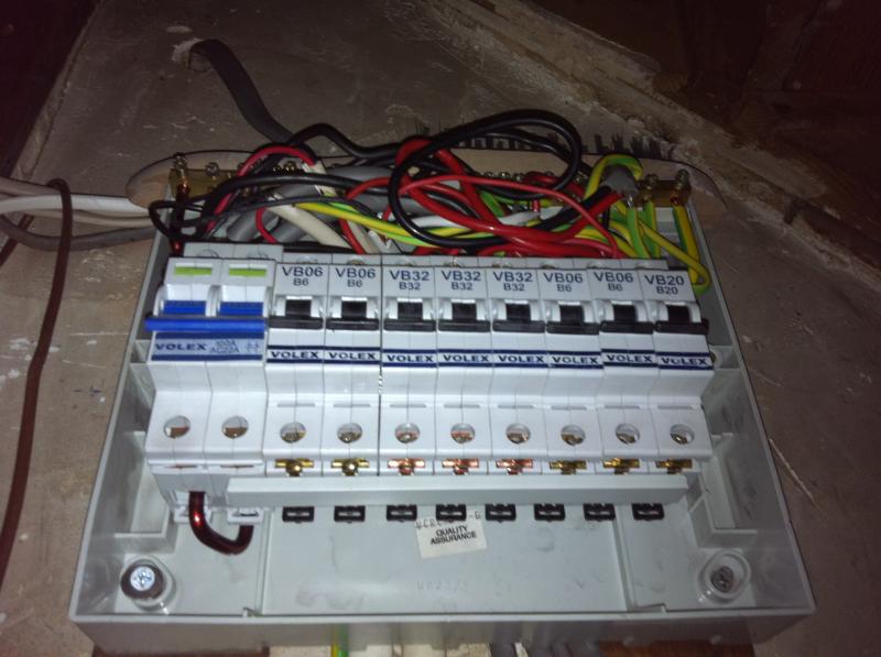

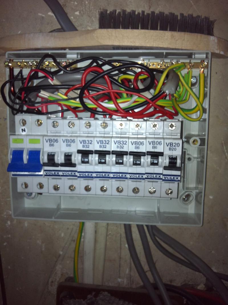

Hey Guys,
Thanks for the replies.
I upload a picture of my fuse box
The downstairs hallway light and upstairs hallway light o`are on the same switch. But the upstairs light doesn't work, but the downstairs one does.
Their is a circuit for upstairs and a circuit for downstairs.

There's leaving plenty of spare cable for a board change and then there's leaving plenty of spare cable for a board change!
Needs more bolognese sauce! :D
Seems that you have slightly more significant issues than lights going off.... this installation really does need the attention of a qualified electrician. And that wiring you saw in the loft looks potentially deadly!
