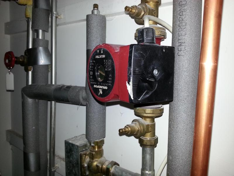

I think it's working. There is pump on hot pipe with a sort of switch. If you flick it up pump comes on. If down goes off. I think this might be a safety switch if the system is dry won't burn pump out? Am I right? Boiler flame is still on water heating after 5 minutes.
Boiler still working so is pump. Lovely hot water. Maybe it was me flicking this switch which looks like a semi dial switch. 11 oclock for on 7 oclock for off. Can anybody tell me if these are fitted with saftey cut-out in case people like me drain the CH system dry and leave HW to auto? :rolleyes:

pumps don't have a safety cut out, they'll run until they burn out, you may be referring to the pump speed, but without a picture its hard to tell what you mean.
This is the pump? I understand that maybe me turning the dial to 11 oclock sped the pump up? Anyway after say half hour the HW stopped working. The CH works ie ignites the boiler when switched on but the HW doesn't ignite the bolier. So I may have only hot water for a shower in the morning.
So why do you think it stopped working?
Do you think I damaged something when HW was left on AUTO overnight with the CH drained? :rolleyes: [/img]
Hey Bernard that looks like the silver box on the side of the image I posted.
I felt something like a switch underneath. Do I flick it or something? :oops:
