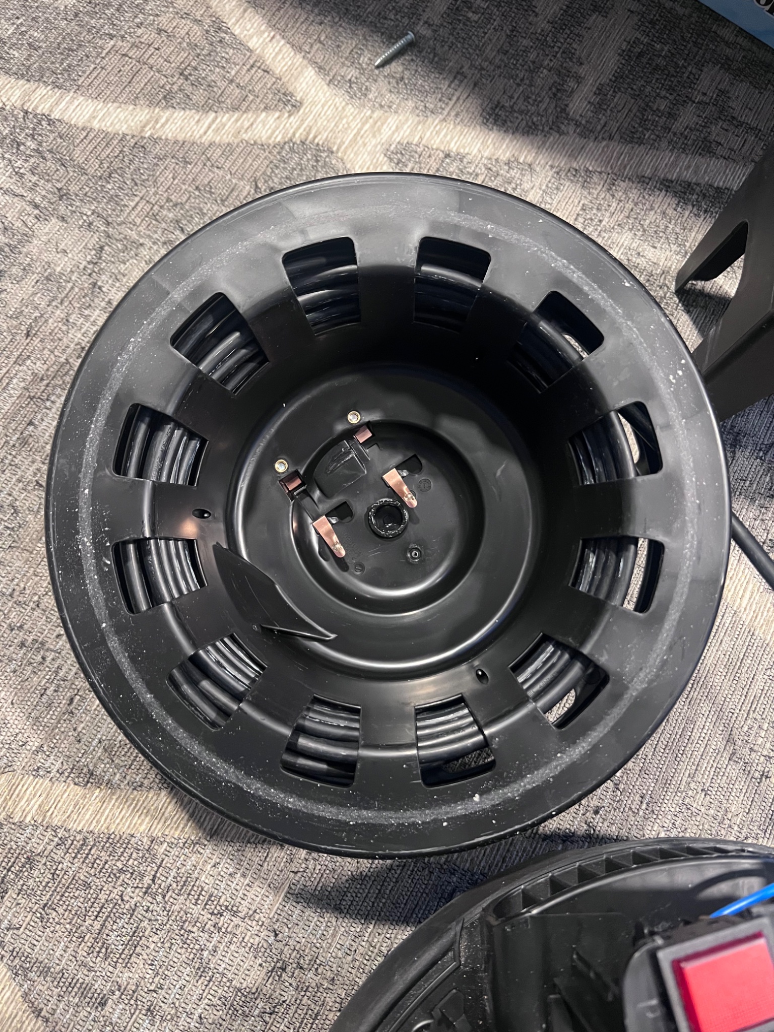

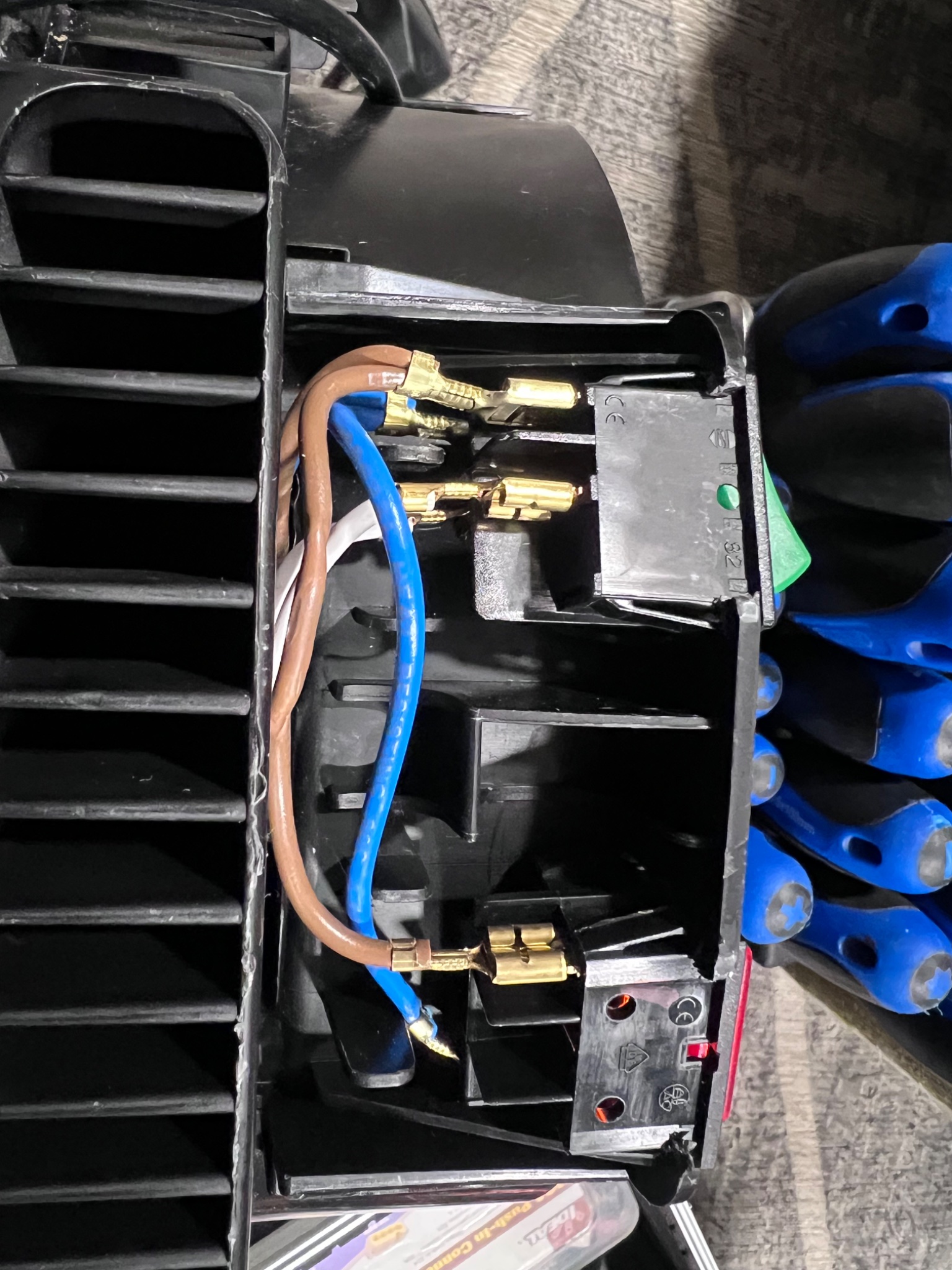

There no life on this all of a sudden.
The led doesn’t light up and it doesn’t start.
When I put my fluke T130 on these probes, it shows AC but no voltage display.
There’s plenty of battery in the tester and I’ve done a self-test to confirm that the tester works.
When I test the wires going into the switch, I get the same AC but no voltage display.
There’s plenty 3 pin plug is moulded. Any suggestions on what might be causing this?
Yep, tested the fuse but if that was blown, would I get an AC light?
In the end I changed the 3 pin plug and hey presto! We have voltage reading at those pins.
All working now.
One question, why do I still only get a AC light here and no voltage?
