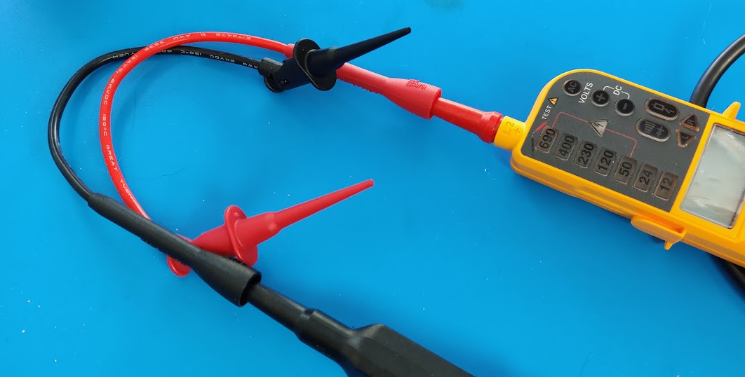

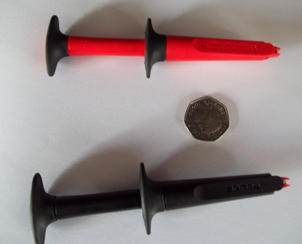

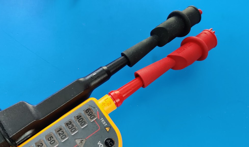

I use these:
Fluke AC175's screw straight on to the little thread on the probes
The probe kit that came in a bundle with my Fluke 115 doesn't have small croc clips. These are the smallest
