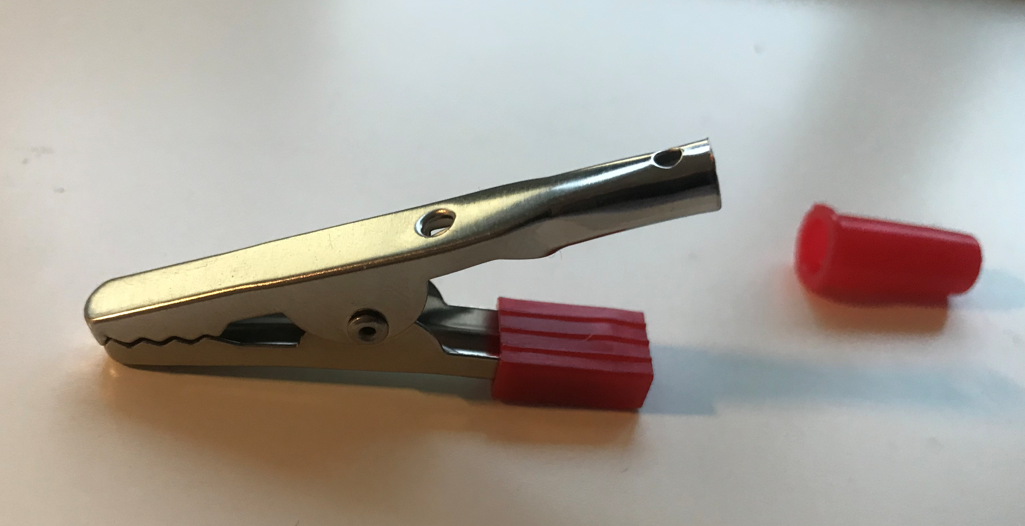

I took delivery of the crocodile clips today and was planning to terminate all 3 cores of the flex into these.
I was expecting there to be some screw terminal but it doesn't have one. Can someone advise how this should be done please?
Get out your soldering iron. Or buy one along with some solder.
When I bought something similar, there was a short screw, with the nut and washer to grip the wire inside the hollow part of the handle. Yours appears to have a hole for such a screw.
the clip you show has a lot of exposed metal you might touch, so is only suitable for extra-low voltage, such as a car battery charger. It would be very dangerous at mains voltage. Proper test probe leads are swathed in protective plastic covers.

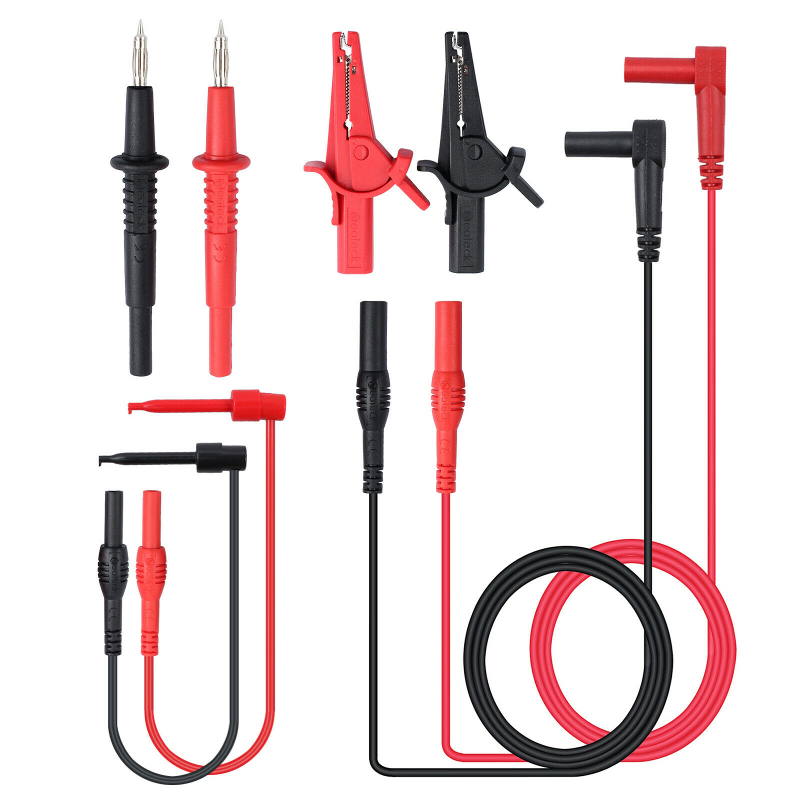

you can get cheap replacements sets on ebay such as
but you have to be very cautious with a supplier of unknown quality
But I am using this for a longer wonder lead. The type you have posted are much smaller in length.

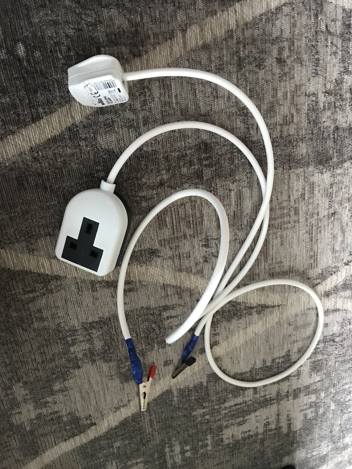

I was planning to use the extension lead with some mods for this purpose
I appreciate the hammering I may be in for but here are my mods to go with an extension lead - to act as a wonder lead.
I always intend to check and isolate power before using this “equipment”.
