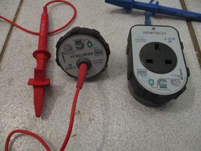

Agreed, and for that purpose, you can use any electrical conductor (wire/cable) to 'extend' your lead - e.g. just a length of cable/wire you have lying around..
In fact, one approach is to use a mains extension cable drum as that 'conductor' to extend the test lead, which is what I usually do. One can easily 'improvise' but I actually have a pair of Kewtech adaptors designed for that (which I use with a a 25m or 50m 'cable extension drum' (the mains extension plugs into the right-hand one and the left hand one plugs into one of the outlets on the mains extension lead) ...

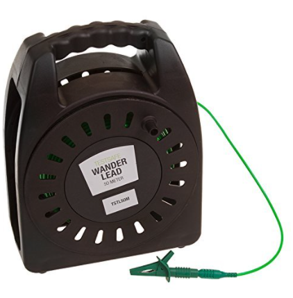

A few of you have suggested an earth lead to play this role but does it get damaged and become a trip hazard? They also don't have the crocodile clips to snap on to one end of the cable. I'd like some advice around this please.

does this work out cheaper than a 50metre purpose made wander lead? or does it have some other benefits over that? ....
That depends a lot of what 'this' costs :-)
In many/most cases (like me), one would already have the 50m (or whatever) mains extension, so the only marginal cost is that of the adapters. Even if one had to buy the (mains) cable reel as well, it would also then be usable for 'the intended purpose', whereas a dedicated product such as you illustrate can clear only be used for one purpose, presumably very very rarely for the average DIYer.
Having said that, having had a quick look, I'm not convinced that 'adapters' such as I illustrated are still available (I've had mine for years). However, as I said, one could easily improvise with a 13A plug and a 13A 'trailing socket', which should not cost much at all.
