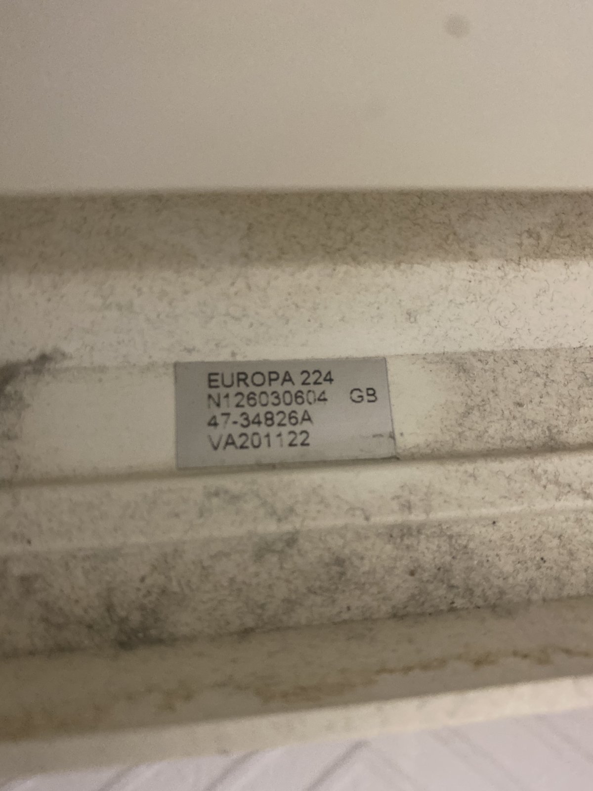

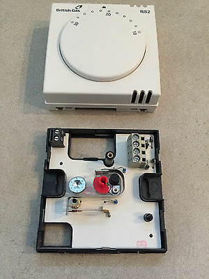

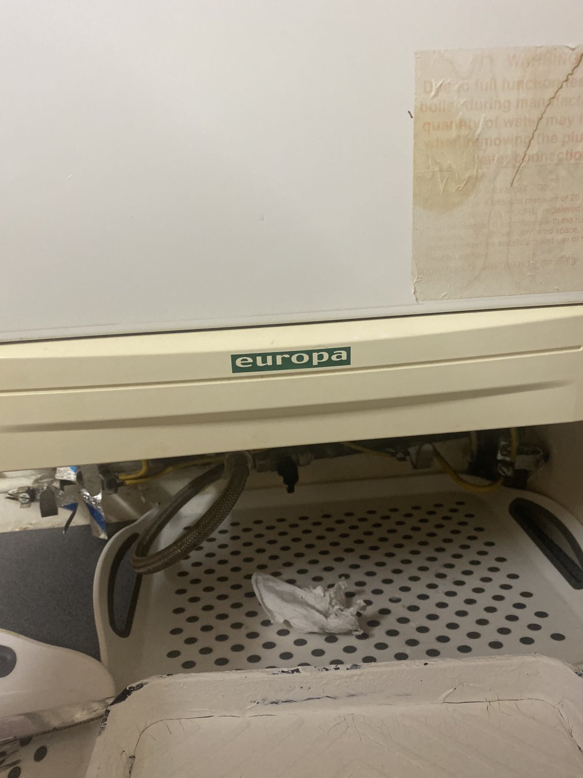

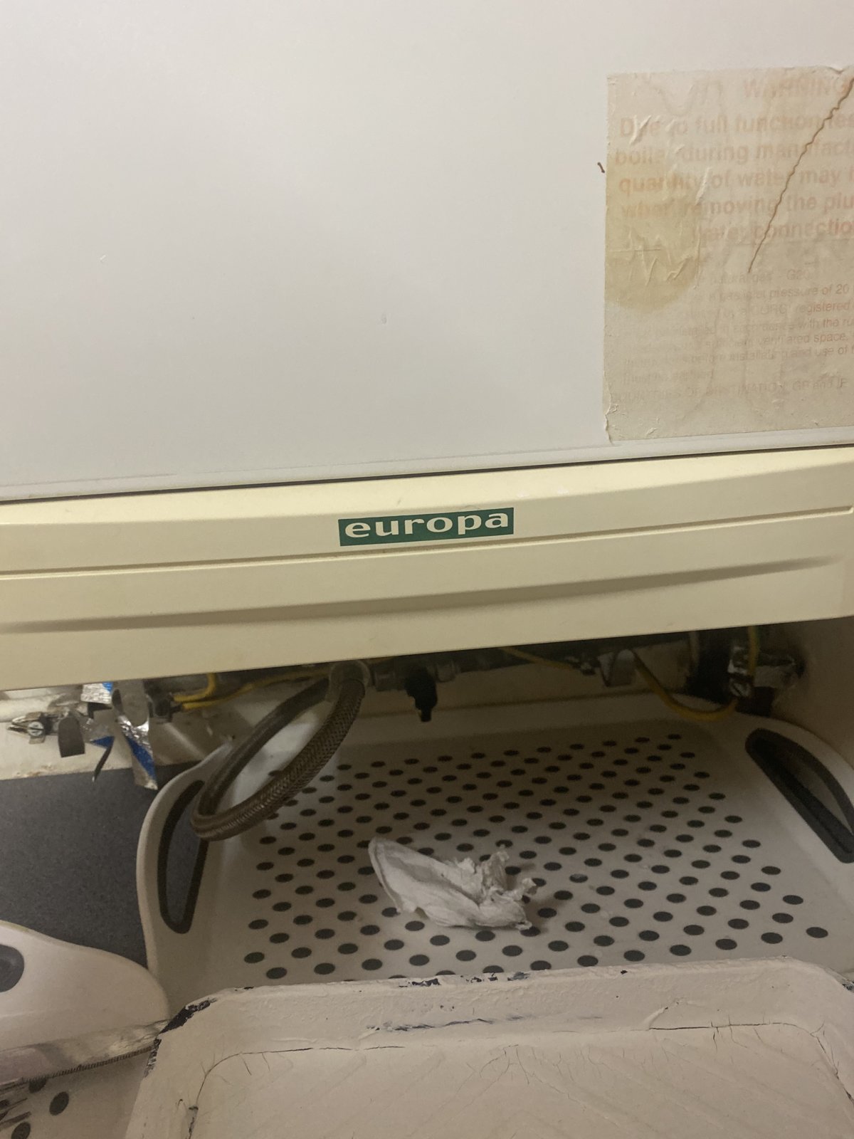

Ok so im planning on buying a hive set as its on sale just now, i just want to make sure my boiler is compatible.
My current thermostat sits on my wall its a british gas rs2, am i correct in saying this will be removed for the hive thermostat and thats all i will need done and nothing else added or removed?
My bolier is a euorpa 224 it heats my hot water and central heating, ive got a electric shower incase that helps with the setup as im clueless!

A thermostat is just a switch, it turns the heating 'on' and 'off' and that's all it does. That's what the RS2 does and it is what Hive also does. So, Hive is a suitable replacement for it.
However, just as important is the system that the boiler is connected to. Otherwise you could end up with the wrong version of the Hive. You will find on here numerous individuals lamenting that they have bought the wrong version, and desperately trying to find a fix.
1) The single channel version is for combi boilers that heat hot water instantaneously on demand when a tap is opened, and are not connected to a hot water cylinder. This version of Hive controls central heating only. The single channel Hive has a voltage free contact that can be used with combi boilers regardless of the control voltage they use. For example some may use 230V for their control circuits others 24v. With this voltage free verson of Hive, it doesn't matter.
2) The dual channel version is for heat only boilers that are also connected to a hot water cylinder. As the name suggests it provides separate time control for the heating and hot water. This version is only available in 230V
So:
A combi boiler without a hot water cylinder = Single Channel Hive
A system that includes control of heating a hot water cylinder = Dual Channel Hive

Looking at the instructions is seems the boiler has it's own anti hysteresis software which is matched to the thermostat, so you will need to read carefully to see if Hive is going to work, it does seem it uses extra low voltage control so duel channel Hive will not work.
The whole idea of the modern "Smart" thermostat is to work out at what point to turn down (ebus type) or switch off (on/off type like Hive) to allow for the heat retained in the radiators so it does not over shoot and cause a hysteresis curve where the temperature is in a sine wave as it over and under shoots the selected temperature.
The modern gas boiler is designed to modulate, that is turn down to output, rather than simply switch off/on, and is designed to work with thermostatic radiator valves (TRV) so either the return water temperature or connection to ebus matches boiler output to demand, this will reduce the hysteresis to a very low valve. However there is a problem using water temperature in that unless boiler is running it can't sense if required, so without some thing extra it will cycle all summer, so we want some thing to turn it off when weather is good.
So the wall thermostat is used to switch off boiler in warm weather, but if set to turn off boiler in cool or cold weather it can upset the boilers own control using return water, so boiler does not modulate as it should and so uses more fuel than it should.

The Hive Single Channel is the same as the OP's existing BG RS2...
...Electrically speaking they are both a simple on/off switch, and provide exactly the same control. Central heating 'on' or Central heating 'off' and that's it. If the RS2 works OK, so will the Hive.

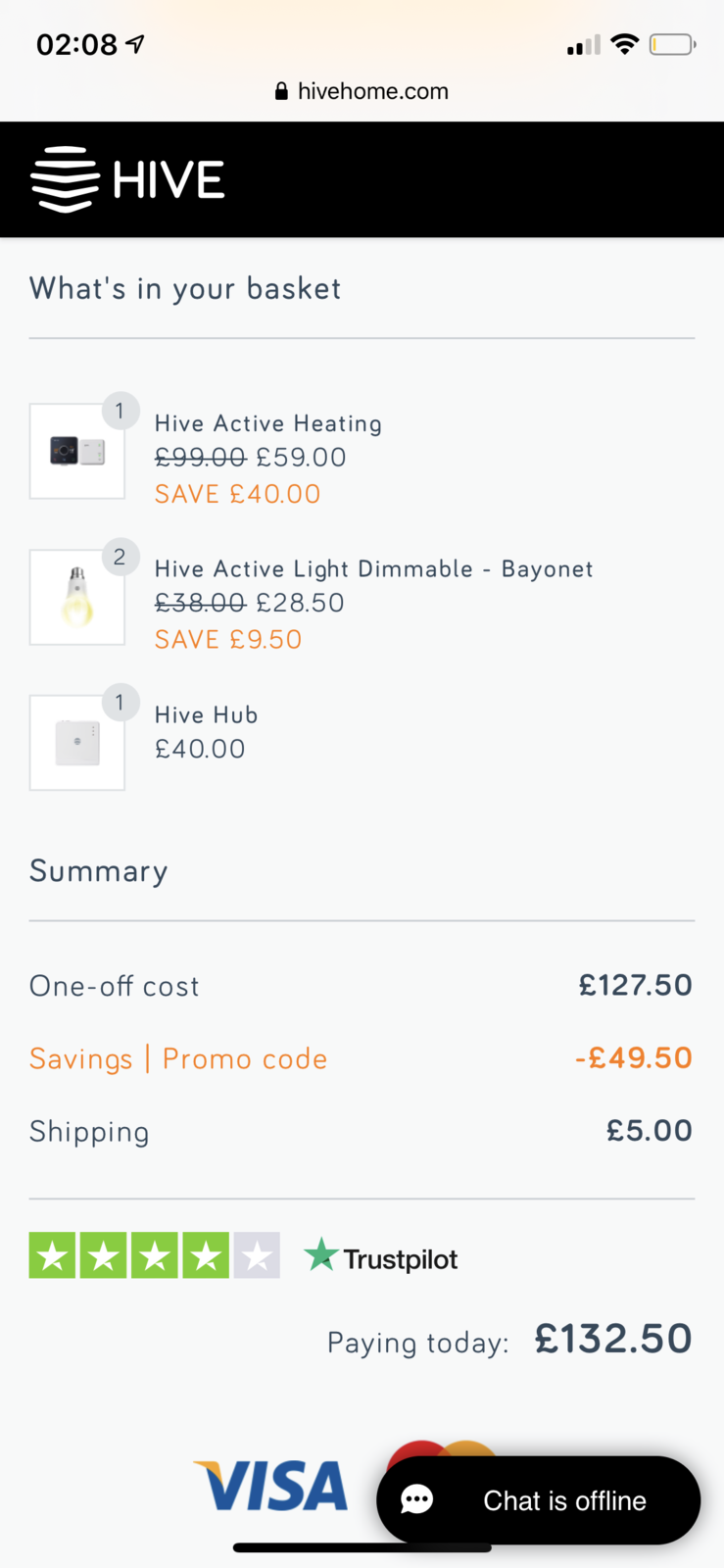

Thanks for all the replys guy!
Ive got alot of reading today this morning lol.
By after having a quick skim it seems i should be ok.
Im only wanting it for the purpose of turning the heating on while im out.
I have no problem with trv heads as im not there yet but maybe one day lol.
If anyone wants to get the same hive deal i got give me a pm i have a code that gets £40 off hive spends :)
