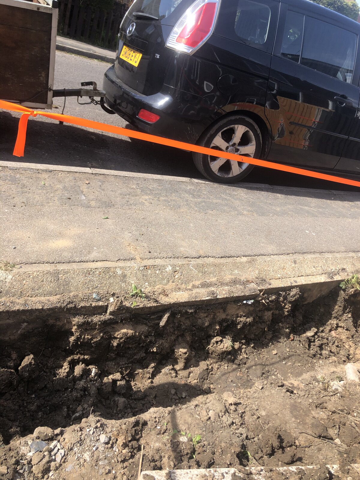

the footings for the wall are right next to the path / road … I don’t think I could get any closer if I tried lol
Guess I just have to figure out ready mix v cement mixer… I have a cement mixer ( even though I’m
A Plumber lol ) and the ballast etc would be right next to it. I
Guess it’s just how long it would take … i think
It’s around
1.3 m3 I figured so if that could be mixed in less than
2 hours that wouldn’t be bad but my maths may be way out lol

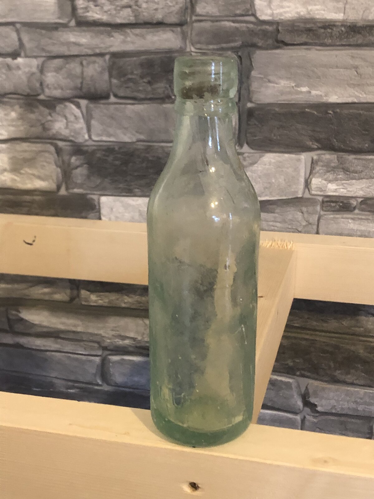

on a side note I
Dug
Down
To 50cm (not finished yet)which seems to be ok and whilst digging found a
Bottle made by our local town in 1913 … quite a few people
Are
Showing interest in it lol
