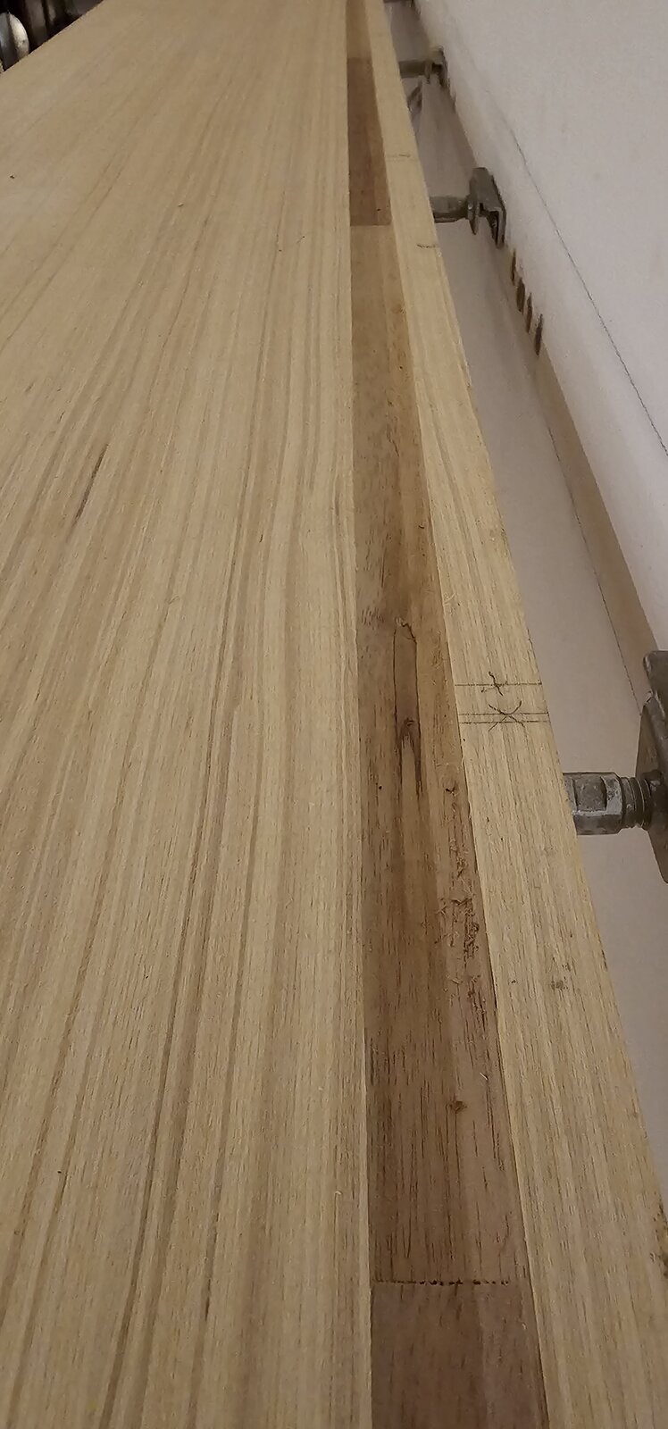

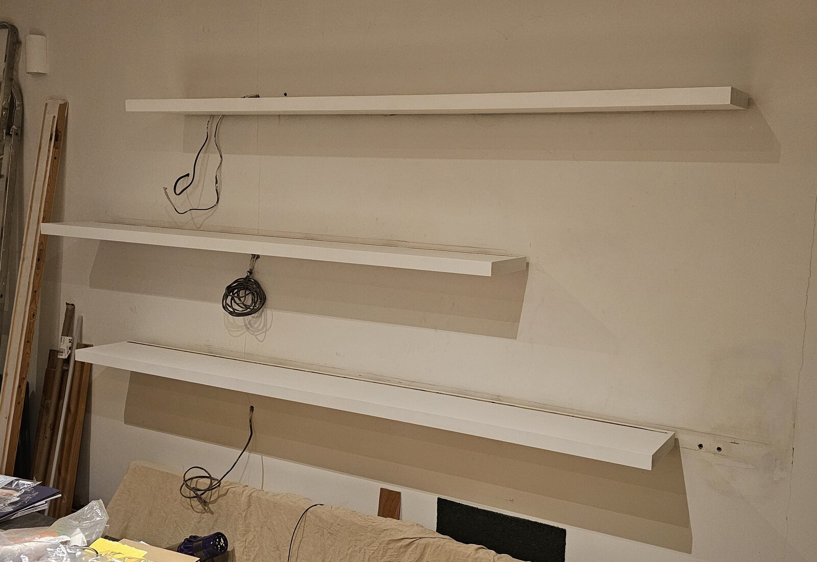

I made and installed floating shelves from plywood laminate. The top and bottom ones are 2.4m long. The middle one is 2m long. Shelves are 43mm thick.
I have 220v supply pre-installed per shelf. I'd like to hide the drivers in the wall or in the shelves but to still make them accessible enough for maintenence. The shelves slide in and out on the Haffale consealled shelf brackets so hiding it in the shelf is a possibility. But is it good practice to do that safety-wise?
TIA
Sure. Providing the connections and any power supplies are accessible.
I doubt you’ll be able to conceal the driver and cables and connectors - so try on an off cut first if you have any
Where would you stash the drivers cables and connections if not inside the shelves?
