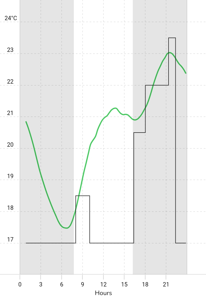

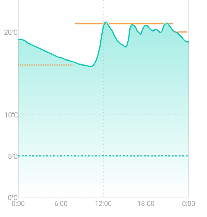

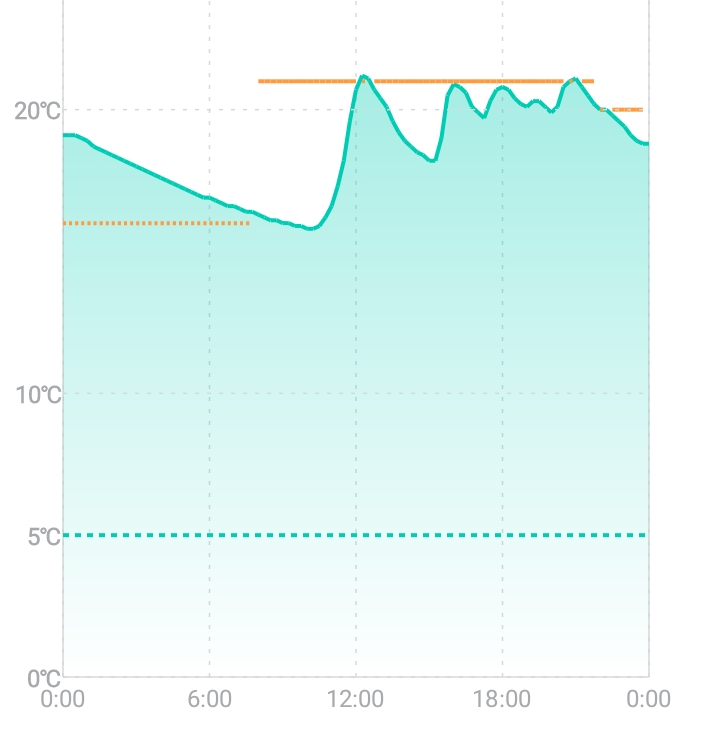

The TRV and room thermostat does show how the room has be heated over the day 1733874605155.png1733874684781.png this will clearly vary home to home, as to geofencing did not find it worked too well, as only options for setting with Nest Gen 3 is the Eco and Comfort setting, but I am using a non modulating oil boiler, modulating gas would be better.

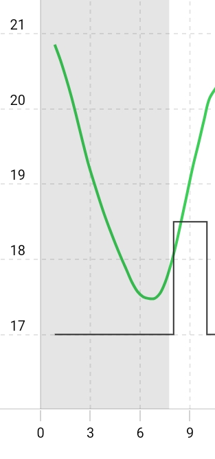

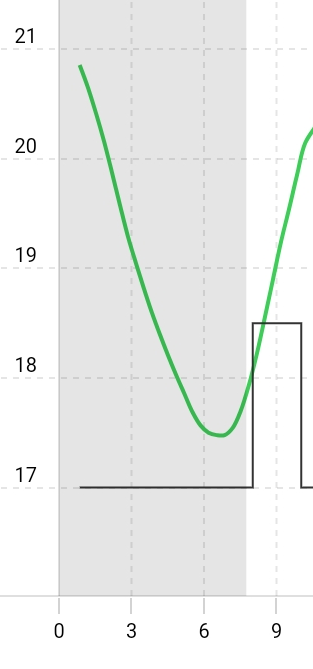

I see your point about if worth switching off at night and while at work, my house 21ºC to 17.5ºC in 6 hours
The big problem is the reheating looking as you can see at 4 hours, but not easy to work out how much energy used when I have two room thermostats and 9 programmable TRV heads, the Nest records how long it has asked for heat, but not how long the boiler has run for, and dipping the oil tank does not really help. I would guess we spend around £700 a year on heating a detached three story house, but unless we fitted a heat pump can't tell how much more expensive it would be.

The TRV and room thermostat does show how the room has be heated over the day View attachment 365853View attachment 365854 this will clearly vary home to home, as to geofencing did not find it worked too well, as only options for setting with Nest Gen 3 is the Eco and Comfort setting, but I am using a non modulating oil boiler, modulating gas would be better.
I see your point about if worth switching off at night and while at work, my house 21ºC to 17.5ºC in 6 hours View attachment 365855 The big problem is the reheating looking as you can see at 4 hours, but not easy to work out how much energy used when I have two room thermostats and 9 programmable TRV heads, the Nest records how long it has asked for heat, but not how long the boiler has run for, and dipping the oil tank does not really help. I would guess we spend around £700 a year on heating a detached three story house, but unless we fitted a heat pump can't tell how much more expensive it would be.

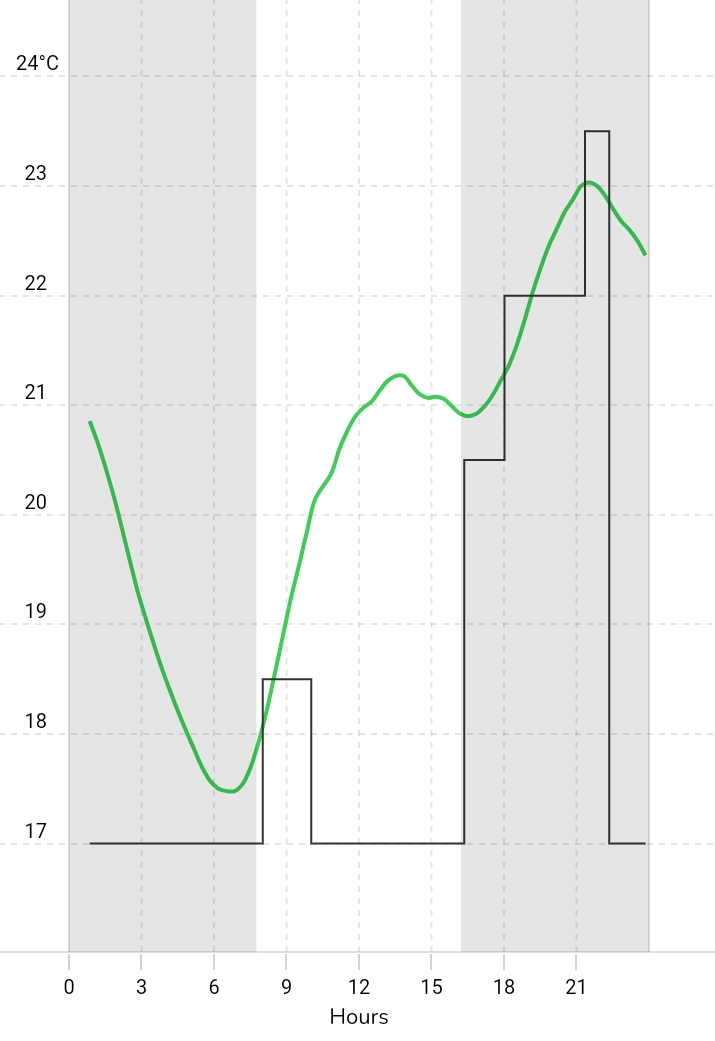

You won’t be saving much if anything. I monitored exactly the same thing- heating duration via the nest, versus our actual usage on Hugo. On weekends the duration was more obviously, but that would equate to something like 5kW gas. So for a saving of 20-30p we’d come back from work to a really cold house. The set backs for us just weren’t worth it.
