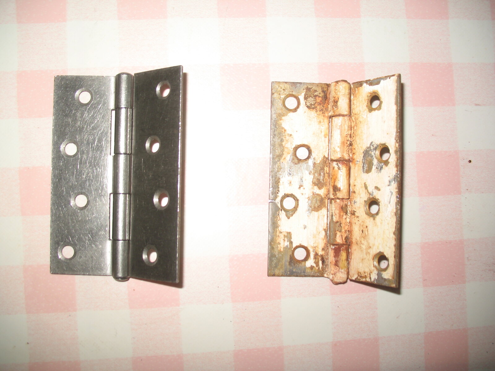

Hi –
I have conservatory doors which open outwards into the garden. I have replacement hinges of similar size but for the screw positions to match the existing hinges I would need to reverse them which would of course place the countersinks on the inner face? To elaborate: the 3-knuckle side of existing hinge is fixed to the door frame and the top screw hole is to the left of centre rather than in the centre as it would be with the replacement hinge. Are my existing hinges oddball or obsolete or some different specification?? I will appreciate advice as, rather than a simple change of hinges, the alternative will be to fill all existing screw holes and completely re-hang both doors. (I know I could (possibly) countersink the new hinges on the reverse side but I don’t fancy doing this with 48 holes!).
Regards.

I had actually considered those options. Of course I would be countersinking into existing countersinks on the opposite side with the risk of a large hole or certainly a very weak area as the hinges are only about 1mm thick. With regard to new screw positions these would be very close to existing screw holes so I would probably need to fill in the existing holes. I did actually try this with a well-known tube of wood filler which didn't work too well. So I bought the well-known's 2-part filler which I believe is better with a view to trying that. Another idea I tried was to enlarge the screw holes and glue in a short length of dowel. Yet another option is to try and revive the existing hinges. Off the shelf paint stripper is weak stuff these days and I may get something that is more effective. The very best and easiest solution would be to obtain identical new hinges which has proved to be annoyingly difficult!

Actually it was the 72mm that confused me. 4" x 3" seemed a natural Imperial size to me which would be about 102 x 76mm or nicely rounded to 100 x 75mm. Having said that, my existing hinge (which I'm sure is Imperial) does measure about 100 x 72mm! Maybe it's effectively 3" (76mm) when installed?
To me they look like steel hinges, the older ones used to be thicker, but they look they should replace, hole positions hmmm! Good luck, I've come across some that I would say yes they are okay... Then they are 2-3mm out which makes it more interesting!
Yes, I think they're steel and could be 1.5mm thick (1/16"). I've already come across being 2-3mm out with an old chrome hinge I tried - I'm not sure tooth picks and glue would work in that situation? In that instance I enlarged the hole, glued in a 9mm dowel, and drilled into it. And that's why I bought some well-known 2 part wood filler as it can apparently be drilled. As you've probably gathered there's no great urgency with this job so I don't mind a bit of experimentation but I'm hoping to finish before lockdown is lifted!

Seek and ye shall find!
HINGES_CROPPED.png These apparently came from SFix some years ago - they still stock them but for some reason the top screw hole is now located in the centre rather than the left of centre??
