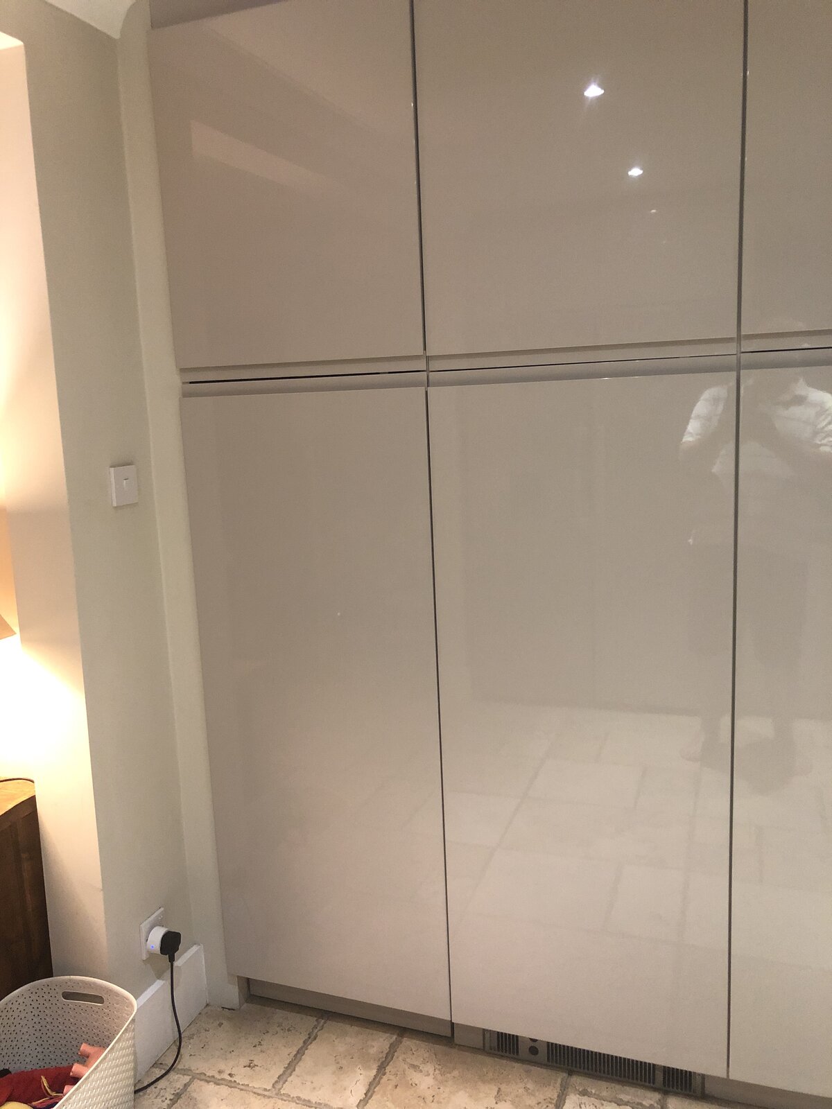

You only need 18mm mdf to frame the cupboard, makes use of the kitchen style hinges on IKEA doors , did that in several bedrooms.

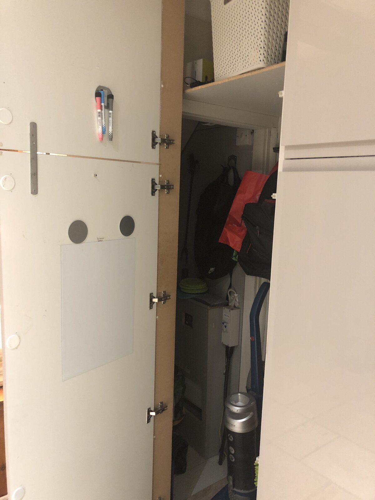

Can you open the doors please? Just wondering what your hinges are attached to ? Presumably 18mm MDF, but what if you want to fill a wall that's not exact multiples of 500mm? What is the MDF fixed to?
In those photos the wardrobes are filling alcoves I think. What would you use/ how would you construct a frame to take the MDF if you weren't building in an alcove?

None off my alcoves suited IKEA doors so mdf is used to reduce all dimensions to suit doors.
For free standing unit mdf side panels are used just like you create a kitchen cupboard .

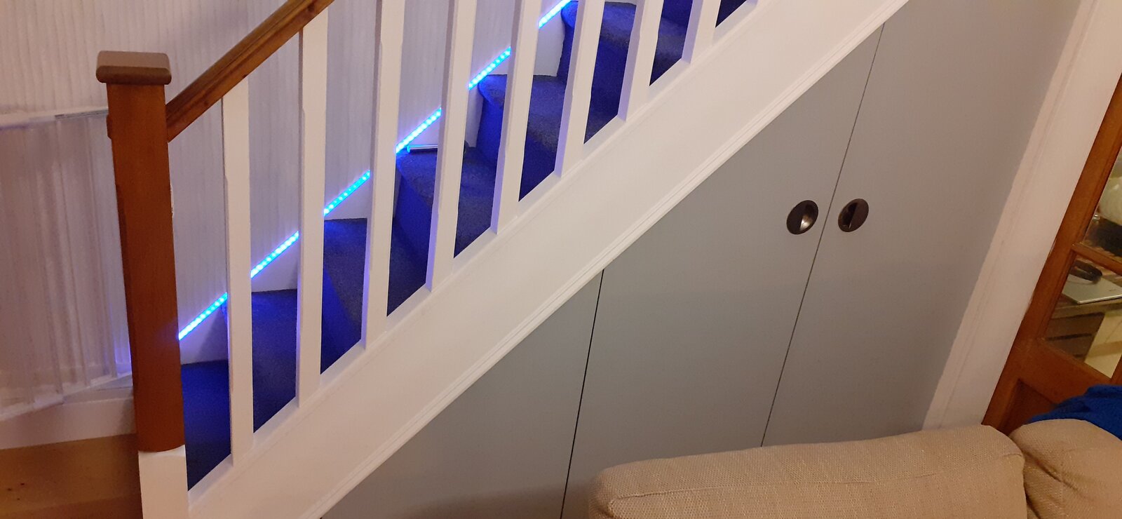

image.jpg image.jpg Here I used kitchen doors to hide and under stairs cupboard .

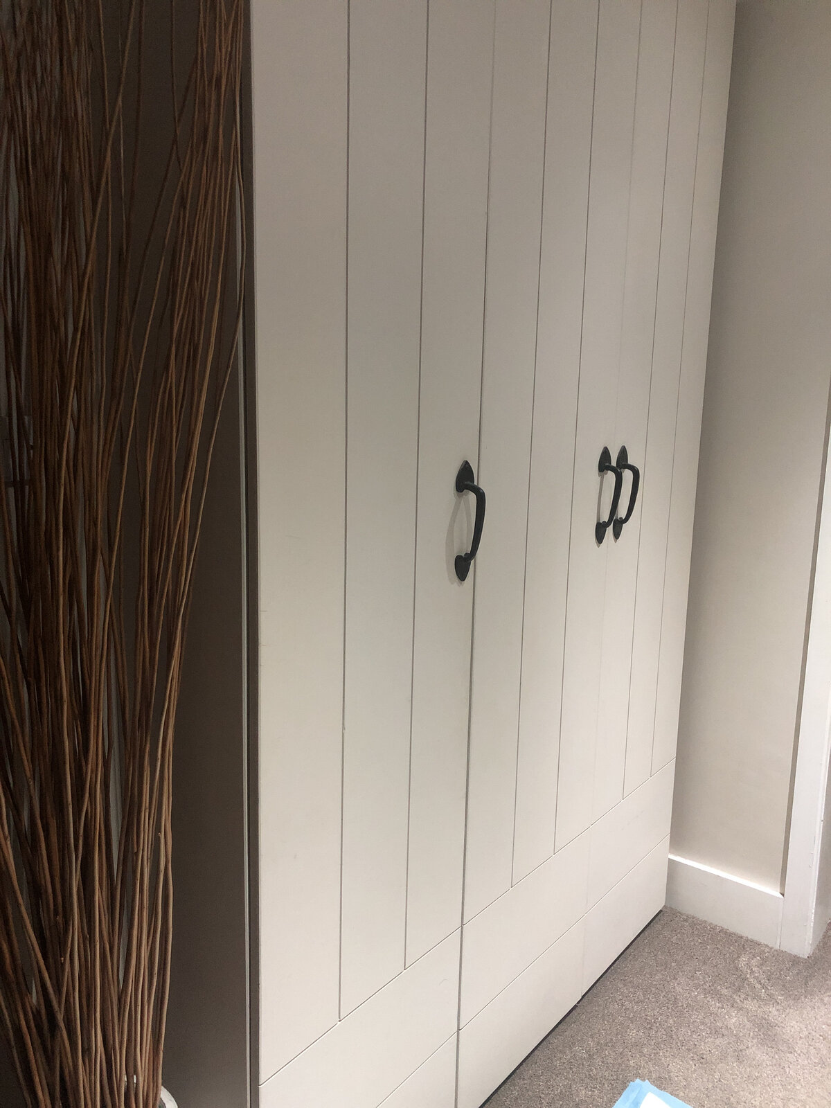

image.jpg Here constructed mdf storage using mdf again for entire structure ( routed for panel and draw effect)
Mdf is fixed to walls internally , no framing timbers are required .

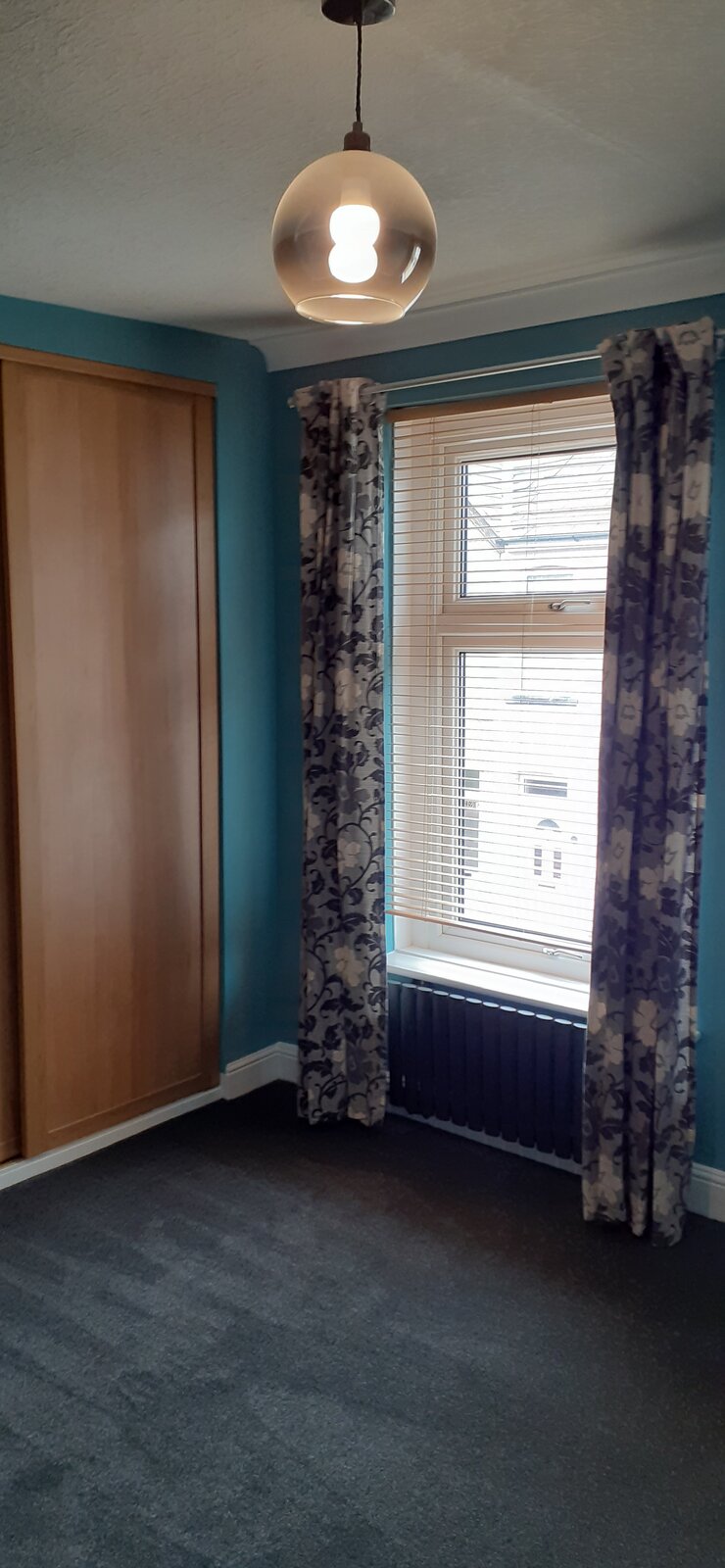

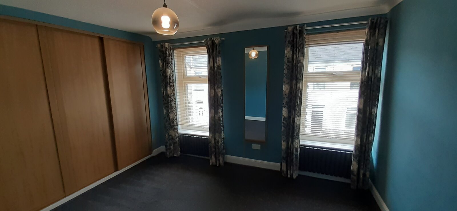

Here is my front bedroom:
