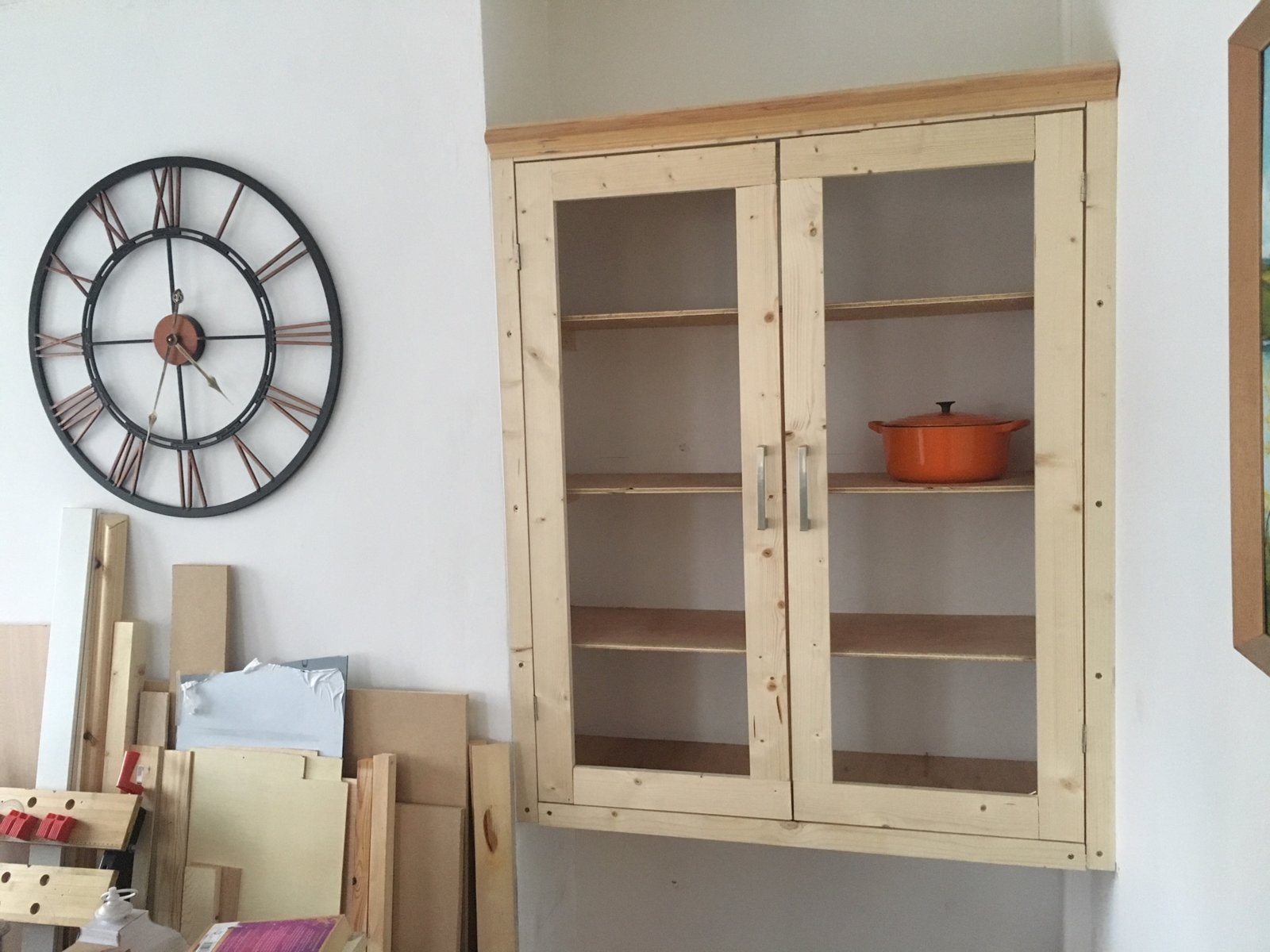

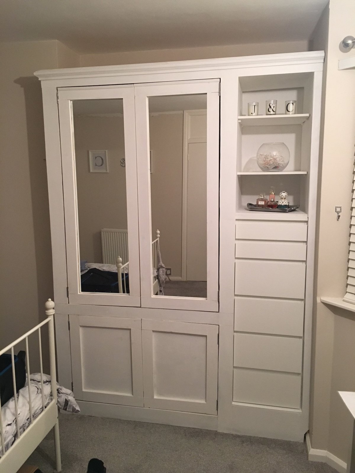

If you like these I can tell you my method for creating them.
The first picture is of some fitted bedroom wardrobes I built. Not perfect as it was my first ever attempt on that scale, but I'm happy with the overall look and have since ran some of the door edges through the table saw. The second picture is of the kitchen cupboard I built last week. This time I perfected my method for building cupboard doors and the whole thing works beautifully. I just need some beading to go on the shelf edge and decide whether or not to paint it or stain.
