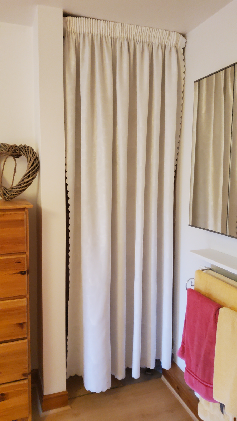

Here's a photo of the hated curtain
You can see I have already removed the old plinth.

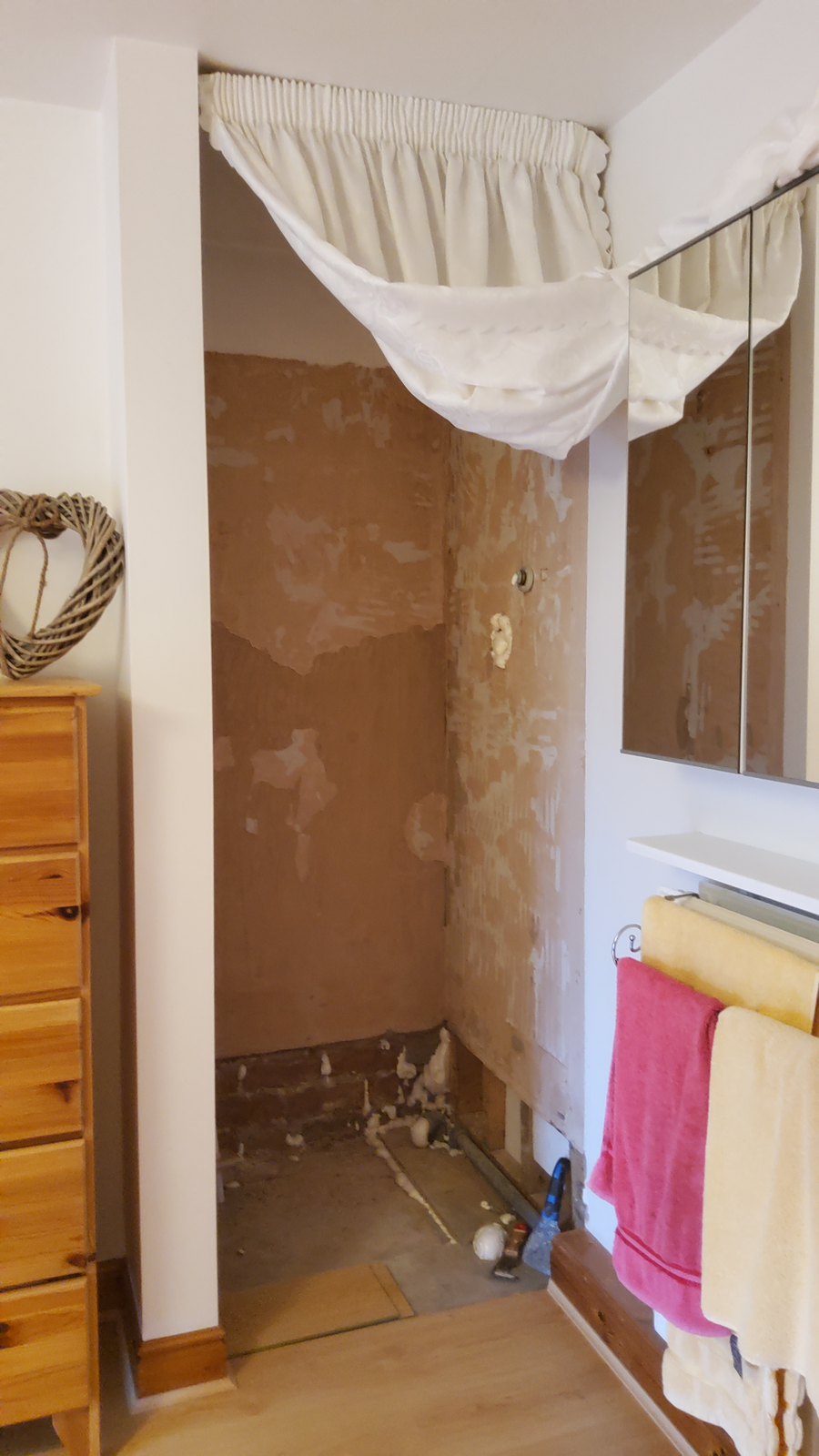

Here's a photo of the alcove including the waste pipes in the base

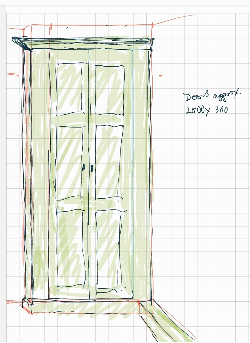

And here is my latest drawing. My new idea is to incorporate the existing protruding stud wall on the left as part of the wardrobe frame by mimicking it on the right. I want to maximise the inside space so I havent worked out yet how to bring the framework on the right inward to support the door hinges.
My idea is that if I add a top filler panel and paint that with emulsion, but paint the cornice and left stud in satin paint. then the balance of the unit will be better. I dont want to make the doorway feel cramped or have difficult access, but having the doors smaller should make it easier and still not make it feel cramped.
What do you think?

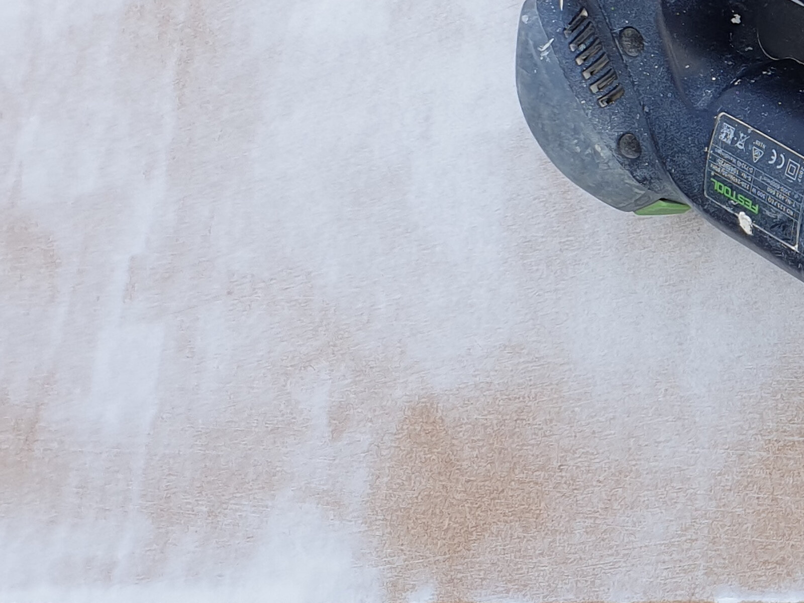

I've never yet succeeded in getting a good smooth painted finish on MDF
I am a decorator.
I use cheap as chips Leyland Trade acrylic primer. When dried, I sand most of it back.
The Leyland stuff is a dream to sand back. I use 240g paper on a random orbital sander and the MDF is much smoother than it was when manufactured. That said, I then paint it with oil based paints. They do not cause the grain to raise any further, waterbased paints will. When customers insist on a waterbased finish, I first use oil based undercoat, but you have to wait a week for the solvents in the oil based paint to evaporate. If you apply water based paint too soon, you end up with "fisheyes" in the paint- basically "wells" where the WB paint has pushed away.
The potential quality of finish of MDF, if painted properly, far exceeds ply.
