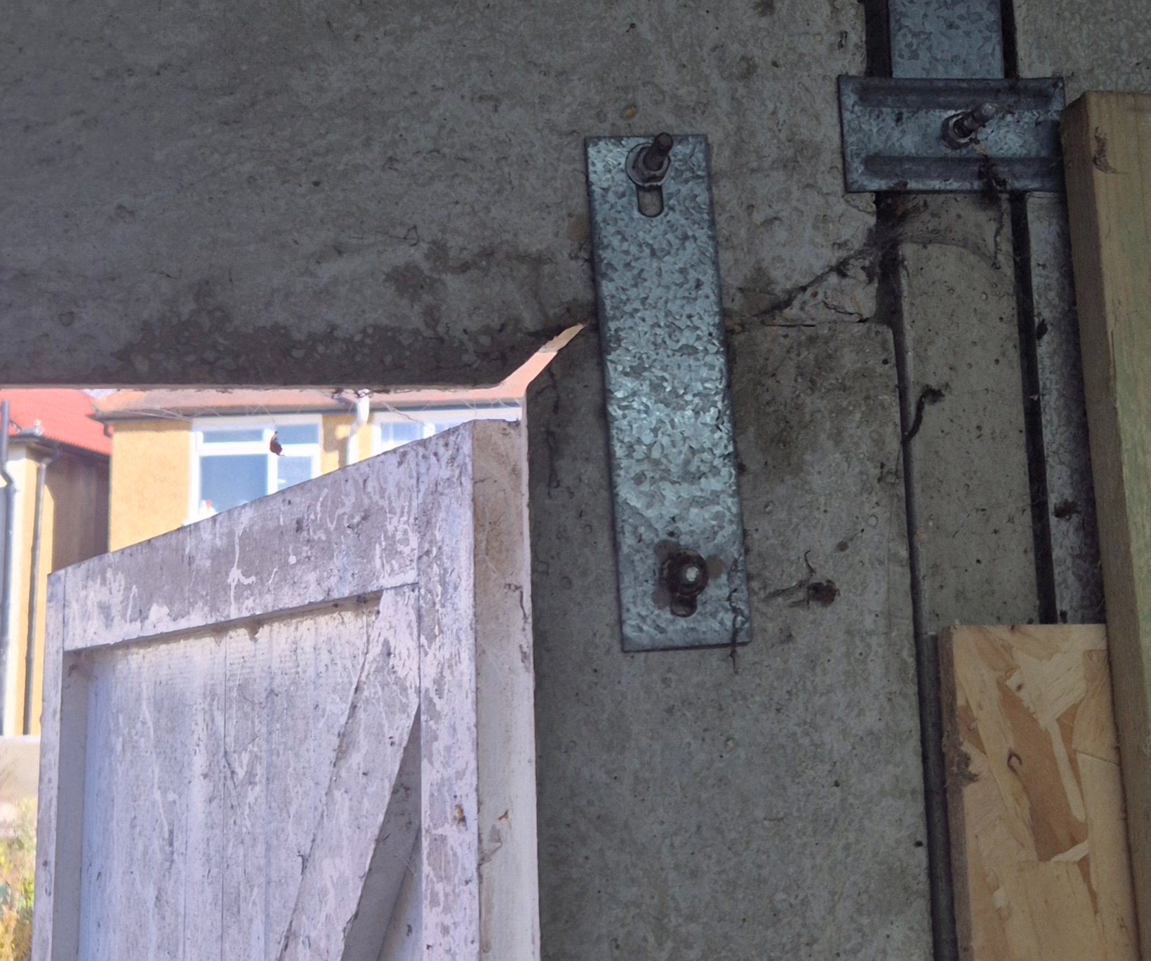

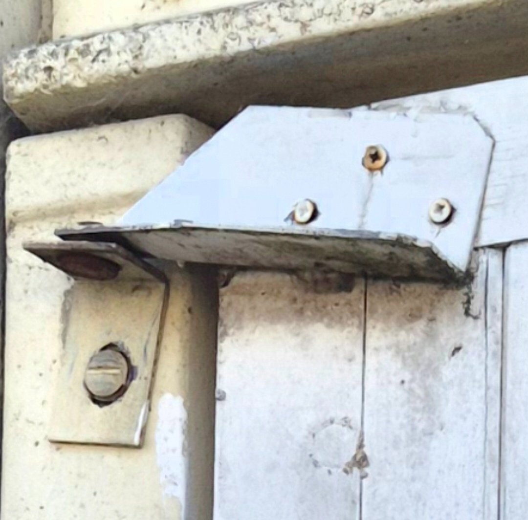

Hello, looking for some advice and/or recommendations:
I have a sectional garage which has a side door, does anyone know what type of hinges these are? And where to get something similar ? Or go with a different type?
The bolt goes through a pre-cast hole with a nut/washer on the inside.

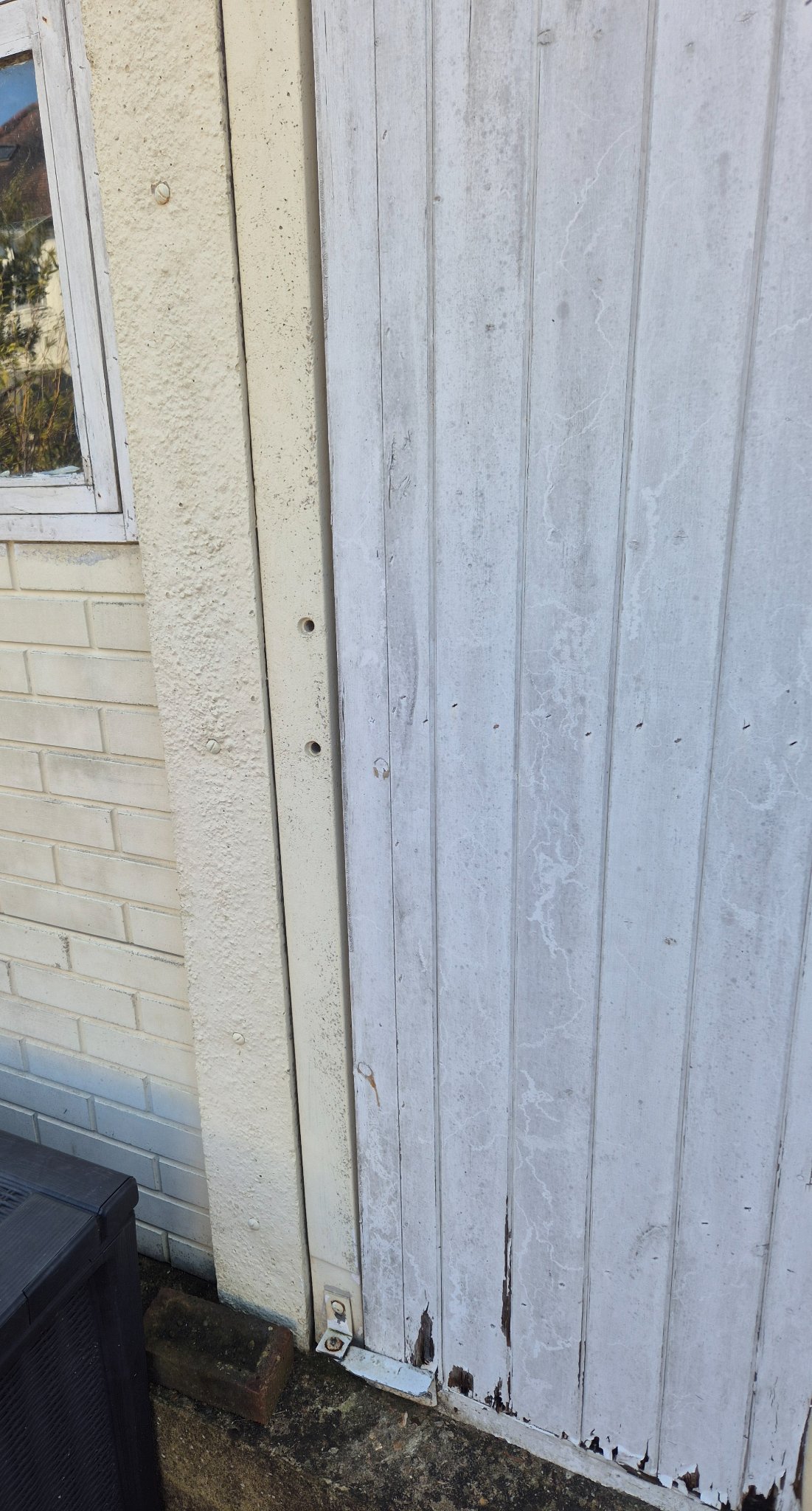

There are 2 un-used holes half way up which I'm thinking of using, but again any recommendations on a hinge type that can be bolted ?
Any help appriecated.

They look as if they have been made specifically for, or by the garage manufacturer, which leaves you with sourcing from the garage manufacturer (unlikely), or adapting something ready made.
Maybe something like this https://www.woodworkersuk.co.uk/cranked-band-and-gudgeon-hinges/
Or something like this - https://www.dciron.co.uk/products/fgh130
How secure do they need to be, against break-in?
Thanks for the quick reply, you have confirmed my suspicion that they were likely bespoke. I've no idea who made the garage, let alone if they are still in business!
I'm thinking to reuse them after a bit of TLC, new bolts, double nuts etc. Then trying to find a gate hinge that I can modify to attach using the spare holes half way up.
The door is at the bottom of the garden, security not a major concern.

They often cast the makers name, into the inner face of the concrete panels.
I would lose the hinges and use the holes you have to secure a timber down the front edge allowing you to use timber T hinges.
This is the revised plan, will probably need to notch the post at the hinge locations so the door stays flush. The bolt holes at the top and bottom to secure the post will need to be sunk as the hinges will need to be installed at the same locations.
Hinges can be placed well away from post fixing .The hinges would not be placed on the sand face as the screws securing the timber .
