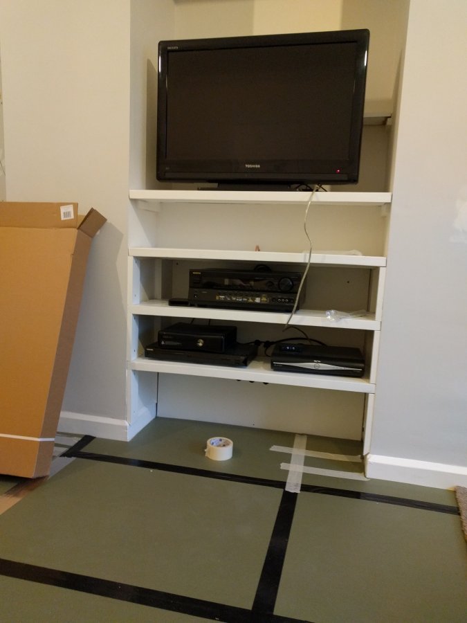

I have a recess in our chimney stack, that is big enough that our TV etc fits in, we are in the throws of redecorating and have decided to conceal the DVD player etc by building a cupboard, our aim is to make bifolding doors. To enclose the existing shelves.

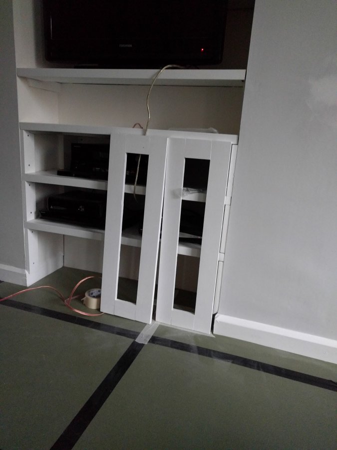

This is where the TV is, the doors are going to be from the 2nd shelf to the floor

nice job
is the skirting forward off the face off the frame??
this may stop the doors going to the floor and opening beyond about 120 degrees??
ahh ok the doors cant be recessed so the hinges will have to be face mounted so the doors cant go to the floor without removing part off the skirting or building the frame forward off the face off the skirting or stop the doors above the skirting
Oh also, once the flooring is laid I can plug the stereo together and that wire won't be there, it's just temporary so can still use the sky box without plugging the amp in.
you will have to raise the doors above the skirting
why not make a base at the level off the top off the skirting for the bottom off the doors to sit against
with timber underneath set back around 50mm
