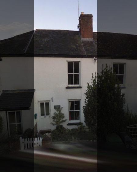

Hi guys,
Im thinking of selling next year and want to make the place look more 'cared for'. The outside is white painted tyrolean render and is starting to look a little tatty (no idea when it was last painted - probably many many years ago). Im a complete novice at this, but I think a couple of coats of good quality external paint will make the place look really nice.
Im going to get some quotes, but Id like any advice you guys have on what to ask a decorator (what type of paint they use, what methods, credentials etc...).
Unfortunately Ive missed all the sunny weather, so I presume its going to be a lot harder in cold/damp conditions (impossible?). I drove past another cottage that was being painted using some sort of spray. Is this the fastest/cheapest way of doing it? Will they have to use scaffolding to do it, or will they just use ladders? (its a small terraced cottage. I presume if they need to hire scaffolding then it will be much more expensive).
Any advice/suggestions appreciated.
They can normally do it off a ladder, what colour will you go for?
Post a picture of the front of your house.

Id like to go for white. Im mid terrace, and the neighbouring properties are looking pretty tatty too. I was thinking of asking them if we all get our houses painted together (we might get a discount) but theyre both elderly neighbours, so I doubt they will have the money/inclination.
What do you think? Do you think they can just use ladders? What do you think the sort of cost Id be looking at and what factors will play on price?

Just seen your photos,
Ladders should be OK, but above the Porch might be a problem.
The Decorator might want to use a Tower system for safety.

Ive made a decision on the deocrator. However, I just wanted to get your thoughts on this: My neighbour who has lived next door for 30 years has said that the terrace has got a lime wash on it, so normal exterior masonry paint will just crack because the cob walls will expand/contract. The decorator has said he'll be using Dulux Weathershield Masonry Paint. Do you think this will suffice?
If its got a lime wash on it, i doubt very much if its tyrolean - it would be a lime render which is much more likely on a cob building (bit unusual for surrey)? so you need to establish whats what, its a no no to put weather shield over lime thats for sure. A cob building needs to breath as they are very sensitive to damp which is why a lime render is applied which needs a lime paint. Did you tell the painter its a cob building?, if so he should have picked up on it so he may not be the right man for the job.
The photos of the property seem to have disappeared, but it seemed this was a terrace property and in the region of 1940`s, so not a cob building.
I would have thought a pressure jet clean off of the rendering and a coat of Stablising solution prior to a Water based masonry paint would suffice
Needs further investigation though to ensure what the rendering is.
