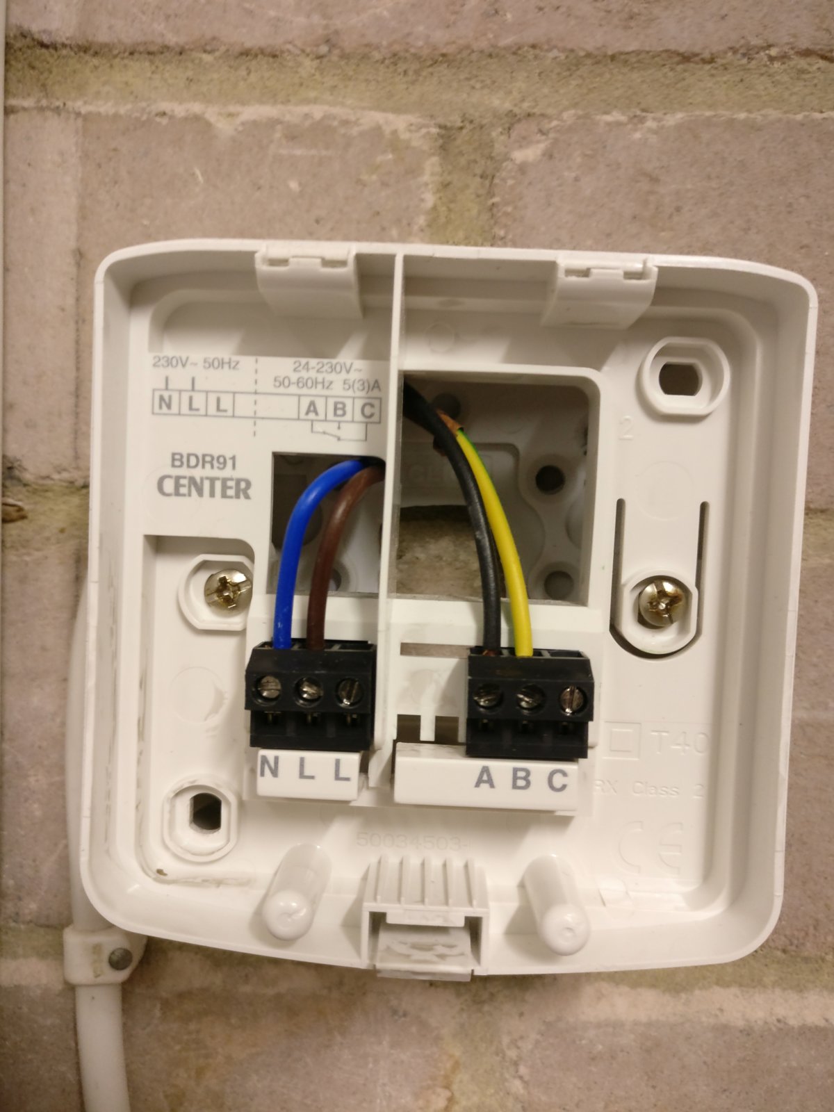

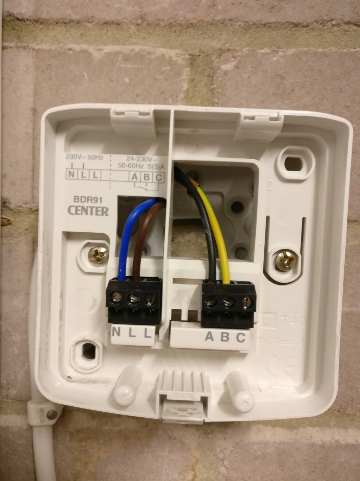

Hi,
I'm trying to replace a Plumb Centre wireless thermostat EHE0200361 on a combi boiler with a Hive thermostat. The current thermostat has Neutral, Live, A and B connections. I take it one of these is the permanent and the other is switched live, but what do I use for common? Also there is no earth connection at the moment. I will try and upload a picture.
For the single channel version of the Hive, the live and neutral wires from the EHE0200361 go to the corresponding terminals at the Hive receiver. The black wire in A goes to Hive terminal (1) 'Common' and the green/yellow wire in 'B' goes to Hive terminal (3) 'Heating on'
It's not good practice to use a green / yellow wire as a live conductor, which as you have noticed leaves you without an earth wire. However, there is no earth connection required by the Hive it is double insulated. The tether provided on the Hive backplate is just there to park it out of the way if there is one.
Thanks that's what I thought.. Green and yellow are earth cable colours. What colour should the switched live be out of interest? I will put some tape around the cable.
Looks like it already has either a bit of brown sleeving or tape added by the original installer to identify it as a live. That's better than some do, but it's still not good practice to use an earth wire for any purpose other than as an earth. It's OK to use a neutral as a live provided that it has a brown sleeve on to identify it, tape on the other hand is not good practice as it can fall off.
Brown is usually used to identify a live, permanent or switched, but obviously with multicore cables other colours have to be used, because if there were more than one brown wire in a single cable you wouldn't know which was which at the other end.
Thanks for the advice. I will have a go at installing the thermostat tonight.

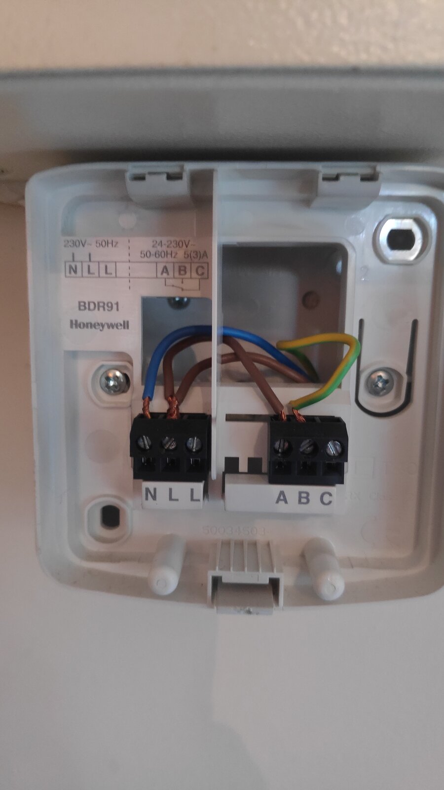

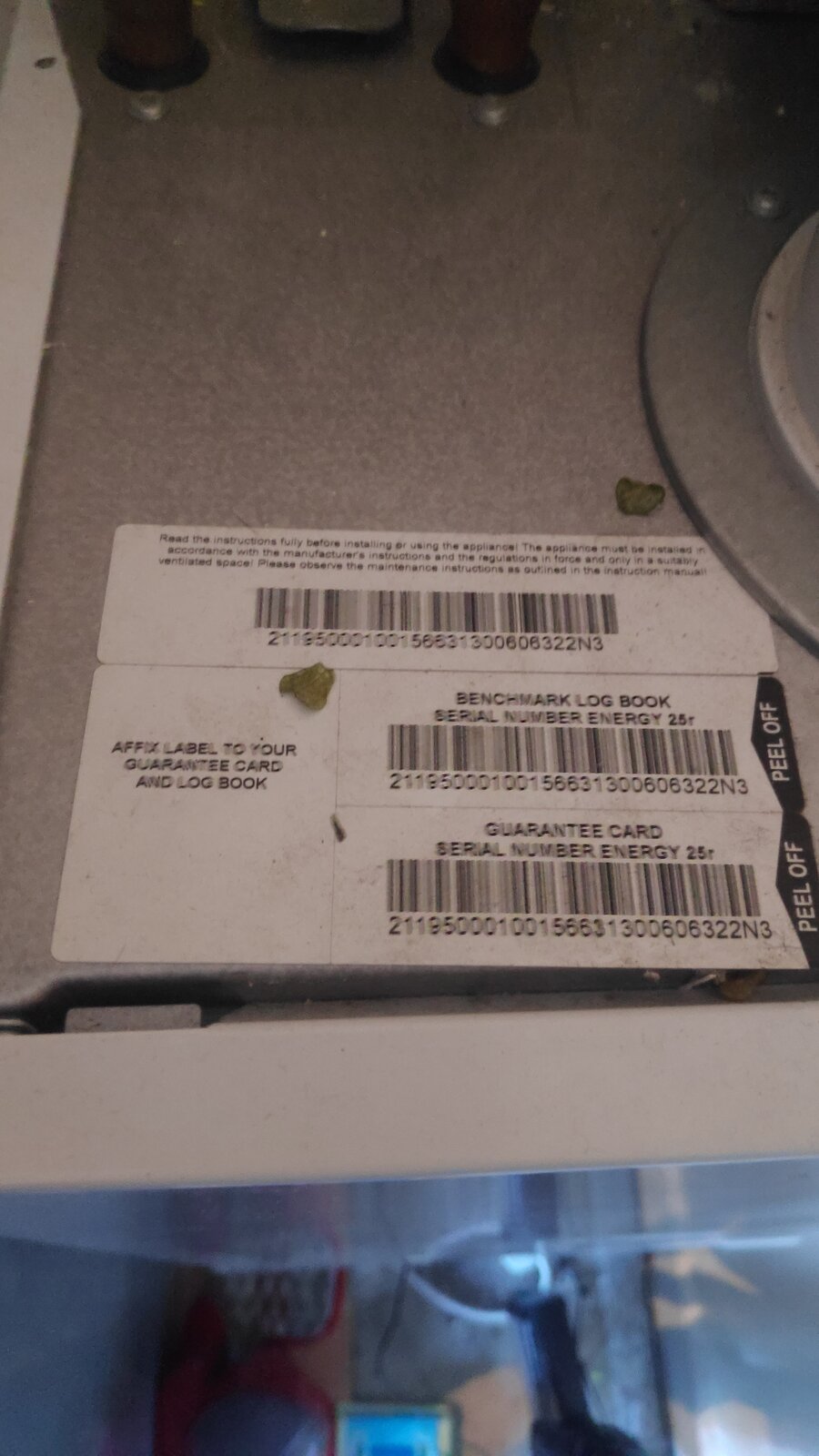

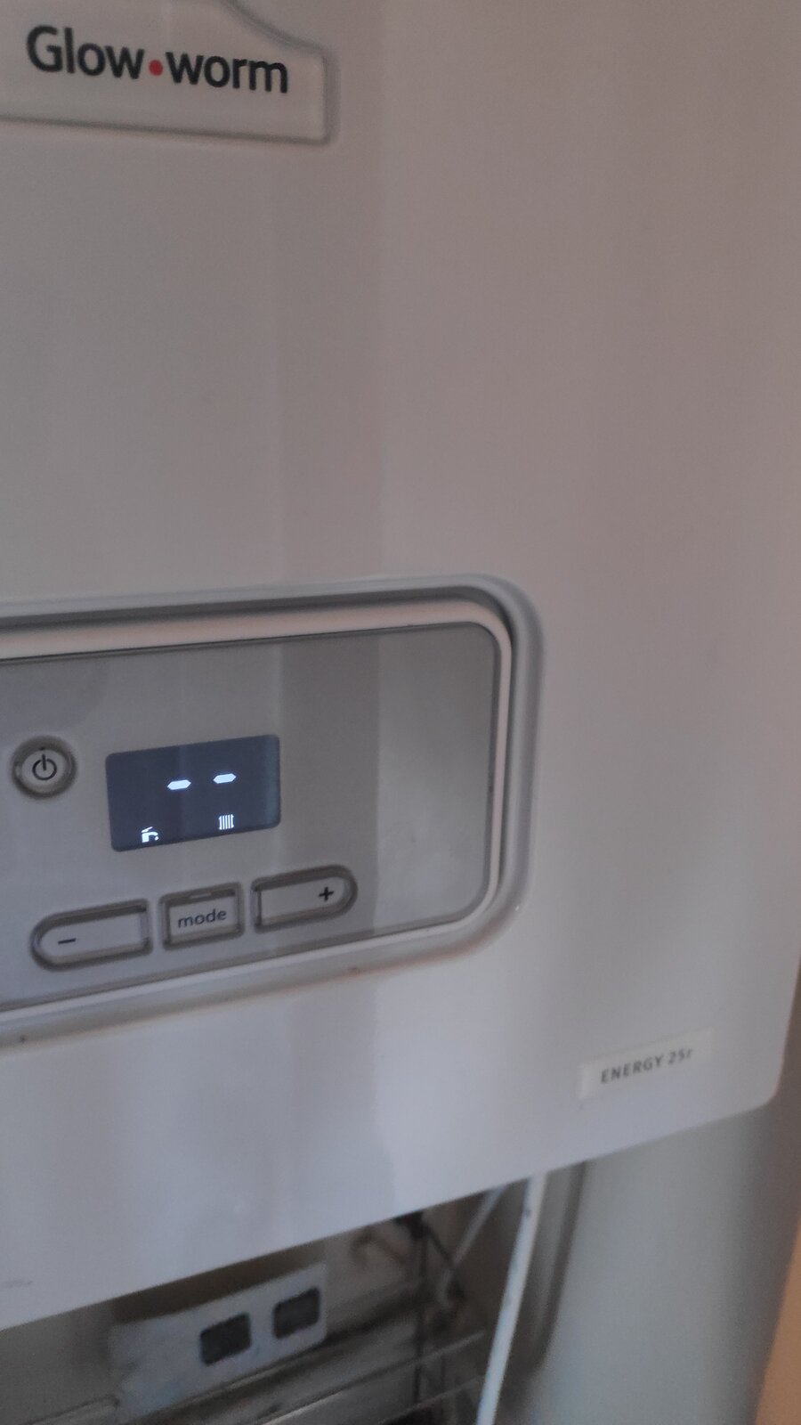

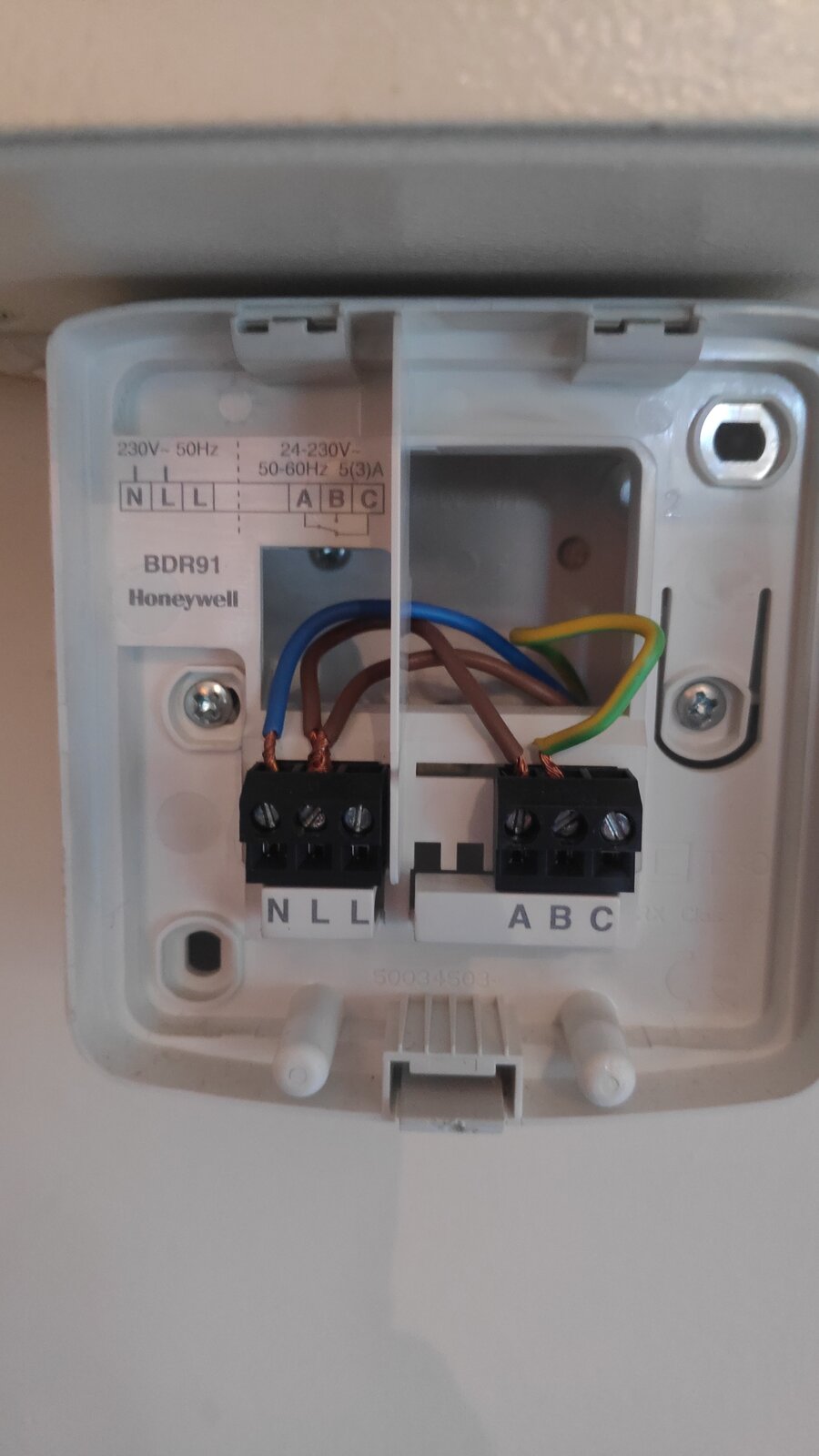

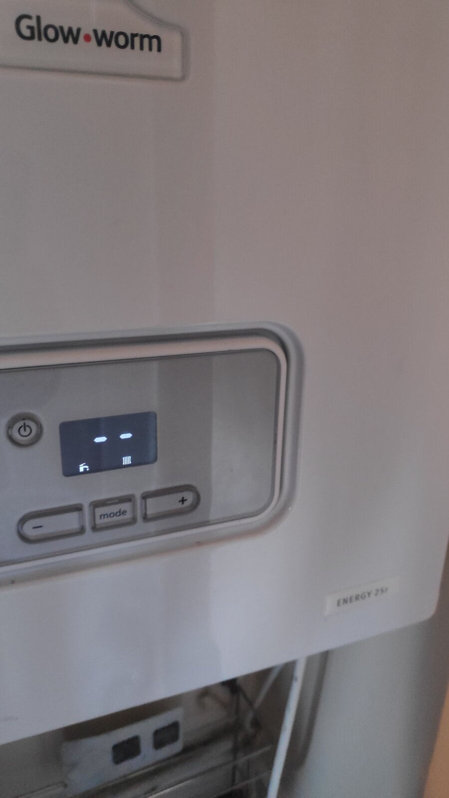

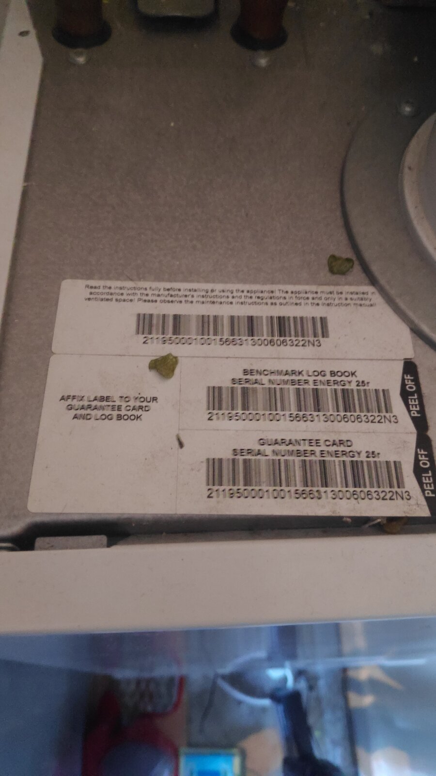

Sorry for bumping this again. I have a Honeywell EHE0200361 and the controller has finally died. The auto/manual/ off buttons don't work, I stripped it down and found residue on the board around the buttons. I cleaned it up and it worked fine for a fews weeks but it has finally died.
I am going to toss it and upgrade to Hive. I just need a little guidance on which one to get. I am fairly sure I have a heat only boiler (glow worn energy 25r) that also heats a tank upstairs for the hot water.
I was going to get the following "Hive Thermostat for Heating and Hot Water Control (Conventional Boiler) without Hive Hub"
Any guidance is much appreciated.
Adam.
It's always better to start a new thread, rather than bump an old one (it's even against forum rules!).
Anyway, what you show in your photo is the thermostat.
If you have a heat only boiler, you probably have a programmer.
The Hive for Heating and Hot water would replace the programmer. The thermostat would then be linked out and/or removed.
Do you have pictures of the programmer and its wiring?
Also, if you want control of the Hive from your phone app (makes it easier to set schedules etc.), you would probably also want the Hive hub - unless you have one already.
