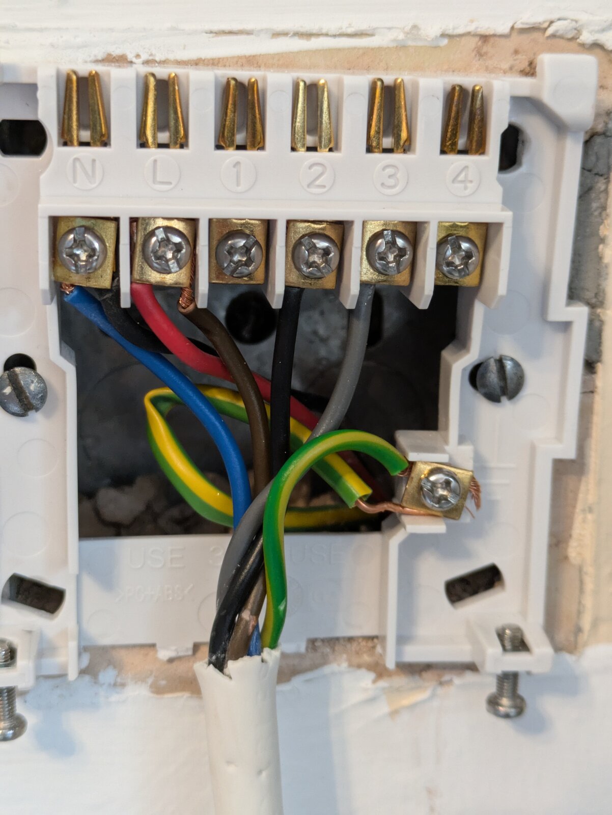

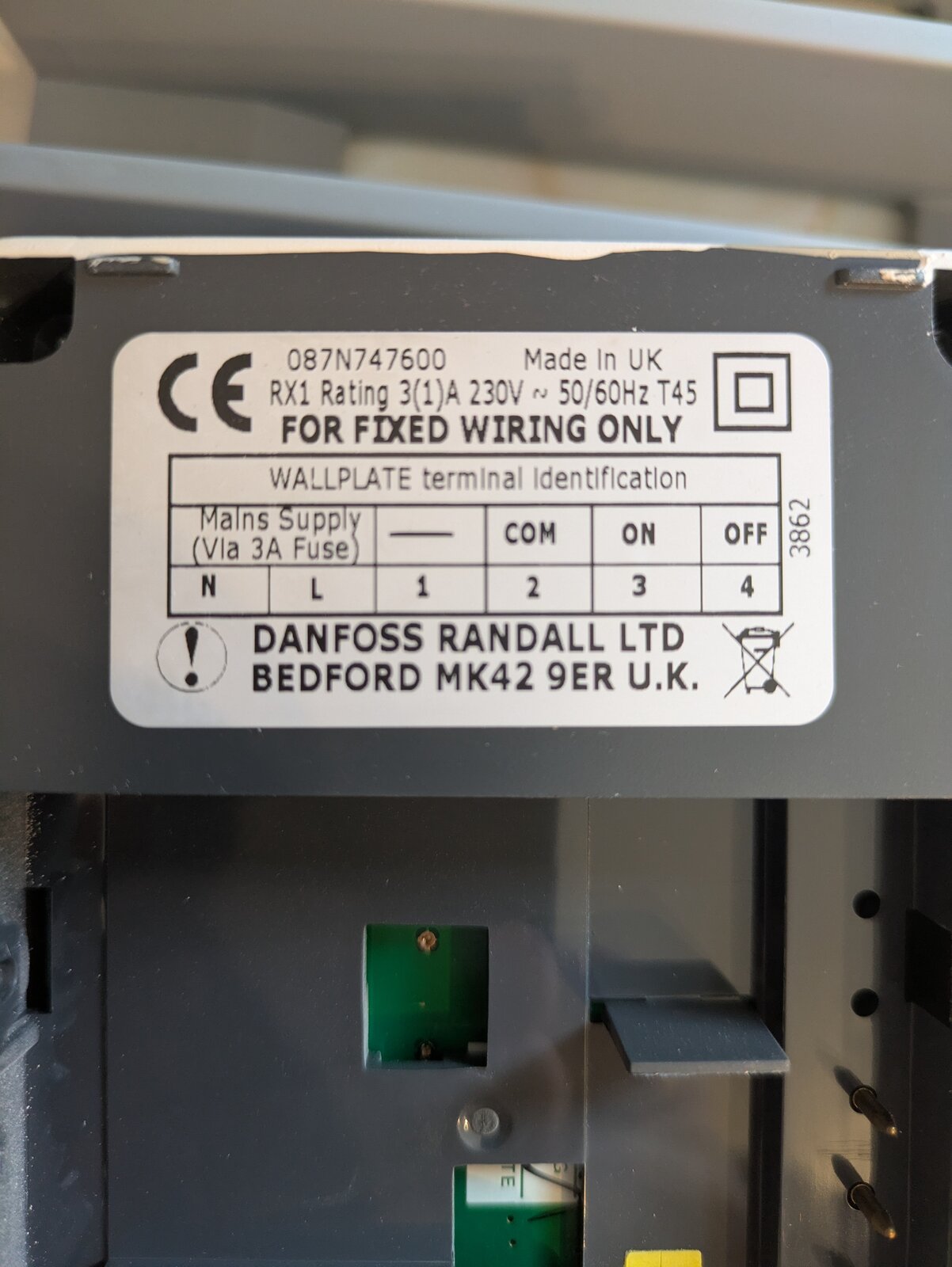

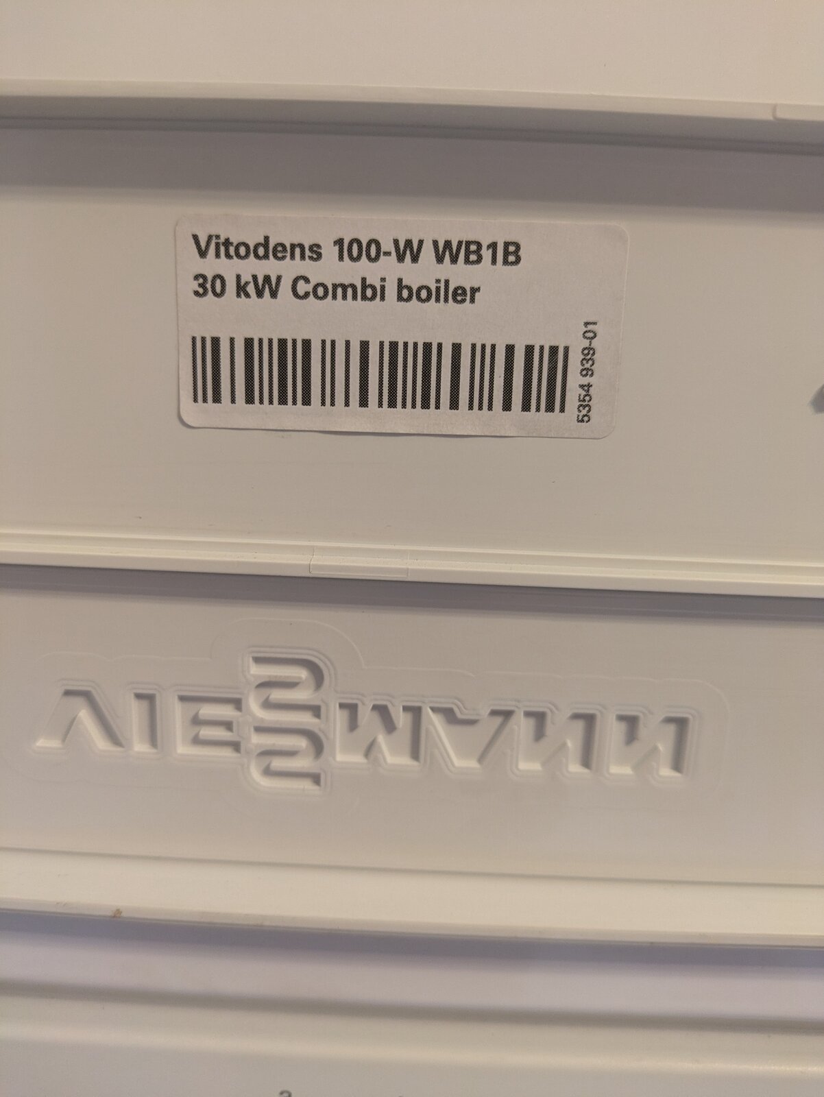

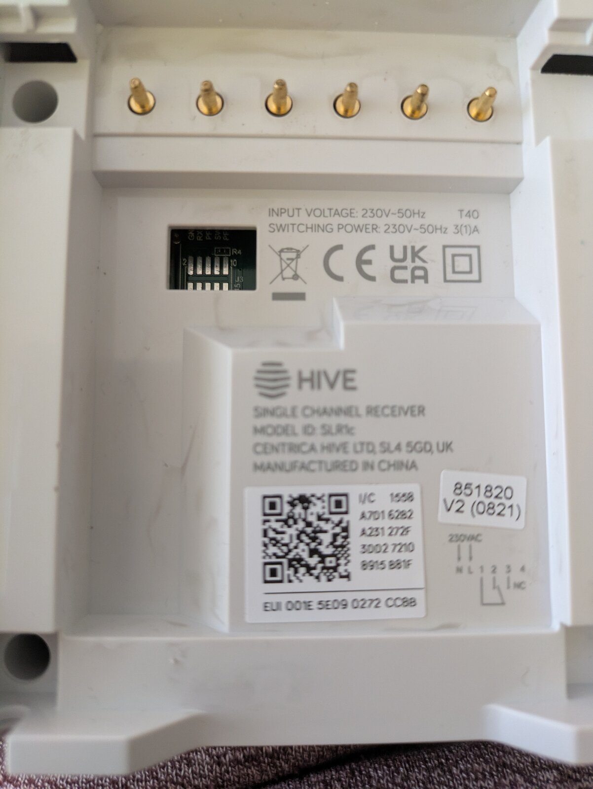

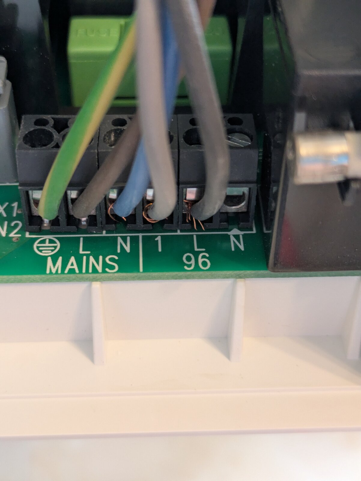

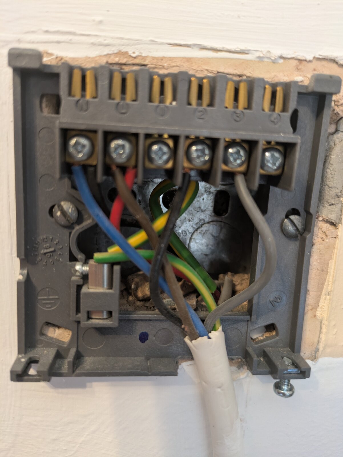

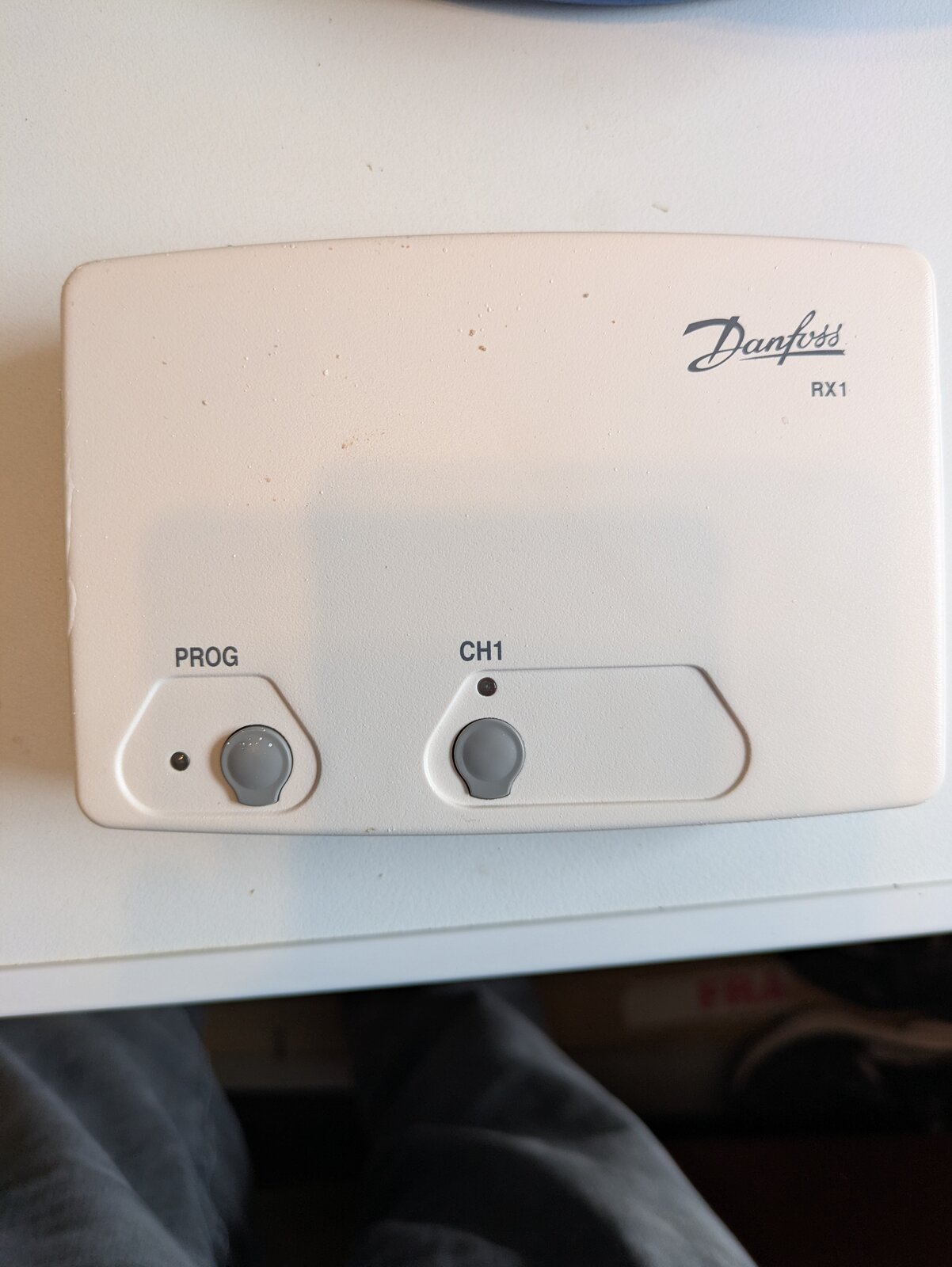

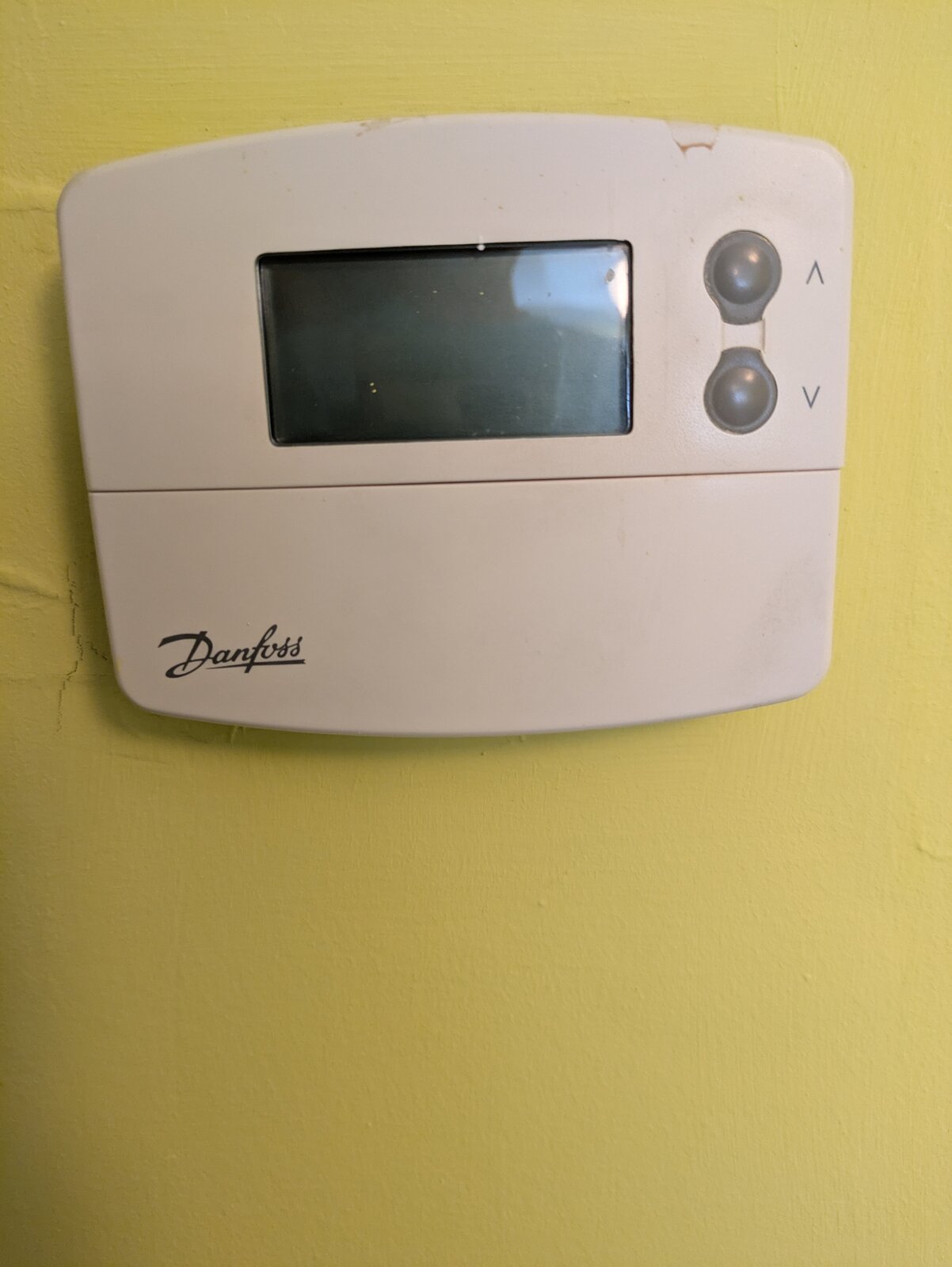

Hi, my son has just bought a new to him flat. It has a Viesmann v100 boiler in it controlled by a danfoss RX1 system. We decided to fit a hive system to it. I have looked through other threads on this forum and looked at a few videos on youtube and came to the conclusion that I should wire the hive backbox the same as the old Danfoss. However when you ask the boiler to come on the light on the Hive lights up but the boiler doesnt fire up. I presume I have misplaced a wire somewhere? Anyway I am uploading pics on this thread to show what I have done. Would really appreciate you all taking a look and pointing me in the right direction. I thought the boiler end looked wrong but that hasnt been touched by me.
