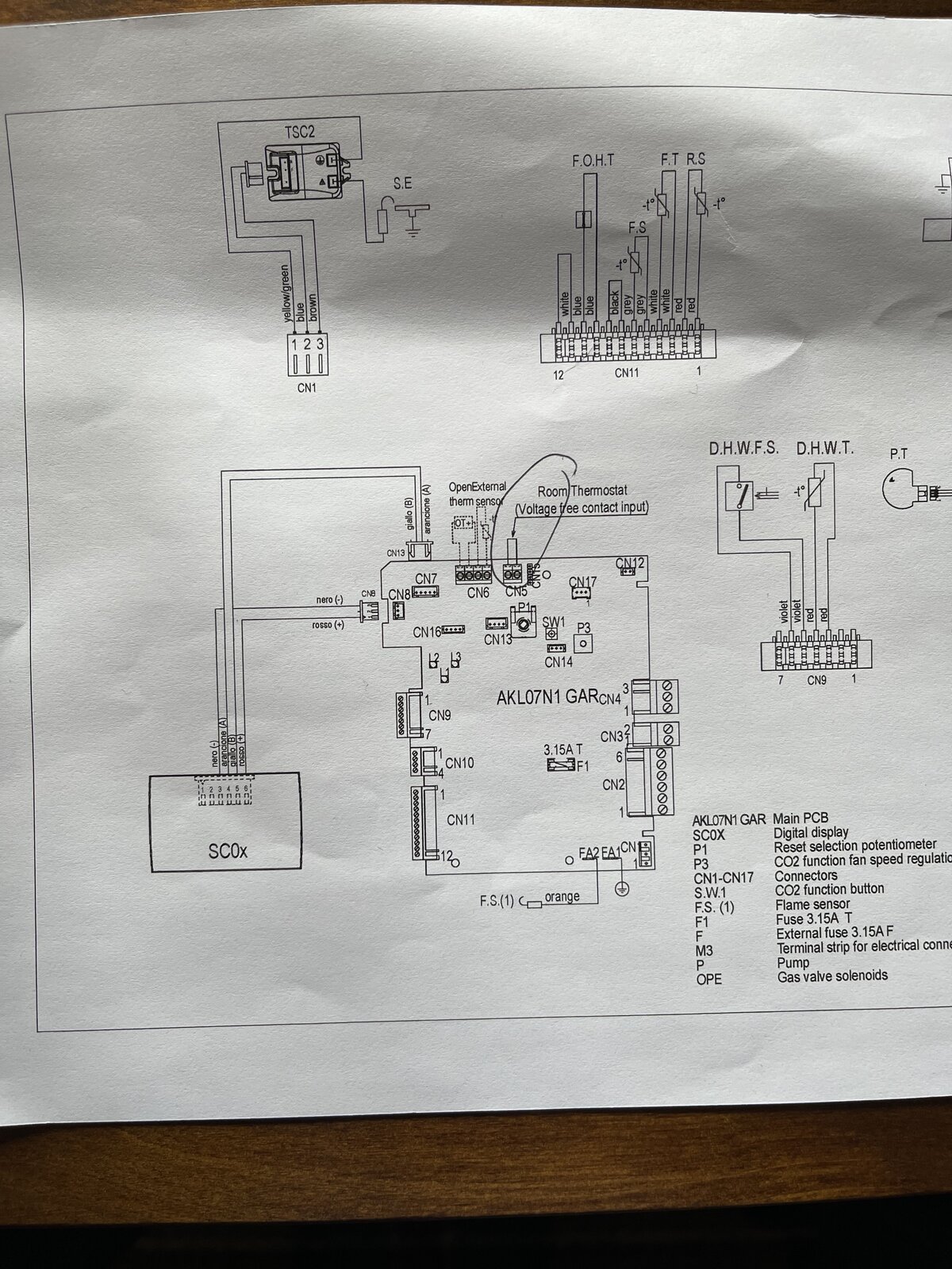

Hi I am about to fit a hive receiver to the Vokera vision 30c. Just want to check it is to the connections at CN5 not CN6.
Yes, CN5.
You must have a single channel Hive.
The connections to CN5 must only be made to terminals 1 and 3 on the Hive.
Do not make any additional links on the Hive, that you may see on other installations, or you may be in for an expensive bill, when changing he boilers PCB!
