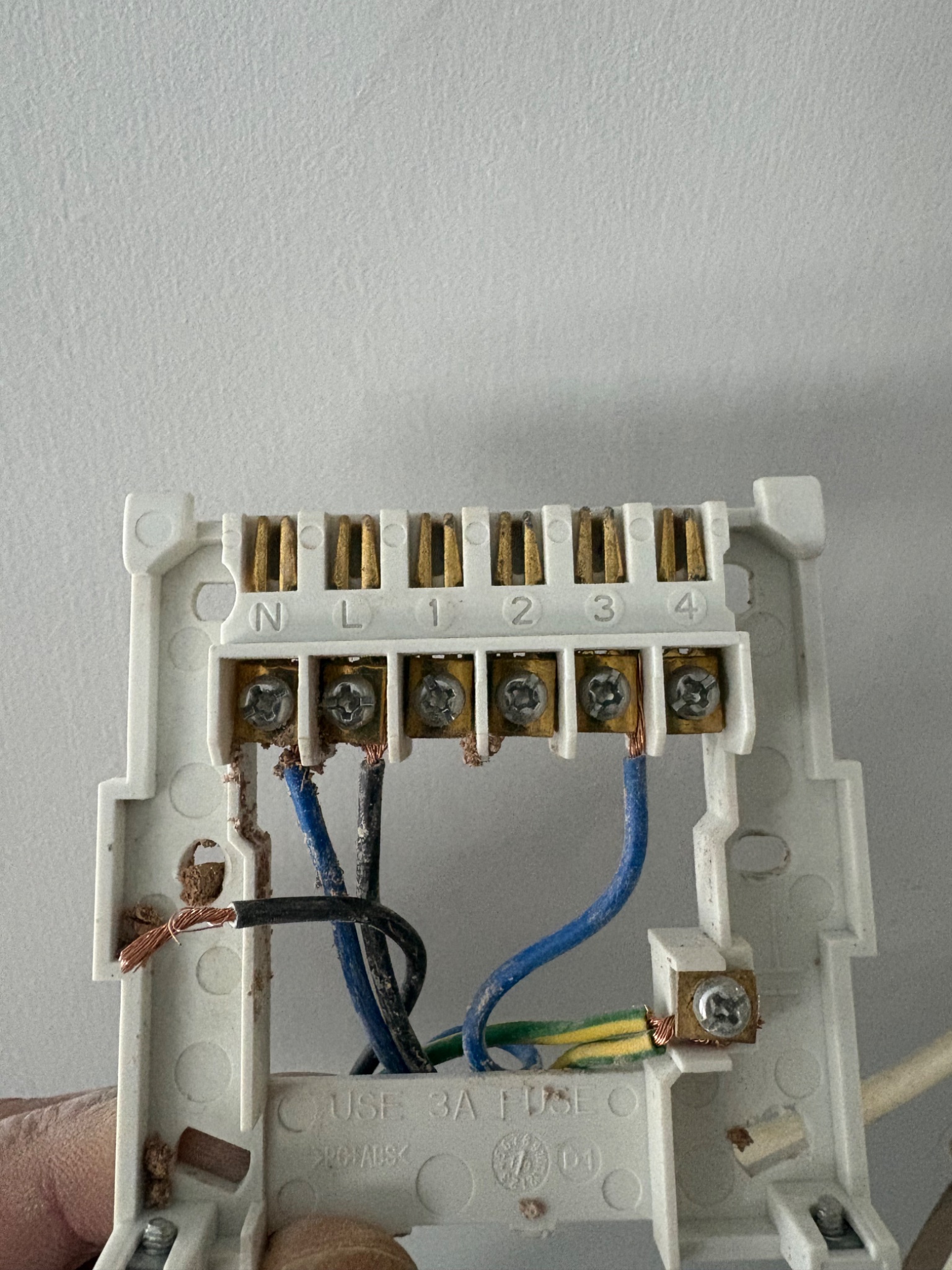

Hi I’ve accidently knocked out a wire out the Hive receiver. It’s a dual controller for heating and hot water - but where do I reconnect the wire that’s come out please? Thanks in advance.
What is that (what looks like a) lump of loose wire between 1 and 2,?
Thanks mate. Yes power was off when I did it. I couldn’t tell which terminal it came out of but a previous reply was the correct one - terminal 4
