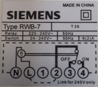

I am trying to wire up my new Hive Dual Receiver but cannot get Hot Water to work correctly.
First i think i am correct in thinking i have a gravity fed central heating system. Cold water tank feeding copper cylinder with three way motorized pump or perhaps a y plan system??.
My present programmer is a Seimens RWB7 which back plate looks very similar to the new Hive ,
My problem is wiring as follows Blue wire to "N" Red wire to "L" Green wire to "E" earth. i only have one wire left Black which wires to No 4 terminal which shows as heating On. There is no wire for No 3 terminal Hot Water on. There never has been but a link wire from "L" to No " terminal and everything has always worked fine.
Now when wired the same to Hive Receiver i cannot get the Hot Water to come on, the light comes on for Hot Water but the Boiler does not fire up.
Of coarse when Heating is on the hot water does heat but as soon as the thermostat cut out the boiler is not heating the hot water.
Now on reading Hive instruction for changing to Gravity fed system receiver light turns Blue as it should and when Hot Water is put on Central Heating light comes on aswell and Boiler kicks in along with pump.
I just keep thinking there should be a wire to No 3 terminal for Hot Water On.
Help Please ? Many Thanks Rich!

The RWB7 is only a single channel timeswitch. The Hive is a dual channel timeswitch, they are not compatible.
Does the RWB7 control the hot water and central heating 'on' and 'off' times?
Hi! Yes the Programmer does control hot water and heating on and off times we just turn thermostat down to have water heat only. thanks for your reply Rich!

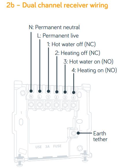

The Hive has two outputs, one for heating and one for the hot water. It appears that the existing set up is that a both heating and hot water are connected to the same wire from a single channel timeswitch.
The existing programmer (aka time controller in the diagram below) should really be a dual channel with separate channels for the heating and hot water if you have a Y-Plan with a 3-Port motorised valve, as you can see from the diagram below.
So to use Hive, the system will require rewiring.

You will need to split the wiring currently shared by the heating and the hot water so that they are separated and not supplied from the same source.
A wire should connect terminal (3) of the Hive 'Hot water on' to the hot water cylinder thermostat's call for heat terminal, and a wire from terminal (4) 'Heating on' that goes to the white wire of the 3-port motorised valve. [You should be able to use the existing black wire for one of these, but if you use it for the hot water, you will need to disconnect if from the heating wiring. If you use it for the heating, you should disconnect it from the hot water wiring]
The Y-Plan also requires a wire from terminal (1) 'Hot water off' that goes to the Grey wire of the motorised valve.

I deleted some of my previous post before you replied that made reference to 'hot water off' missing from the existing timeswitch. Which. after I posted it I realised with your current set up (heating & hot water 'on' and 'off' together) will only presently come from the hot water cylinder thermostat, so it's not relevant to the current set up. However, once you separate the heating and hot water you will need a 'hot water off' from the Hive. So, my comments about terminals (1) (3) and (4) above are still relevant.
