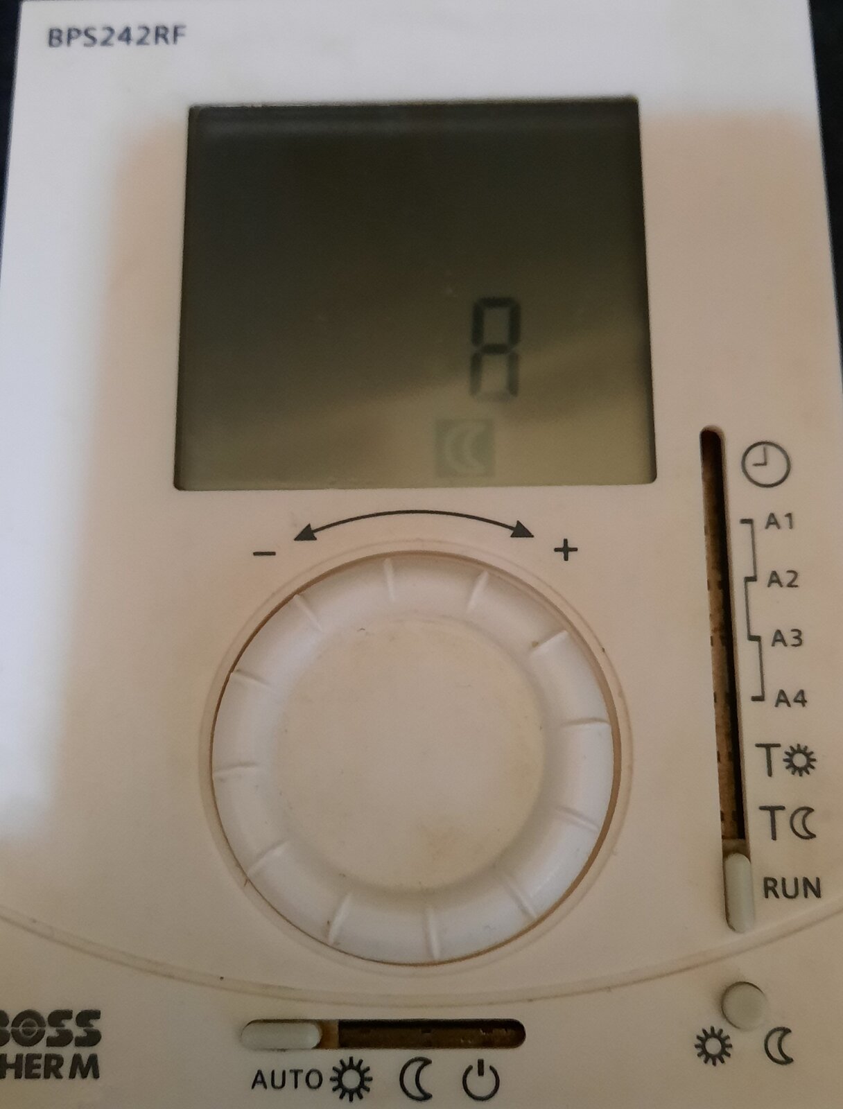

Just get someone to double check my research into the wiring as planning to move to Hive (single channel).

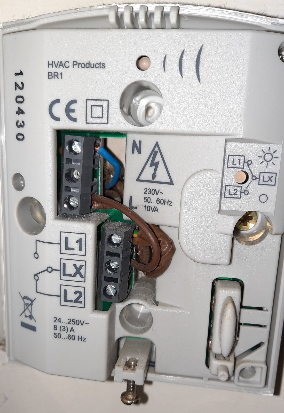

I have a Worcester 28i junior boiler with
BR1) receiver (wall mounted - picture 1&2) & remote thermostat (BPS242RF) which is not working hence the heating system but still have hot water in taps

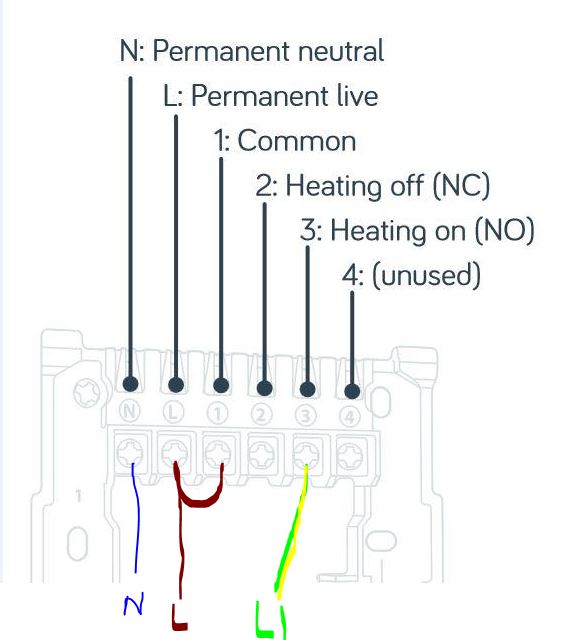

I just wanted to check my working:
Siemens N (blue wire) = Hive N Terminal
Siemens L (brown wire) = Hive L Terminal

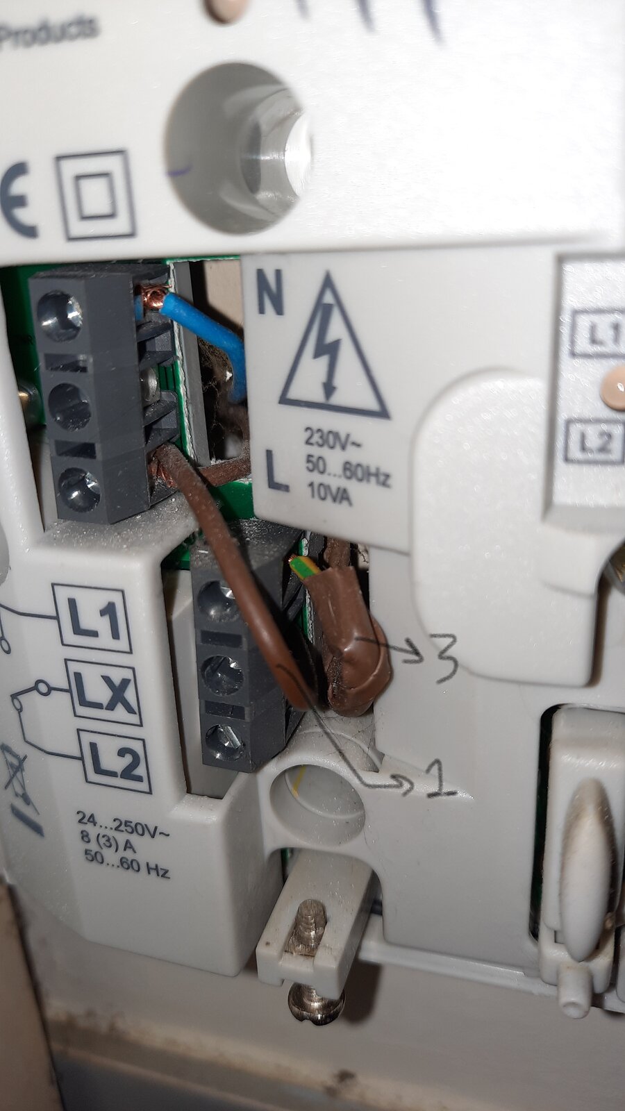

Siemens LX (brown wire) = Hive Common Terminal (1)
Siemens L1 (yellow & green) = Hive Heating ON Terminal (3)

Yes as you have shown, however since the green/yellow has been over sleeved and used as line, it means an earth has not been taken to the thermostat.
Although Hive may be class II and does not need an earth, the regulations say an earth wire should be run to it even if not used.
like this
and i can't see other wire for earth does it mean my current / hive aren't compliant?
Yes, like you have shown. It’s just not to current regulations regarding the Earth wire.
