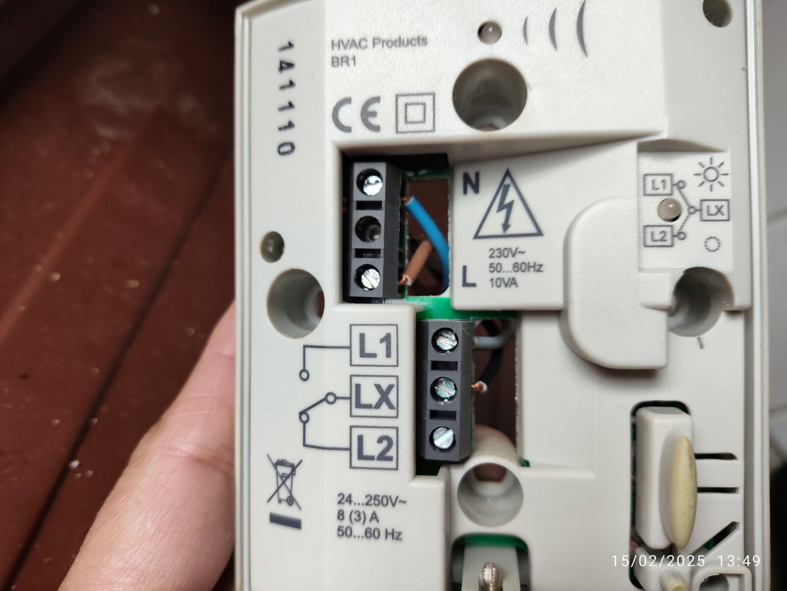

Hi all,
Need expert advice on the wiring.
Current setup​
-- Worcester 25i Combensing Boiler
-- BOSS BPS242RF BR1
New setup​
-- Hive Mini Wireless Heating Smart Thermostat

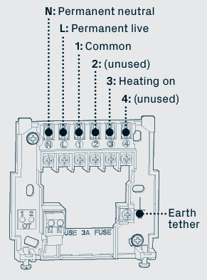

Is my boiler a Single channel standard relay wiring or Dual channel Receiver wiring as menetioned here >> https://assets.ctfassets.net/mijf9l...e_Thermostat_Mini_Installation_Guide___1_.pdf
How do I connect the existing wiring to the new Hive ?
BR1 N (blue wire) = Hive N Terminal
BR1 L (brown wire) = Hive L Terminal
BR1 L1 (grey wire) = to which terminal ? Hive 'Heating ON'
BR1 LX (black wire) = to which terminal ? Hive 'Common'

Existing is a single channel, so that’s all you’d need.
Yes that’s it
