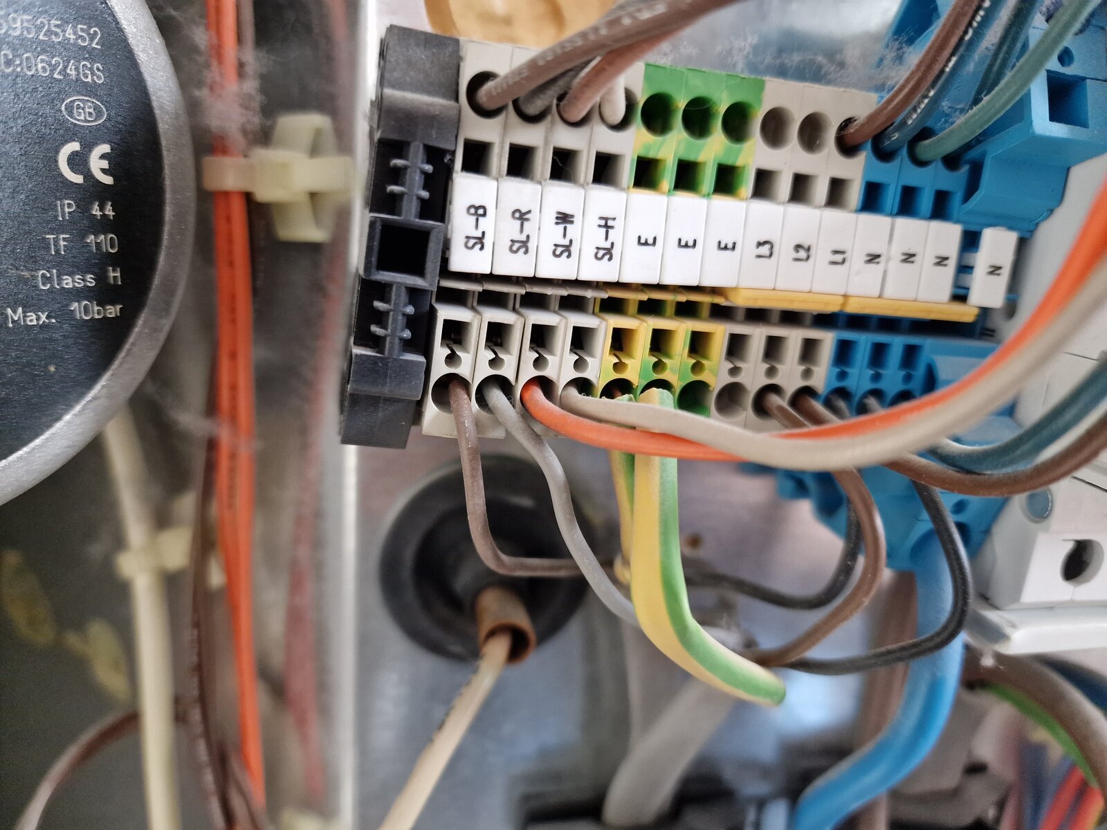

Hi all. Fitted my hive a few years back, but only to the heating side of things. After a lot of testing, it's clear that the boilermate is more efficient when it is only heated when needed. Though the summer I set the timer for a couple of hours each morning and this leaves plenty of water for the day with reasonable gas usage. Obviously in winter it needs to be charged to run the heating so now want to connect the hive hot water side.
From the wiring diagram (http://www.gledhill-spares.net/documents/BMAClassOV-Iss8.pdf), it looks like what is needed is to disconnect the existing front panel controls (clock and hot water / heating switches) and instead connect the hive where they were originally connected.
Following the wiring diagram, the current connections to Sl-W and SL-H lead to the rocker switches. I believe I need to disconnect these (and the associated live / neutral that goes to the clock) and connect them to the respective terminals on Hive
(CH on / HW on) and also connect SL-R to L2 in place of the existing connections to Hive.
Thanks in advance for any pointers.

Yes that is how you do it , but you would have been better getting a single channel hive and always leaving the store at temp for your HW, it will work what you are trying to do but not what that system is designed for, you might find your gas usage actually increases rather than decreases when you do this
Thanks Ian. Over the past year I've done a lot of experiments, left to do it's own thing, it will burn through about 14KWh of gas. Run for a few hours in the morning it's more like 8. Have got gas usage down significantly this way.
My plan is to put the hive into gravity mode which will turn the water aspect on when the heating is run so I can schedule the morning heat and it will heat when necessary when heating is on.
I do have one final question which may be better asked elsewhere. The boilermate has an emergency switch feature - basically a 6KW electric heater. I assume mostly the make up of the pulsacoil electric version (although I don't believe that one does heating). I'm on Octopus Agile and so considering using the switch mode to power it when plunge pricing is on, basically getting paid to run the heating. However obviously it's described as for emergency use possibly because who would want to heat it on electric without such a tariff. Is it likely to cause problems using it this way though. I've tested it and it works nicely, but is it a good idea long term. I'm considering putting a smart switch in to enable it automatically by a home assistant automation when electric prices are negative.
You will have to do that anyway or it wont work, but that is where the problem lays, the store must be up to temp for the CH to work, it is cheaper to keep the core up to temp than it is to , get it up to temp when it is cold, your heating will not come on until the core gets satisfied, really bad appliances , but it is what it is , if you can afford it , skip it and get a better system, if not, then stick with it but it will by design be expensive to run

Just to wrap this up. Came to do it and as I was sat in front of it identifying the wires, noticed a lot of corrosion at the bottom. It's leaking a bit so will get someone out to advise on its replacement.
Sad times.
