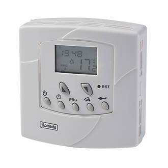

However my old DT2 thermostat only had for changes per day the replacement ae235.jpg slightly better with 6 changes, so although I have no problem with Nest Gen 3 setting multiple 0.5°C changes with other thermostats it may be a problem. I think there is a limit with the eQ-3 heads I use, but unaware of any limit with the energenie heads.
