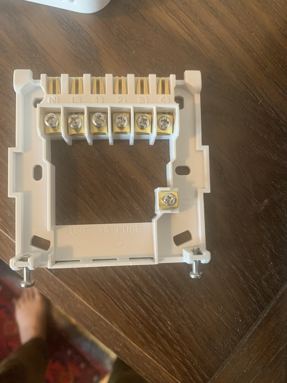

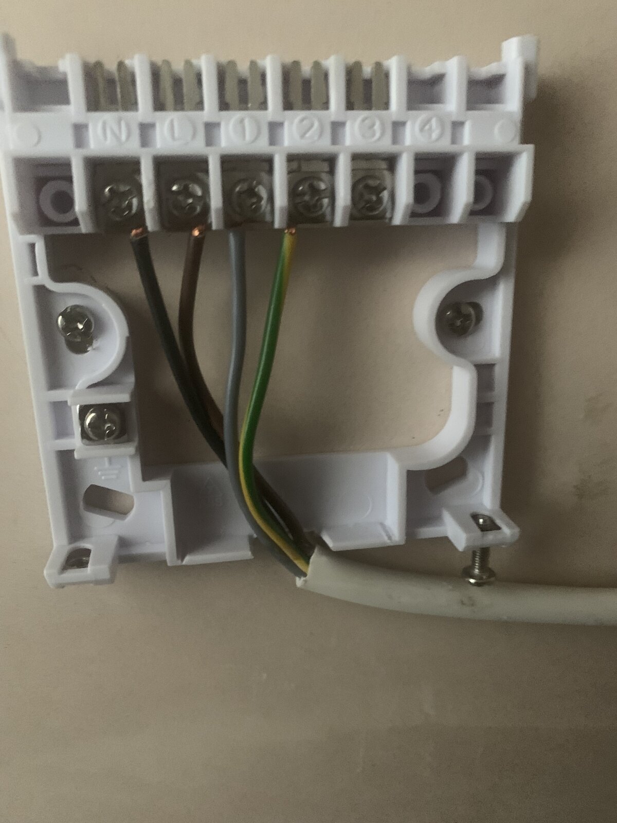

HI Ive just installed a hive thermostat and receiver but all is pairing ok but the boiler wont turn off , I just copied the existing plate that was there,
Sorry I only have 4 wires that
When receiver is told to turn off by stat does the green demand light go off ?
Photos of boiler would help
What was the thermostat that you replaced and did the boiler operate correctly with the old stat?
Could you post a picture of your wiring?
What am I doing wrong , this is the hive receiver

Sorry it does all pair but boiler won’t turn off, and everything is all green
no that was the old wiring , nope not moved any
OK, thanks for the confirmation.
Move the green/yellow wire to terminal 3.
The green/yellow wire (and the grey wire) should be marked with a brown sleeve to denote it as a switched live wire.
Hopefully, that should work.
