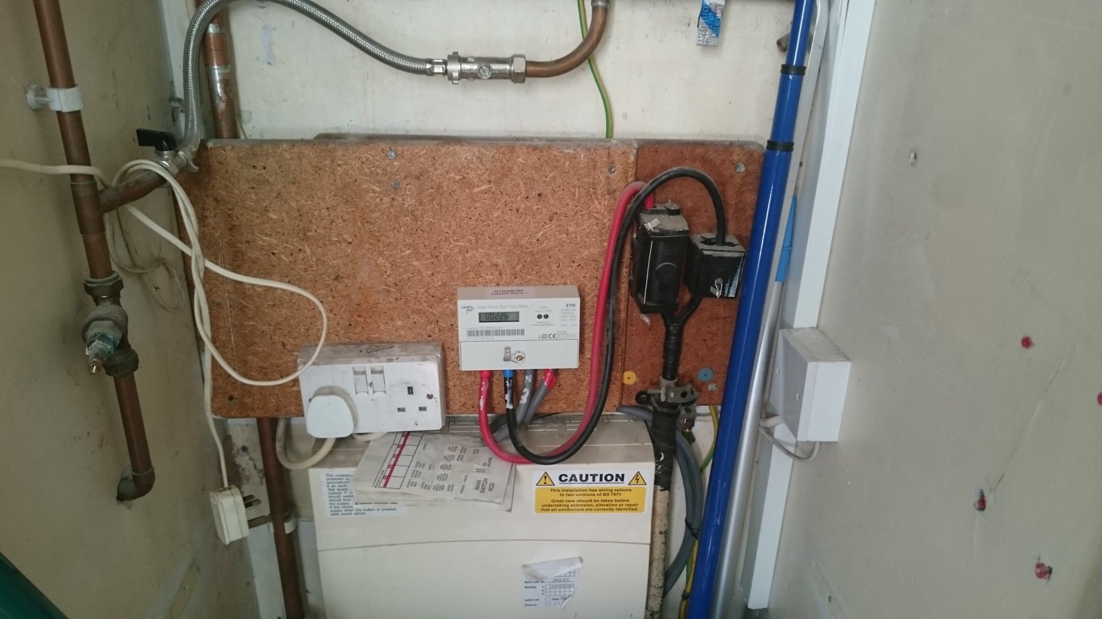

Hi,

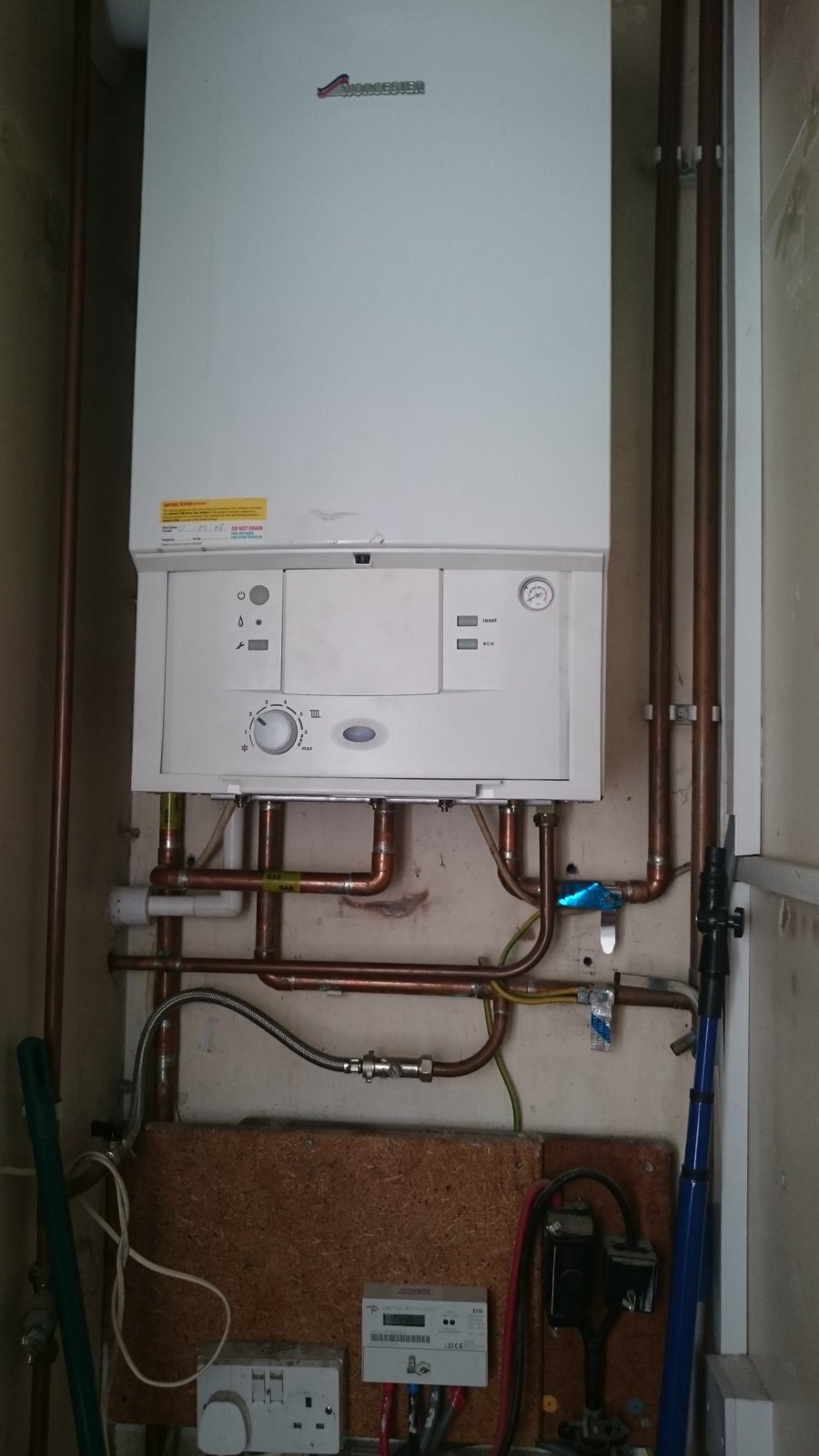

I am looking to install the Hive Heating Single Channel receiver.

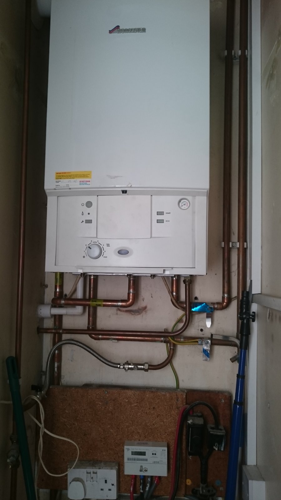

I currently have:
Worcester Combi Boiler Greenstar 24i Junior

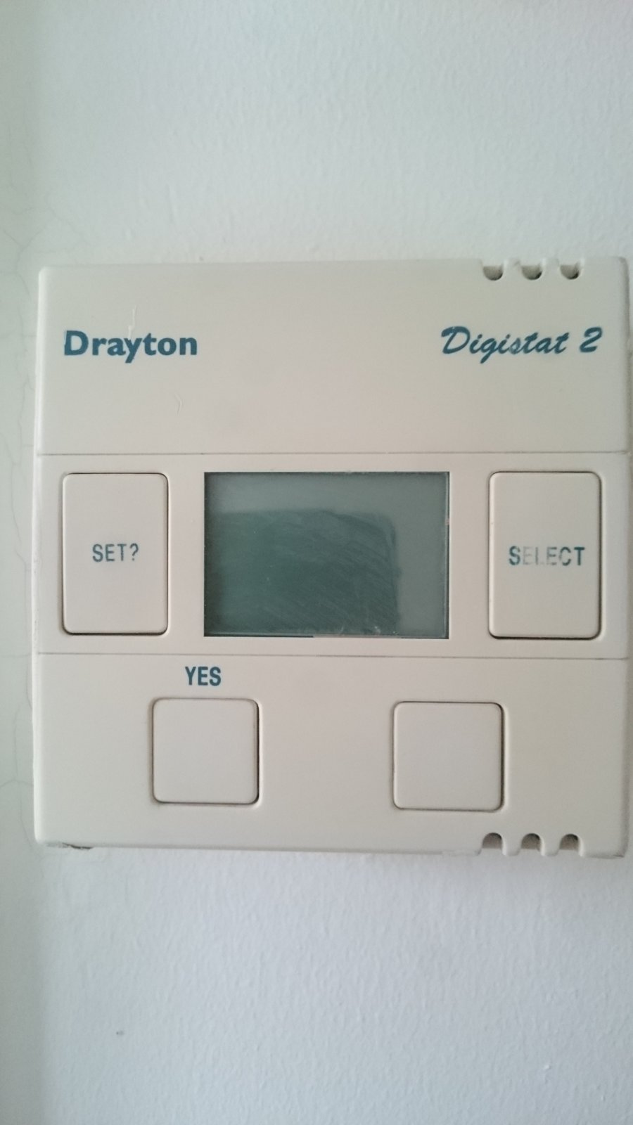

Drayton Digistat 2 Thermostat
(Please see the Photos)

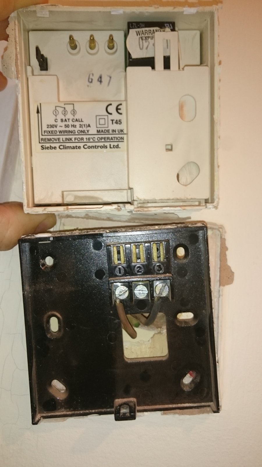

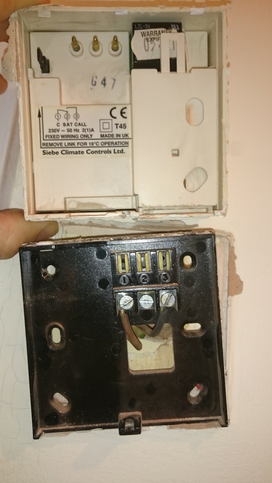

The Thermostat is wired straight into the Boiler and only two wires are being used:
Common (brown wire)
Call For (black wire)
There is an un-used third wire (green wire) behind the plate, but currently not screwed in to the thermostat, I assume that may be the Satisfied?

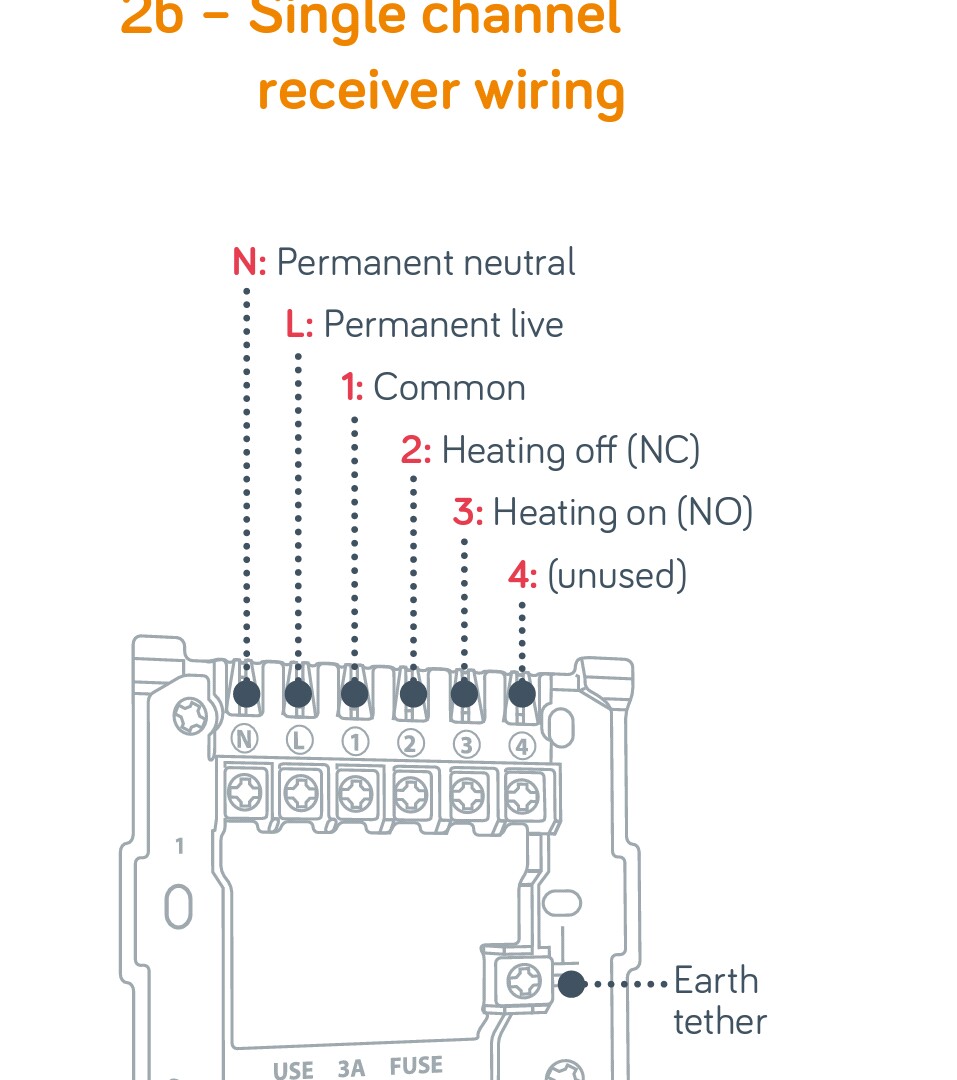

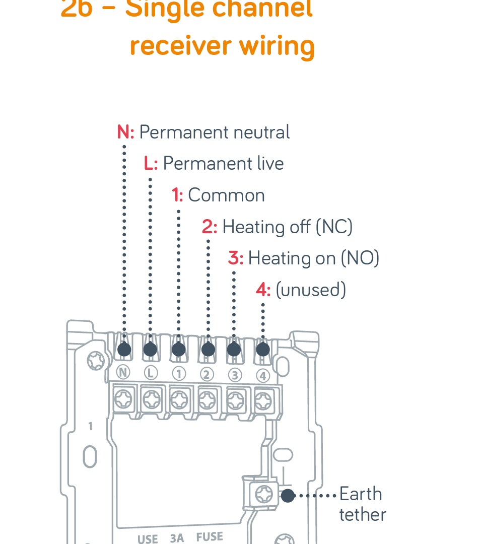

My question is, can I simply install the Hive Receiver using the currently used two wires?
i.e. Common into Hive 1 / Call For into Hive 3 and potentially Green into Hive 2
I assume I still need some power to the Hive Receiver as the current Drayton Thermostat has batteries?
Any help would be appreciated.
Thanks,
Marco

The two existing wires, would go to the terminals at the Hive that have the same function.
Common (brown wire)...Goes to Hive receiver 'Common' terminal (1)
Call For (black wire)...Goes to Hive receiver 'Heating On' terminal (3)
In addition, you also need a 230V supply to the Hive receiver Live (L) and Neutral (N) to provide it with its operating power. This should be connected to the boilers 230V supply so that the same fuse and switch supplies both the Boiler and the Hive receiver.
And that's it they are the only 4 connections you need.
The other wire is probably an earth which is not used. The Hive doesn't need an earth connection, so connect it to the Hive's Earth Tether which is provided to secure it safely out of the way. Under no circumstances connect it to any of the other Hive receiver terminals, if you do you risk causing some serious damage.

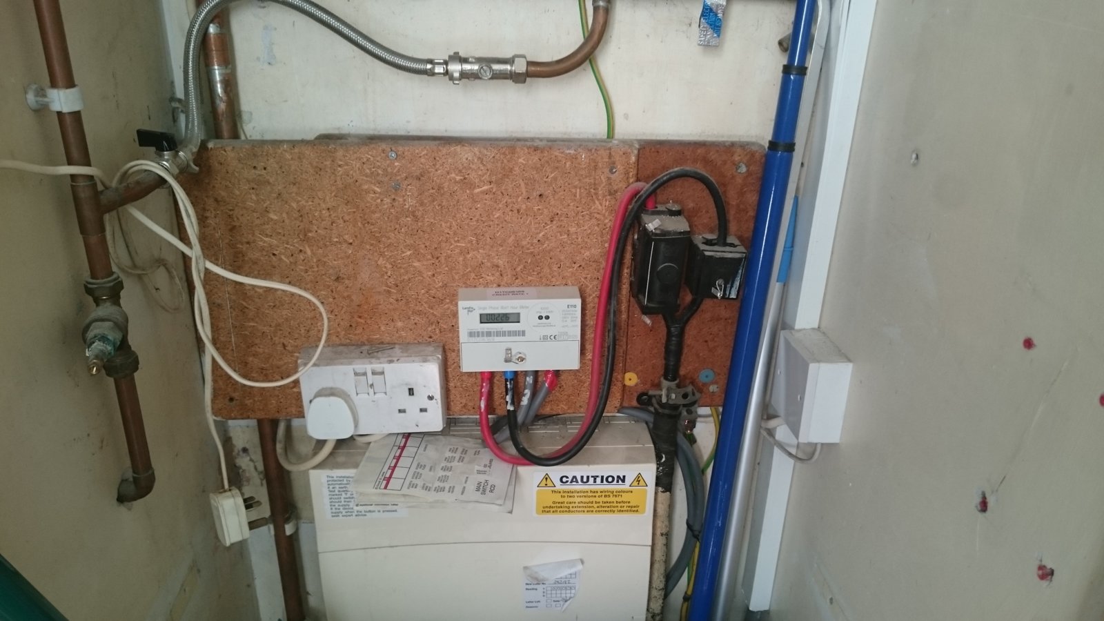

Hi Stem,

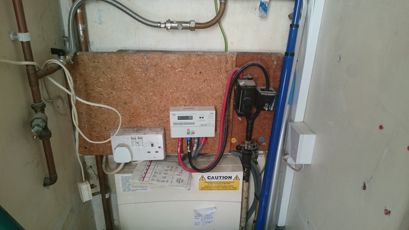

Just a quick one, you mentioned the Hive should take its power from the same supply as the boiler, is there a particular reason for this?
I ask because there is a spare power socket to the right of the one the boiler uses (as seen in the photo) and wondering if I can take it from there.
Thanks,
Marco
What you suggest would work of course, some boiler instructions stipulate that the same supply should be used for remote controls. However, it's good wiring practice, so that the same isolator turns off everything associated with the heating system, which means that the man who comes to repair your boiler and turns it off, doesn't get an electric shock because some wires coming into it are powered from elsewhere, in reality though with the way yours is wired, that wouldn't happen. Also, fixed appliances (ie not portable) should really be supplied from a fused connection unit and not via a plug and socket.
There are a couple of wiring terminals inside the Greenstar specifically for use to power remote controls, they are marked Ls (Live supply) and Ns (Neutral supply) You may find that there is a wire already in Ls, but that's OK.
