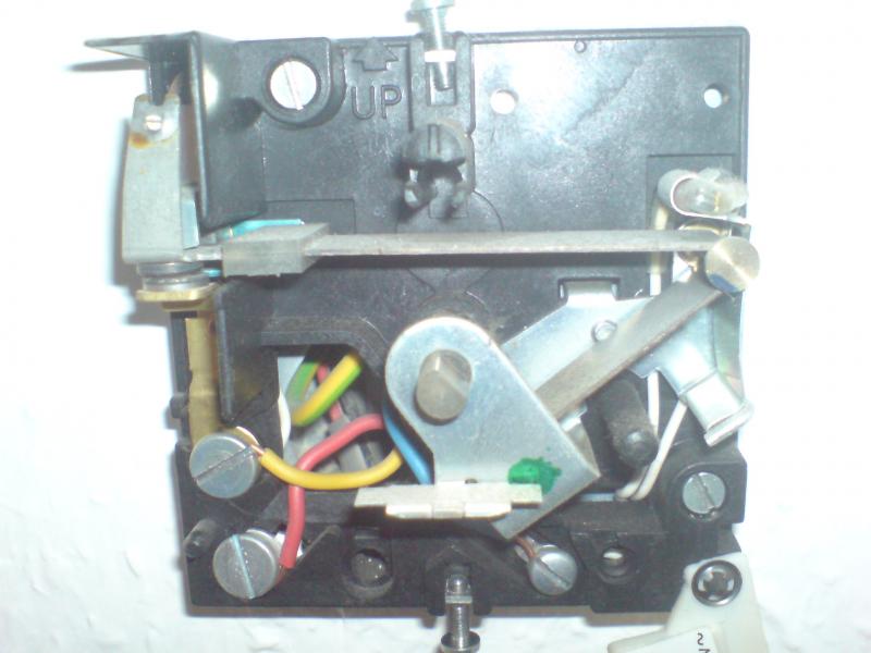

By “other two wires” I’m guessing you mean the black and red ones? Are they from the old thermostat?
Brilliant. Thanks for your help.
Is that the old thermostat that you forgot to mention you had ? post pics of that and I will tell you what you have to do
That’s the one. Can’t currently get a picture, but it’s a Satchwell TLM2253.
you have a choice, either join the two wires at the stat together in a terminal block and insulate or trace them back to the horstmann and remove completely and make a link, (best practice) but either will work
Might it be the link already at the Horstmann? The brown and red wire?
