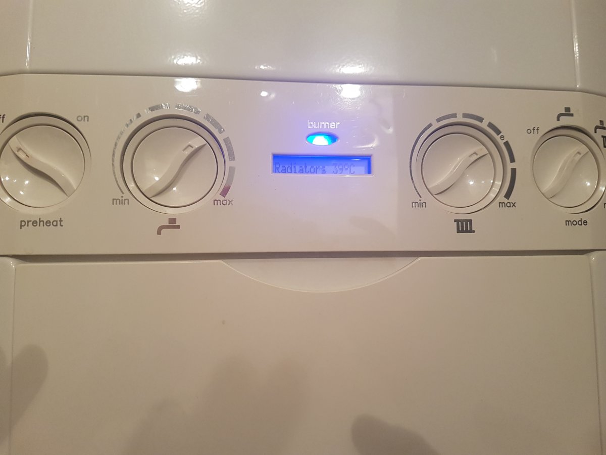

Hi Im looking to fit a hive smart thermostat system. Im looking at fitting the receiver to my boiler and ive got a few questions before I make a purchase.
First off, my boiler has a built in temperature control that tells me the temp at the radiator (see pic). Does this effect the function of the thermostat?

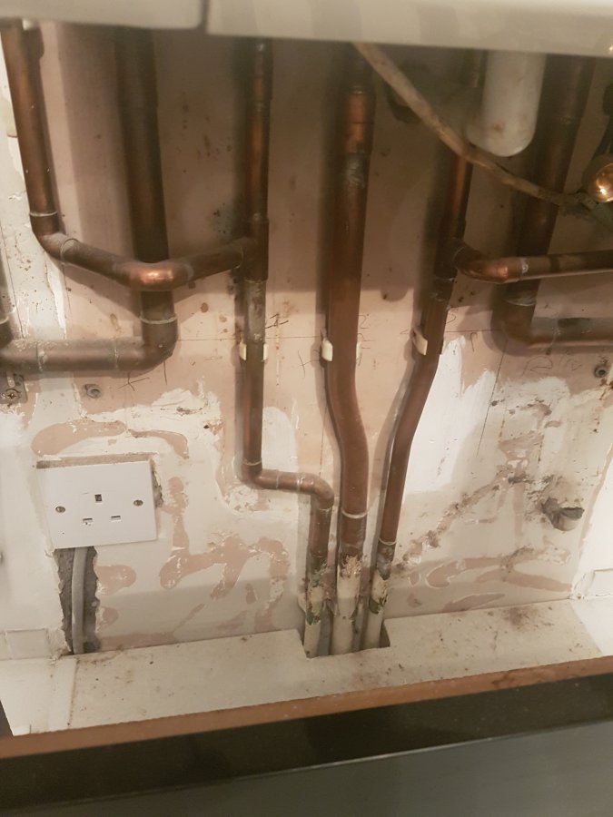

I have the boiler inside a cupboard would I be able to mount the receiver on the wall in the cupboard (see pic)?

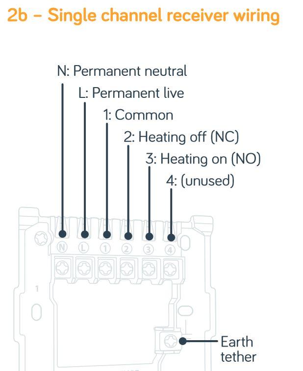

This is the reciever. Im assuming the NO and NC replace the shorting link (if so how do I tell which one is which) and im not sure about the common?

Be it a simple thermostat, or hive and nest, they in the main only monitor one room, the Evohome does monitor every room but expensive. So unless your going the whole hog with EvoHome you have two thermostatic control systems trying to control the same house. I am not saying it will not work, it does allow you to alter the time using the phone. But the single thermostat system is designed for USA hot air central heating where every room is at the same temperature. In the UK we use a wet system and the TRV (thermostatic radiator valve) allows us to have every room at a different temperature. So with the UK system using a single thermostat is always a little hit and miss.
My first house did have a hot air system, air is pumped into every room and it returns to the central heater through vents in every door. However it was very expensive to run, most people had the hot air system replaced with a water system.
It is possible using the lock shield valve and TRV to tune the hot water system to work with a single thermostat in essence you are reverting back to a pre-TRV days, the whole idea of the TRV was linked to getting the latent heat from the flue gasses, the return water needs to be quite cool so steam in the flue gas is condensed into water.
Why there is so much push to sell the hive and nest systems I don't know, as I have said they do work to an extent, but are not really designed for a hot water system. The Evohome is designed for a hot water system and it does talk to the boiler and tell the boiler when to fire up, and every room can be set to a different program so for example bedrooms only heated at night and living rooms not heated at night, but personally I think it would take a long time to pay for its self.

Com and NO replace the shorting link, setting the temperature high they do allow remote control of system on/off, but do not work very well at controlling temperature as only in one room, so used as a frost stat OK and putting heating on remote work OK, but the setting of the lock shield valve becomes very important.

If the comm and NO replace the shorting link does the NC go unused?

And yes NC is not used for heating that is only used with air conditioning units.
