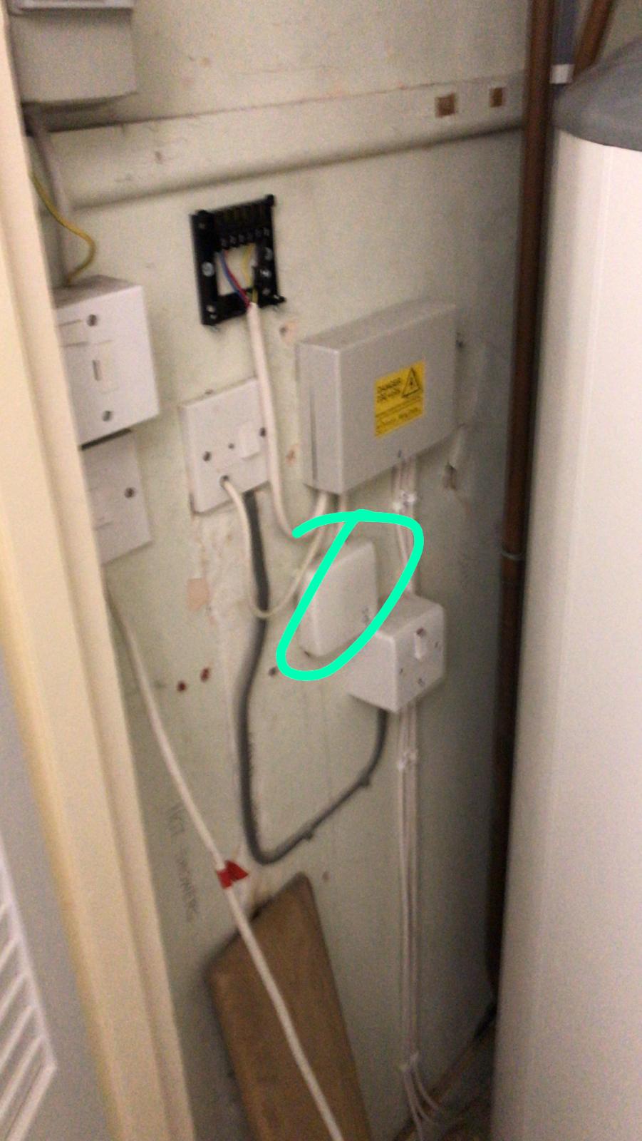

I’m looking to replace the old Honeywell thermostat for the Hive.
I’ve got a hot water tank as well as the boiler for CH.
There seems to be two receivers in the airing cupboard. One to control the heating and one for the hot water and just need some advice about joining the two together.

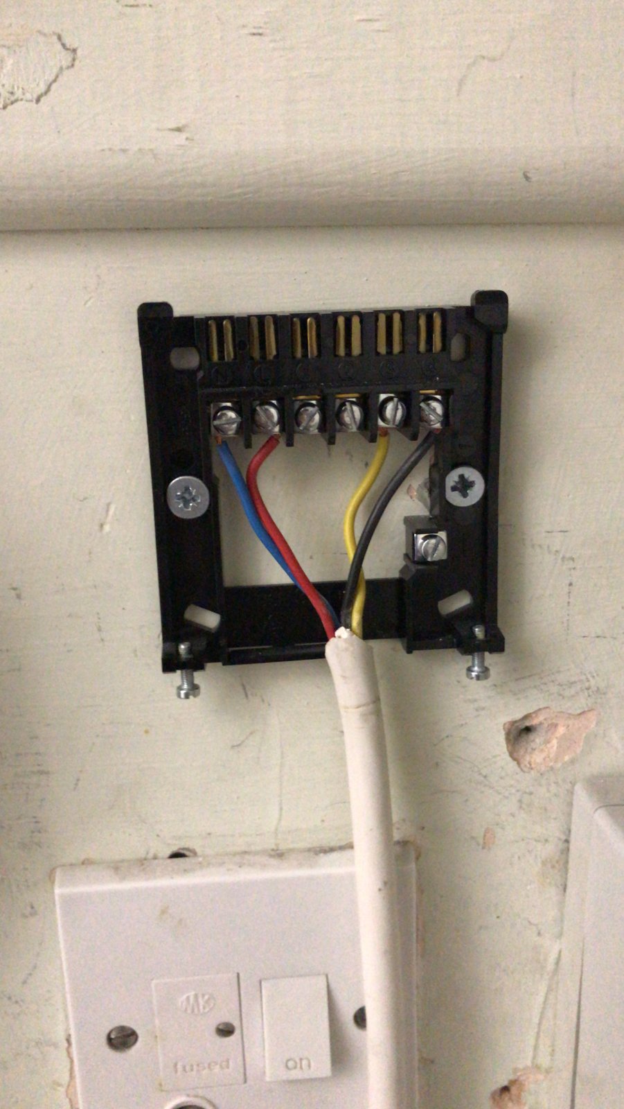

I’ve included the wiring for the old Drayton in a picture below. I’ve taken this off and attached the dual receivers for the hive, the hot water works fine but the heating doesn’t fire up. This leads me to think I have a second receiver for the heating command. It’s a Honeywell DBR91 - is it as simple as wiring the A & B function from the DRB91 to the heating on/off command on the hive? What would I do with the N & L wires?

Is the old thermostat turned to max? in the main Hive replaces both the programmer and the thermostat and goes where the programmer was, in the wiring centre one has to remove the old thermostat, however if old thermostat put to max in the main it will work anyway.

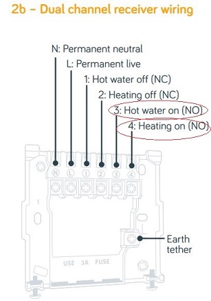

You say that you originally have two receivers, one for Heating and one for the Hot Water. If you want the Hive to control the heating and the hot water, then of course they must both be connected to the Hive receiver.
You have the dual channel version of the Hive, which is what you need to control both.
Ideally the original two receivers and their wiring would be removed and the new Hive receiver wired directly into the junction box. That will solve the problem of the two N & L's

I assume that the two receivers are operating motorised valves, is that correct? I ask because the existing receivers are wired to provide voltage free switching and the Hive Dual Channel can only provide 230V switching.

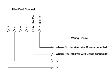

If the two existing Honeywell receivers are wired such that the wire from 'B' of each goes to the live of their respective motorised valve (this is common way of connecting it) Then once the Honeywell receivers were removed, the Hive is connected thus:
