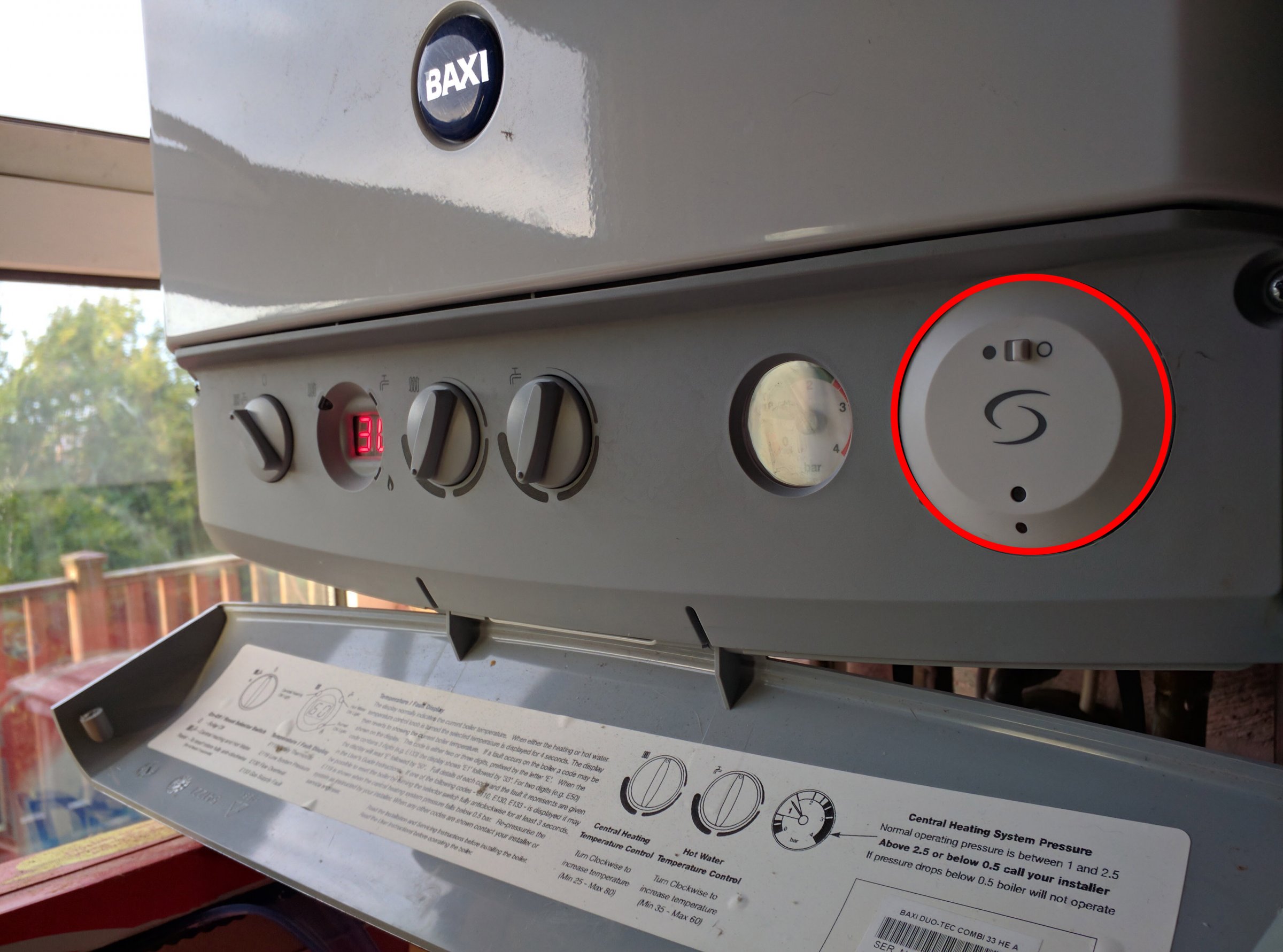

The problem is that when I switched the power back on it says to test your wiring push the 'central heating' button on the receiver and the green light should come on (it does) and the boiler should fire up but unfortunately it doesn't. The system it seems is still being controlled by the Salus RF boiler control and the wireless thermostat.
My question is should I remove the RF boiler controller? And if so how?
The item circled red in the image is the item I am referring to as the RF boiler controller
Thanks in advance for any help you can give.
Usually the integral boiler control has to be set to permanently 'on' and if it is wired in properly, the Hive will then take control. Otherwise the Salus will need to be removed and the boiler wiring changed.

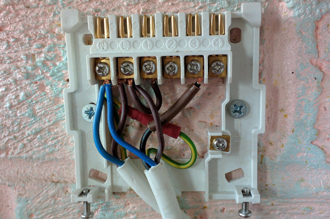

This is how I have my Hive control unit wired up

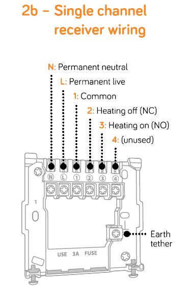

And this is the wiring diagram for the Hive
If you or anybody else that is watching could confirm the wiring looks correct I would be obliged.
That bit looks OK as far as I can see, assuming the other ends of the wires go where they should. Well done with the brown sleeve on the black wire, many ahem ...professionals, don't do that. What is the other end of it connected to?

I think we may be getting somewhere as to why it isn't working. The cable with the black wire in it goes to another junction box which is the photo below BUT the black wire has been cut at the junction box end so doesn't connect to anything :(

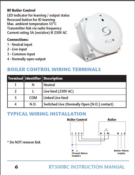

And this is the Salus wiring diagram
OK, so I believe that the wires from the Salus terminals 3 & 4 will go to terminals 1 & 2 at the terminal box inside the hinged cover of your boiler. Is this correct?

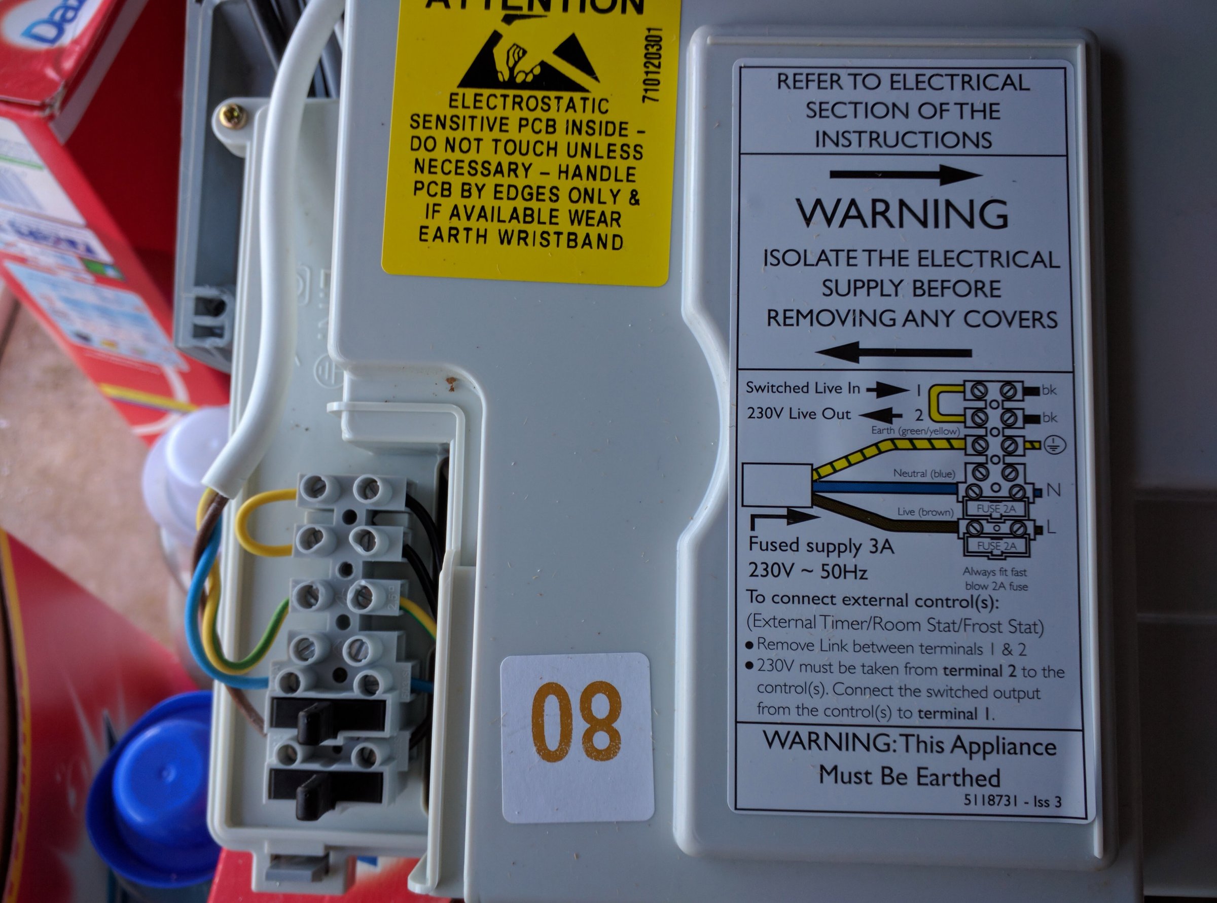

OK I've dropped the fold down panel on the boiler and this is what the cable goes into
It's the white cable on the left that is coming from the junction box.
The white cable is the mains supply. I can't see any wiring for the Salus there.
The terminals I was referring to [1 & 2] are the ones at the top with the yellow link in.
Anyway, the cable from the Hive terminal 3 'Heating on' (the black one with the brown sleeve that doesn't go anywhere) needs to go to terminal 1 of the boiler which is labelled 'switched live in' and the yellow link removed. Then the Hive should then work, but only when the Salus is set permanently 'on' to remove the Salus from the boiler we need to know where it is wired to.

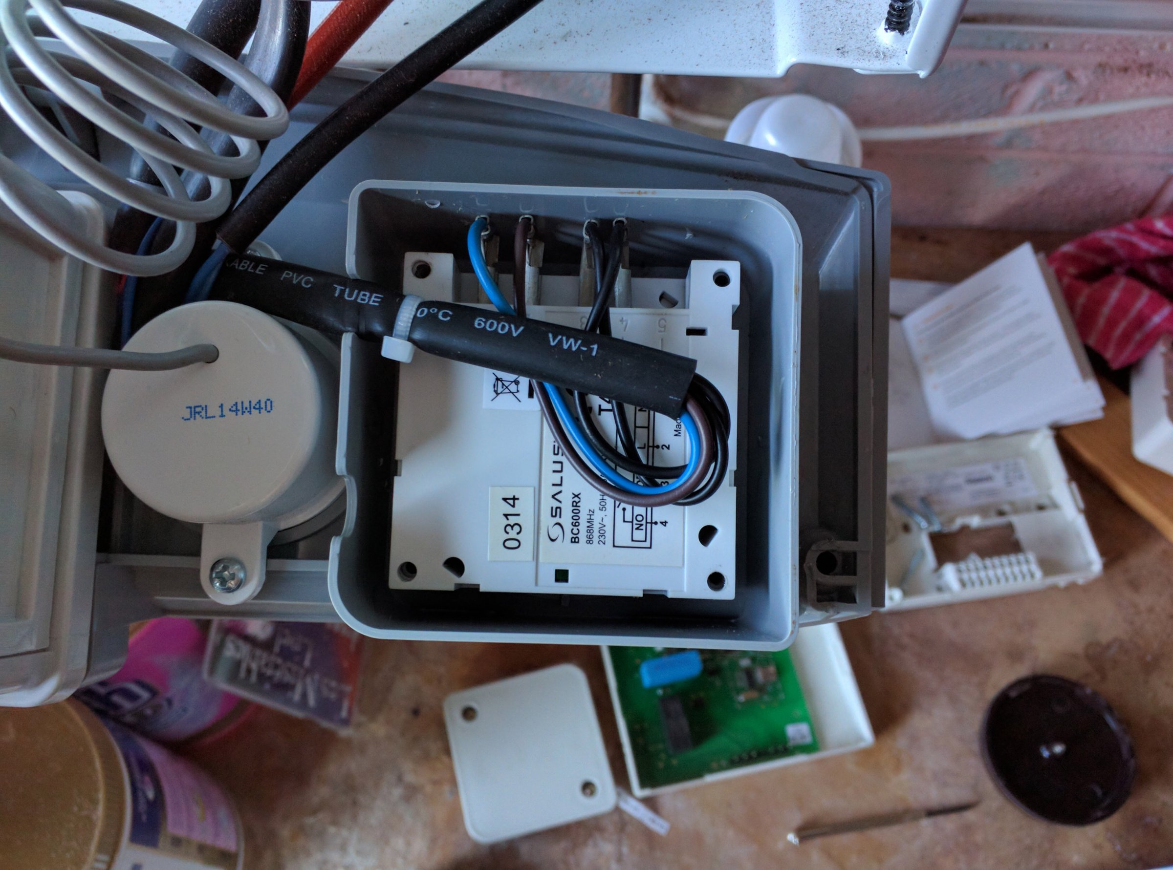

The Salus unit seems to be plugged into the faceplate of the boiler and I have removed the cover on the back to reveal this
Still not sure if that is what want you need to see.
But if I get a length of 4 core cable and run a black wire from the Hive unit to the yellow loop wire as you suggested I can live with just leaving the Salus switched to permanently on. Is there a reason the boiler fitter didn't continue the black wire through?

The photo is very helpful. To remove the Salus from the control of the boiler, simply remove the two black wires from terminals 3 and 4 of the Salus and join them together using a screw terminal connector. You can leave the Neutral and Live connected to terminals 1 & 2 if they can't be easily be insulated and / or removed.
