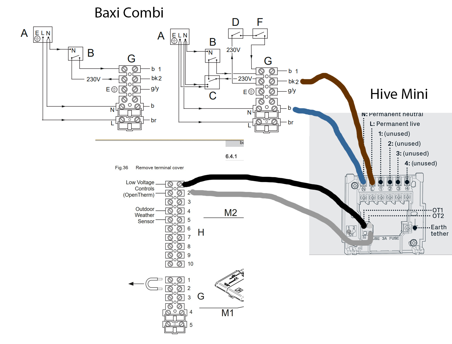

Hi
Would the below diagram work for connecting a Hive Mini to a Baxi Combi boiler using Opentherm. I've connected a hive to my old Baxi boiler however, my new Baxi boiler has Opentherm.
Any help greatly appreciated, thanks.
Check if Baxi OT is compatible with the Hive OT otherwise it won’t work. I’d also take the L to L rather than the thermostat connection
A lot of OT doesnt work with baxi , it needs baxi`s own controls
But no you dont take the live and neutral for the hive from the boiler terminal strip you take it before the boiler
