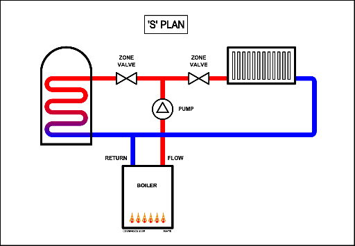

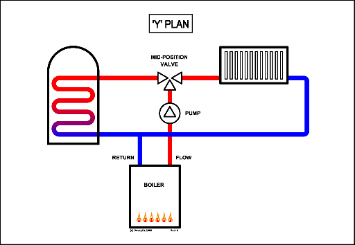

You say do it properly.. I would love to.. considering what I have at the min with I think the hot water tank in line with the heating system, fitting a duel channel Hive isnt going to help me with the existing plumbing. How big a job am I looking at? Would appreciate the advice...
You could convert it to a fully pumped system that would allow totally independent thermostatic control of both the heating and hot water. Hot water heating would be quicker, and when there was no demand for heating or hot water, the boiler would shut down completely and save fuel / money. (This set up is presently a requirement of the building regulations and would need to be implemented should you need a replacement boiler anyway). At the moment whenever the clock is 'on' the boiler will be running to keep itself warm even if your house and hot water are already warm enough.
This process would involve adding motorised valve/s and converting it to a what is commonly known as a Y Plan or S Plan.
If you don't want to make plumbing modifications, then a dual channel Hive fitted to the system you have would allow you to have the hot water 'on' when the heating wasn't, (but not vice versa) and wouldn't provide thermostatic control of the hot water, or shut the boiler down when the hot water and central heating were up to temperature. So would be a halfway house.

Yes I understand your diagrams but I'll have to get someone in to figure out what that means in real terms (as in where). Its just valves fitted at different positions in the existing system and controlled opening and closing but using the existing plumbing? I didnt know I could do that. As I said its very much the house that Jack built, its old and everything I touch seems to fall apart lol... Thank you very much for taking the time to explain, I've learnt something and I really do appreciate it..
