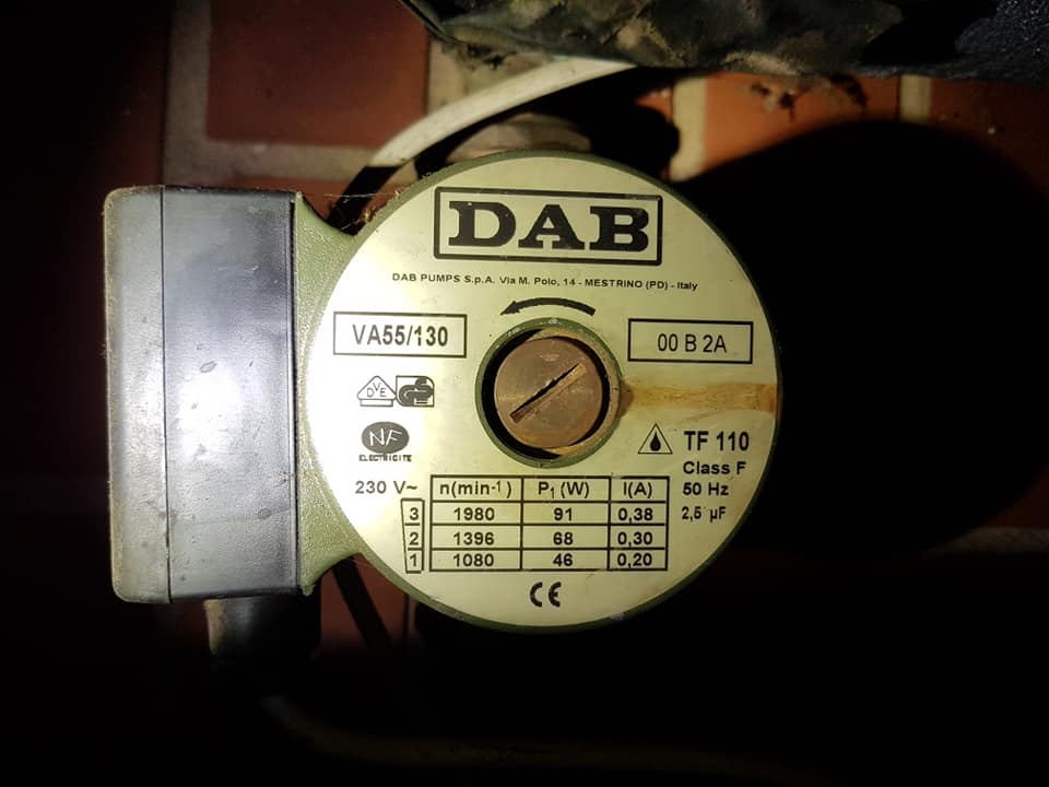

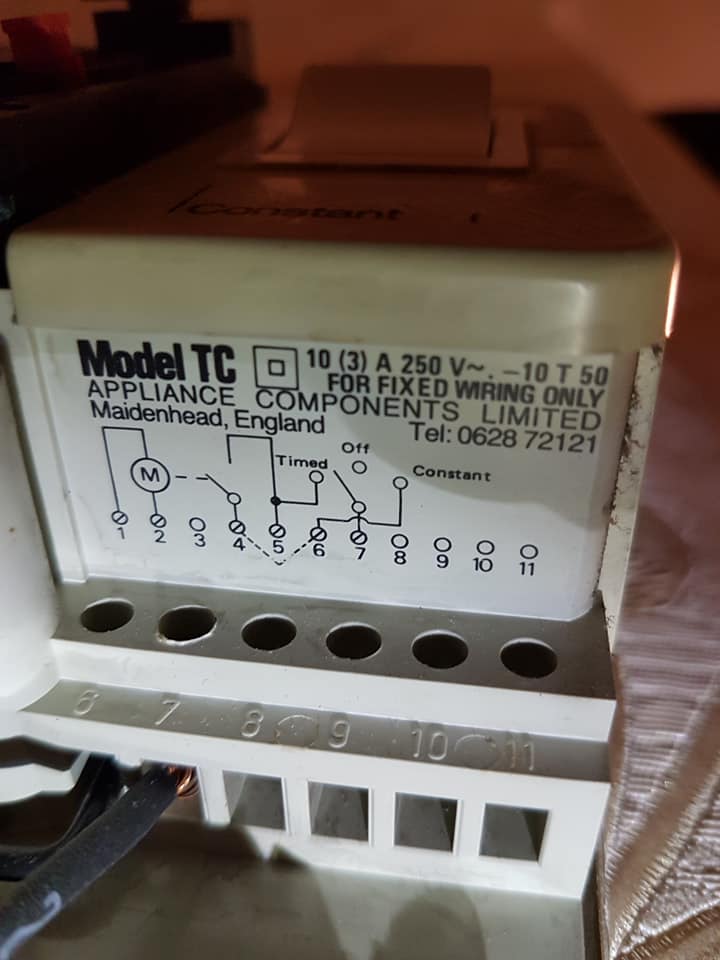

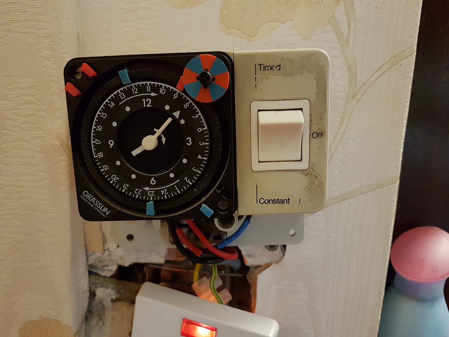

Can anyone please offer advice on a Hive single channel install..?

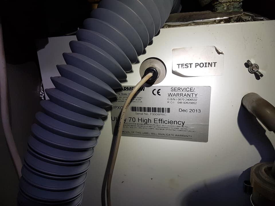

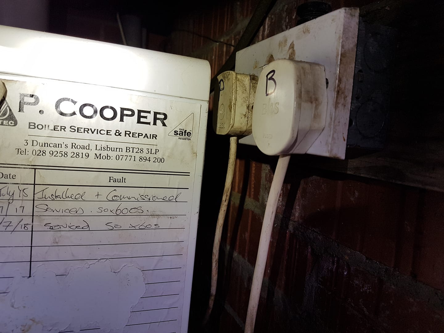

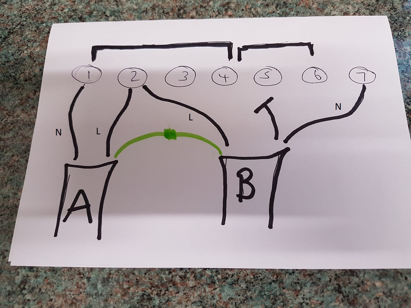

I have a Warmflow Utility 70 HE connected to a mechanical timer from the stone age, I dont know what it is. (pics attached) Power was hardwired to the timer from a non working switched spur. Outside in the boiler house the boiler and pump are plugged into a double socket and from the sockets 3 wires come in to the timer (2 black numbered 1&2 and an earth) there is also a 3rd black which has been either cut or broken but the timer and the heating work correctly so I assume it was cut. Its a simple on/off set up it heats the house and water at the same time.
I've fixed the switched spur and connected a single channel Hive receiver in every configuration I can think of but get nothing at the boiler. Hive lights up, connects with hub and receiver and shows green light when I use the manual heating on button.. Spent last night without heat so reconnected the old timer this morning works just fine, I havnt damaged anything but I dont know how to move forward..
I have connected the N&L from the spur.. Then tried the 2 wires from the boiler sockets to 2/3 2/4 and tried a jumper from L to 1 on the Hive..
These are pics of the timer I am removing along with a diagram of how its presently wired..
I'd be grateful for any help..

What is all that plus and minus?Those don’t exist with AC. I suggest you are out of your depth and call in an expert.
Well thats simply what I was shown as positive and negative a long time ago and its stuck in my head.. N = - L = + I should have labeled N&L my bad..
Did you purchase the dual channel or single channel Hive?
So then, why are you using 4 which clearly states it’s unused?
L - L
N - N
Common from older one to common on Hive (1)
Switched from older one to switched on Hive (NO/heating on)

I am using 2 and 3 . Again my bad I've become so frustrated with this my heads not straight when I posted.. which is why i installed the old timer again... I know 4 isnt used, I'll amend the post.. (thank you)
I've tried 1 and 3 & 1 and 2 I've even bridged L & 1 as I saw this worked for someone but all with the same result. I'm not a professional.. but as far as I can see (and please tell me if I am wrong) this is simply a switch (if you take the thermostat out of the equation)?
Im worried about blowing the circuit board so I plugged in a socket tester outside where the boiler is connected just to see whats happening.. and with connections to 1/3 or 1/2 there is no power.. unless I bridge L with 1.. But either way no boiler action.. at best I get a L&E reversal signal which

You've not mentioned a room thermostat, only a timer. So at the moment the timer controls the boiler and pump. When the timer is 'on' the pump and boiler run so provide heating and hot water.
When you have the Hive installed it operates differently it's controlled by the temperature of the room it's located in, so when the room in which it's located is warm enough it will turn off the boiler and pump. So you won't get any hot water when the house is warm.
