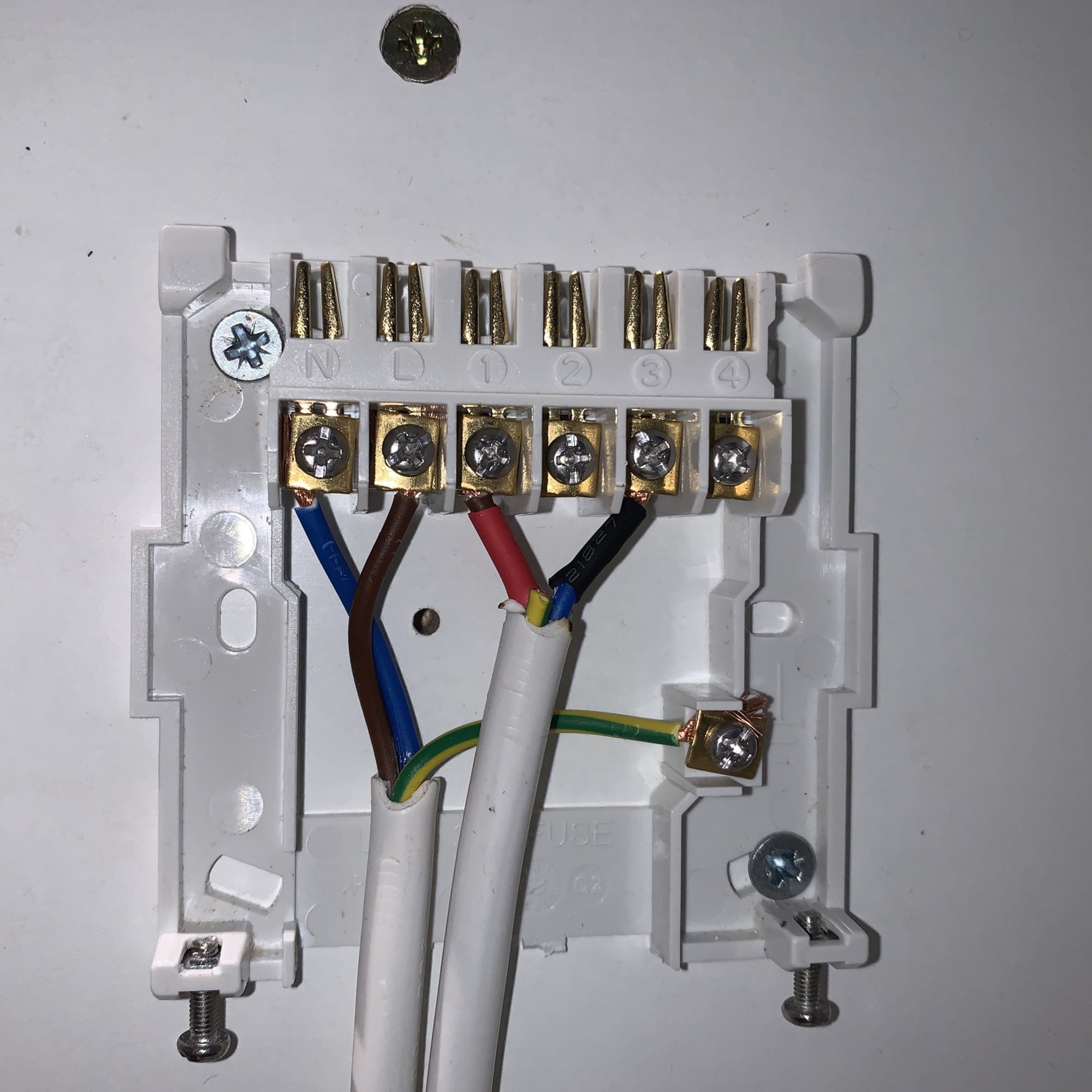

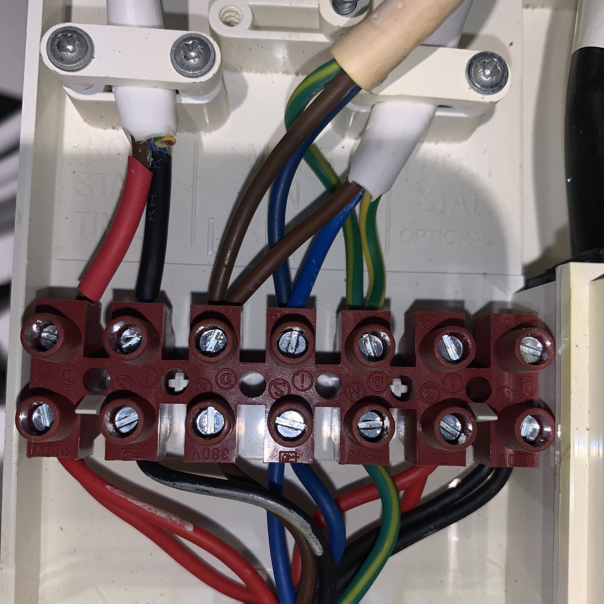

Hi,
I followed the advice of a number of posts on this forum to install my Hive thermostat on my Ideal Logic+ Combi boiler. I think I've wired everything correctly but when I trigger the heating I hear a relay click in the Hive Receiver but the boiler doesn't switch on.
The wiring is currently:
  • Boiler Earth --> Reciever Earth
  • Boiler Neutral --> Receiver Neutral
  • Boiler Live --> Receiver Live
  • Switch 1 (black) --> Receiver 3
  • Switch 2 (red) --> Receiver 1
I'm hoping that I've missed something obvious but I'm wondering if it's something to do with the wireless timer (Ideal RT1) that was installed in the boiler before I started. I disconnected the two plugs, removed the unit and replaced it with a blanking plate. Is there something else I missed?

The wires you disconnected from the RT1 would have been live and neutral, and 2 switch wires. The 2 switch wires need joining together with a connector.

I've got it working now thanks to Johnmdc advice. I figured the easiest thing was just to put the RT1 back in and set it to constant on, and take the batteries out of its wireless thermostat which has made it all behave as expected.
