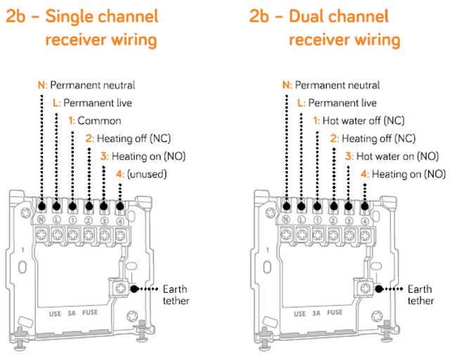

The Hive (*receiver) uses a standard backplate - used for years on many British Gas installations.
The Hive has been designed to be a direct swap for many existing programmers - conversely, this means that many basic thermostats/programmers can be fitted straight onto the backplate, with little or no wiring changes.
...It could be one of the simplest of DIY jobs to accomplish, without any need for an electrician!
Do you know if the Hive is single channel (for a combi), or dual channel (controlling heating and hot water)?
...but as above, it does depend if the Hive *receiver is in the right place.

Hive tends to replace both the programmer and the thermostat. As said likely to replace Hive with a programmer will be easy. Just slack off two screws and unplug, and plug in new, and re-tighten the two screws.
However the back plate comes with three wiring configurations that I know of, single channel, twin channel and three channel, although latter is mainly Drayton Wiser Hive does not as far as I know do a three channel version.

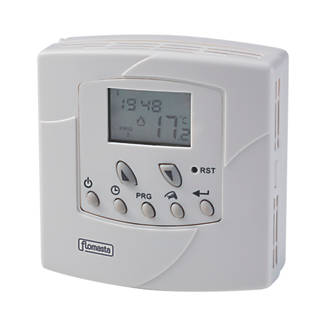

I would not really call any thermostat standard, we have the mechanical on/off with anti hysteresis compensation, Honeywell-thermostat.jpg and for very little extra a programmable one ae235.jpgbattery powered. But neither fit on the back plate, I like the idea of simply turning a dial but this Hot water boost.jpg is hardly standard and more complex to the Hive it replaces.

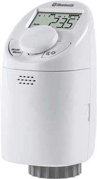

Likely looking at minimum charge to fit it, but one wonders why? The thermostats around my house are mainly programmable EQ-3 Bluetooth Smart Radiator Thermostat.jpgand I can see when fitting them how a wall thermostat has very little to do, and could well be replaced with a programmer (timer) or very simple thermostat.

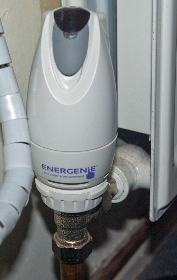

But main reason to down grade a thermostat is to take it with you when moving house, I in fact swapped most of mine before selling my mothers house IMGP8035.jpg mainly as buyers did not want them, but it was simply a case of unscrew one and screw in replacement, and £6 for mechanical and £50 for Hive with this house having 14 of them I can see the point.

One of the hive units I removed had a completely differrent arrangement and I hate to think how many other versions I've handled for programmers (time switches) I've dealt with over the years. Additionally the NC / NO layout wasn't always standard either; I've been out a fair number of times when a replacement programmer didn't work and needed to be rewired. I wouldn't swear to it but I believe I've encountered; com/NO + com/NO, NO/NC + com/NO, and NO + com/NO/NC formats.

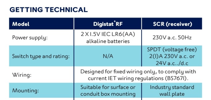

Any particular "Industry standard backplate" in particular.
Well, Drayton for one call it an 'Industry Standard wall plate', throughout their catalogue...
And you may want to argue with this statement! ;)
No, they are not all the same, but generally, it is a pretty straightforward job to swap the wires over on the wall plate, hence:
And as said by @CBW , the Wiser kit for example (along with other Drayton's), is a direct drop in replacement for the Hive, you just have to make sure that you buy the version with the correct number of channels.
