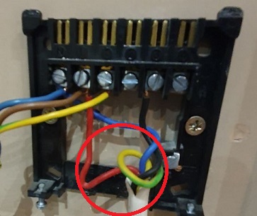

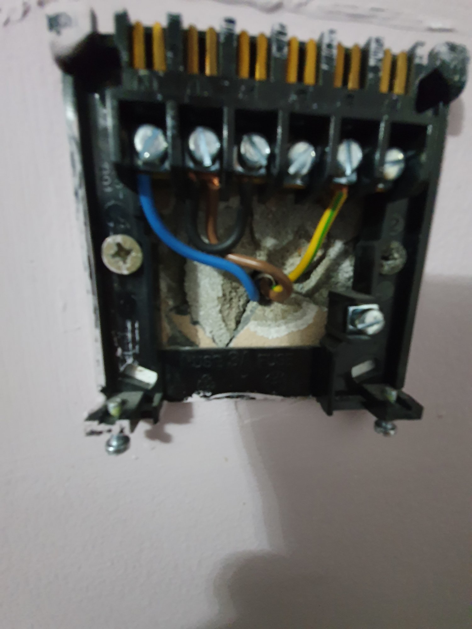

Good evening,
I was hoping I could get some assistance with the Hive terminations to replace old. Any help is greatly appreciated.
My current Heating system is:
Glow Worm Flexicom 30 CX Combi boiler
Drayton SCR
Drayton LP111
There is main flex from the boiler to the SCR.
Pin 1 Blue N
Pin 2 Red L
Pin 5 Black
Earth to Earth
A separate flex runs from the SCR to the LP111
Pin 1 Blue N
Pin 2 Brown L
Pin 3 An Earth wire which is not an Earth, just a botch from the original installer
SCR Plate
LP111 Wiring from SCR
Flex from SCR
Pin 1 Blue N
Pin 2 Brown L
Pin 3 Black Loop to L
Pin 5 That Earth Wire from Pin 3 on SCR
LP111 Plate
Please can someone point in my the right direction on which what I am doing with the Pin 3 on the SCR which goes to Pin 5 LP111.
Wire Hive from boiler flex with:
Pin 1 Blue N
Pin 2 Red L
Pin 3 Loop to Pin 2
Leaves the black wire for Heat on?
Could I just leave the SCR wiring as is and remove the LP111 flex.
